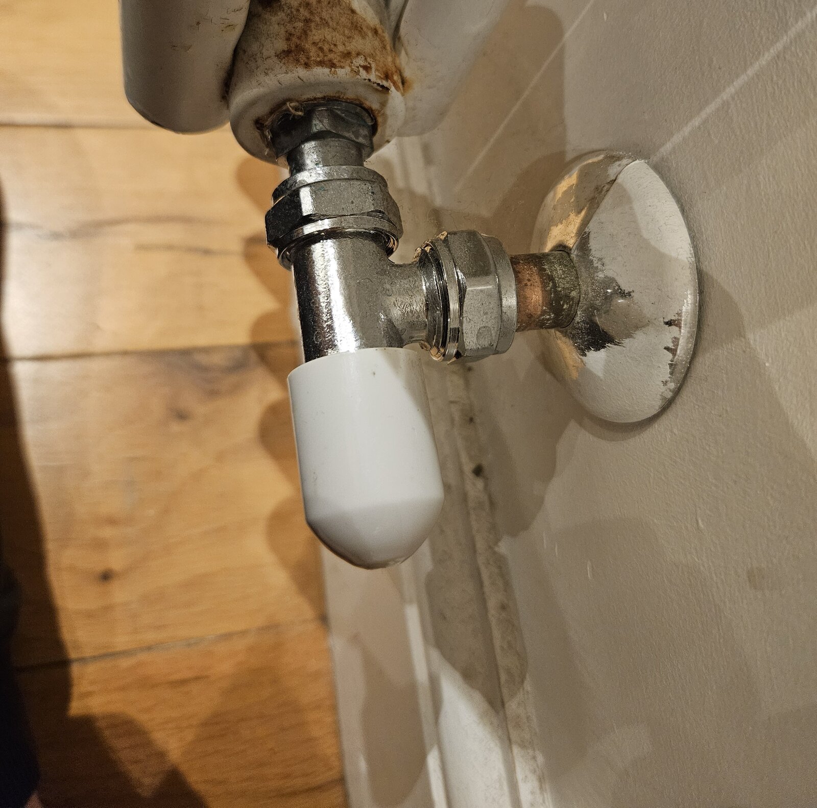

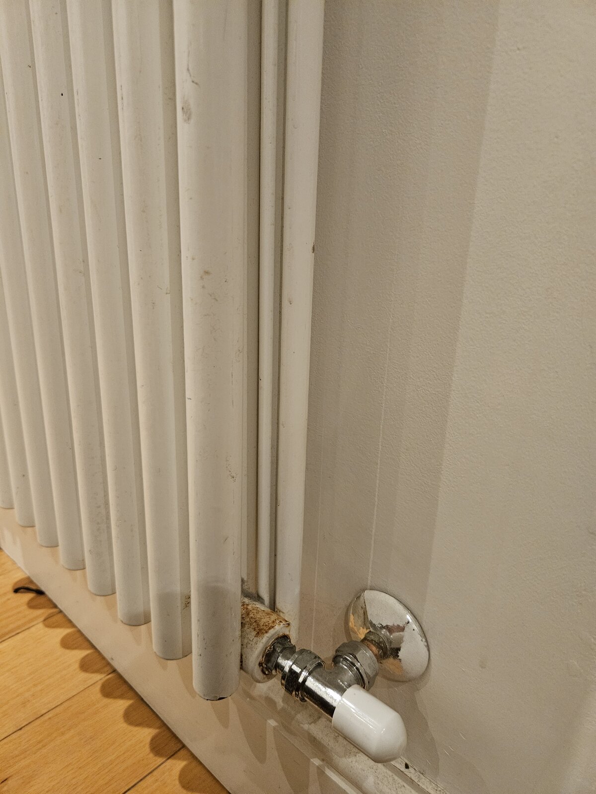

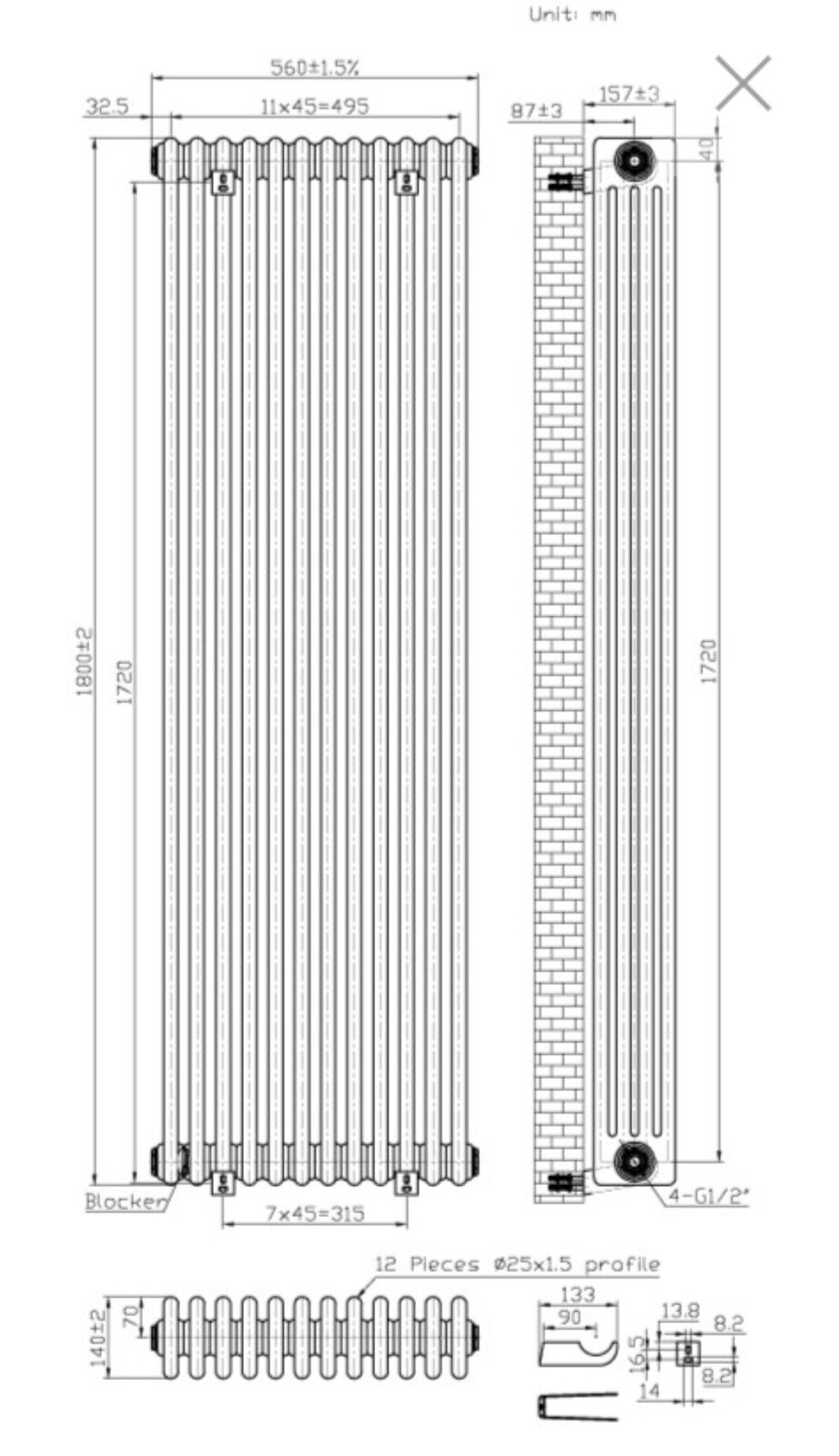

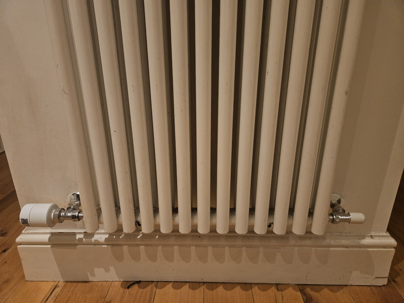

Hi All

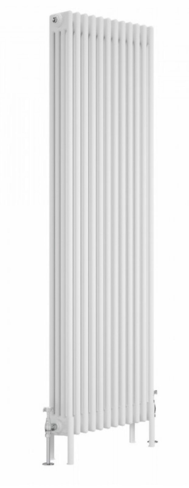

I'm looking to swap my two column vertical radiator for a 4 column one, as it's the only one to cover both the kitchen and living room area.
The one now has a width if around 550mm (including the valve areas) and new one is 560mm wide, so should swap over easily enough size wise, hopefully?

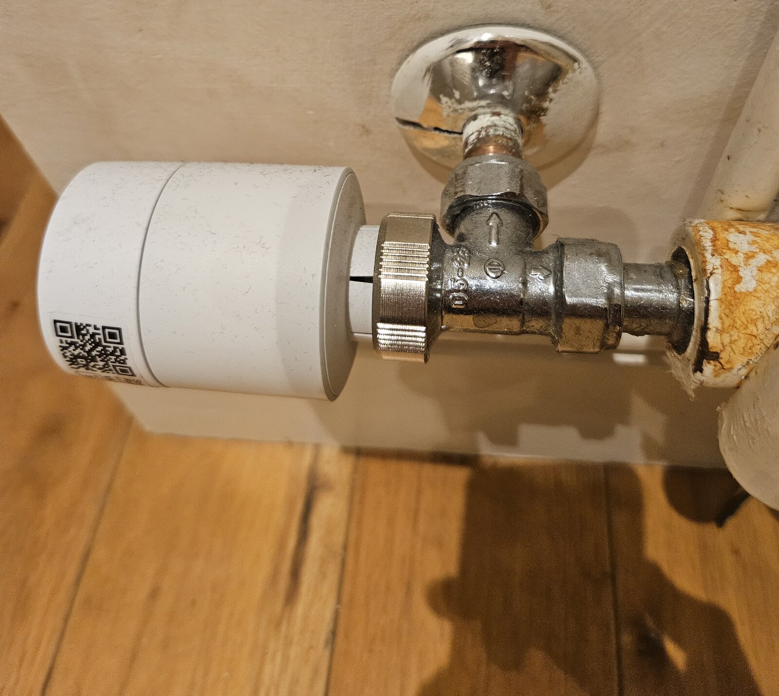

The only issue is the depth. The copper pipe comes out the wall to roughly the right amount for a 2 column radiator, not a 4.
If I needed to add another 20mm or so to the length of the pipe coming out the wall, is there any sort of extension I could add to the TRV to do this?
I have added some pictures of the current TRV's and the new radiator I am looking to purchase.
Also, in terms of whether the boiler can handle it, is there a simple enough way to work this out? I use TRV's and never have all the radiators on the house on at once. So if it could handle them all at once technically, I'm hoping it shouldn't be an issue if I had this one and one other upstairs, for example.
Thanks for any advice!

Ah, I was planning on simply replacing the 2 column for a 4 column one. I would only replace this one radiator.
It's the only radiator in the room, so I was thinking the best thing to do was do a like for like replacement (reducing cost of not needing pipes moving), but doubling the amount of columns.I don't know if I could get a convector radiator anywhere near as big as the 4 column vertical one!
Though, I have seen large vertical convector type radiators, perhaps these would be a better choice then?
This is the one I was looking at:
There is this one for convector:
The heat loss calculator said I need somewhere between 11000-13000 BTU. The column one is showing at 11330, whilst the convector is showing at 8107. But are you saying this is not quite true in reality in terms of how it'll heat the room?

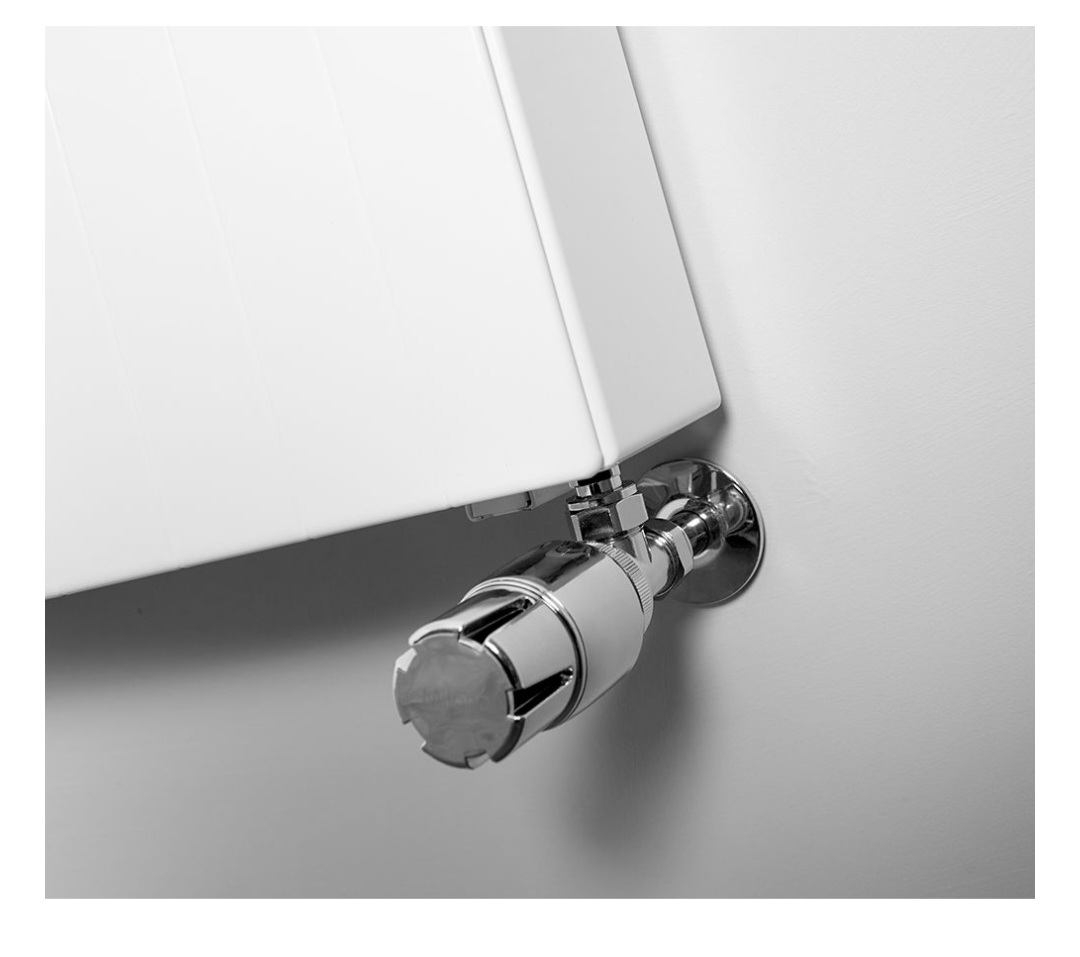

Going to the pipes... mine are 620mm apart, but with angled TRV. The K2 whole unit is 600mm and the pipes enter the bottom, rather than sides like mine currently. They are set in a little, by 28mm either side. Given the difference, how would I go about getting my TRV to fit this? I've attached some pictures.

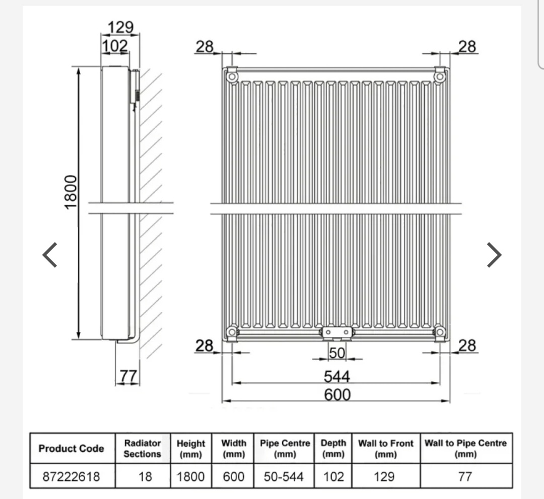

So I think double checking, the 600mm convector vertical radiator should absolutely do the job heat wise (3113W). This is pretty much spot on where it needs to be.
However, the tricky bit now is the pipes... as mentioned, the pipes themselves are 620mm apart. The K2 unit is 600mm wide and the valves a bit closer in (28mm from each side). I'm wondering if there's any sort of extender or angled piece I could use, or something similar, to make up that difference and to get it to fit? I'm literally guessing, but maybe something like the picture I've shown, alongside an angled TRV?

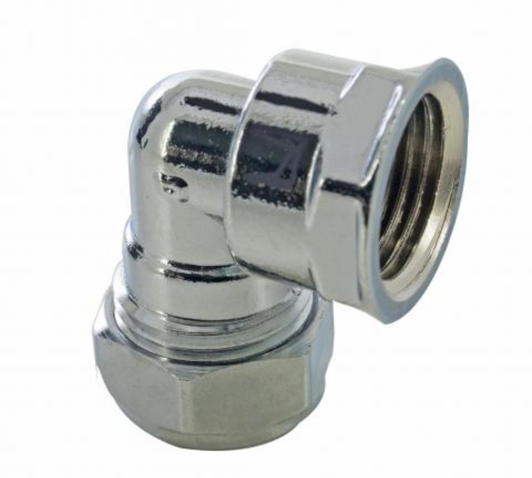

This on to the copper pipe out the wall.
Then the threaded end of this into the female socket of the above, then cut the length so it meets up with the socket on the TRV and lockshield. Same both sides. TRV and lockshield will point at each other, underneath the rad which will need to be hung higher up.
Don't know if this will give you the projection needed from the wall though? Diagram says 77mm!
Ah perfect, thanks for this. Yeah, 77mm projection from the wall. So in terms of this, the female elbow on the copper pipe, inserted into the valve extension and then into the angled TRV / lockshield?
So that should give me the ability to get the correct angle. However, is there anything I could do to bring it further out, to ensure it reaches the 77mm requirement?
