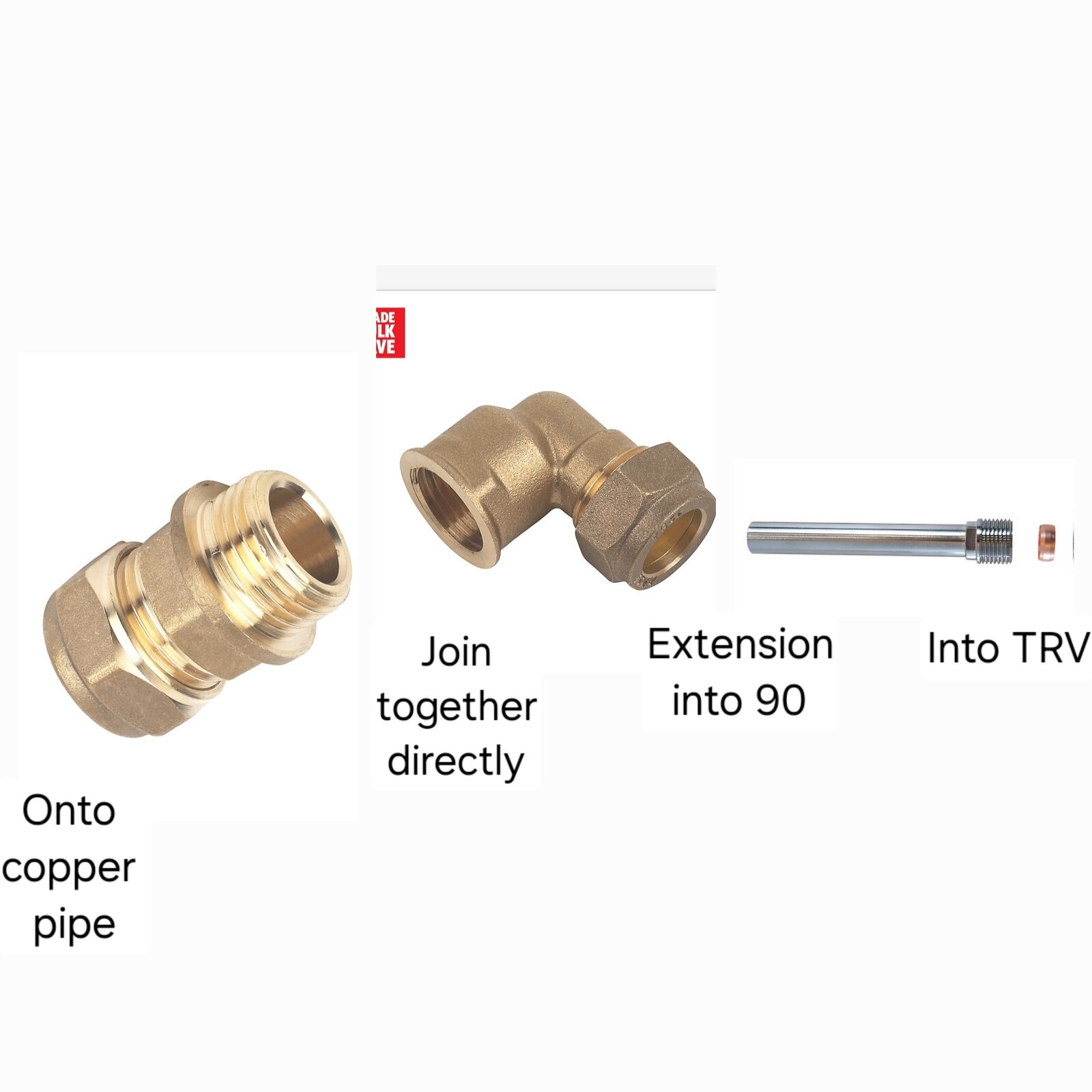

Okay thanks. I have drawn a diagram and put the connection ends together how I'm thinking you're saying they should go - is this right?
Thanks!

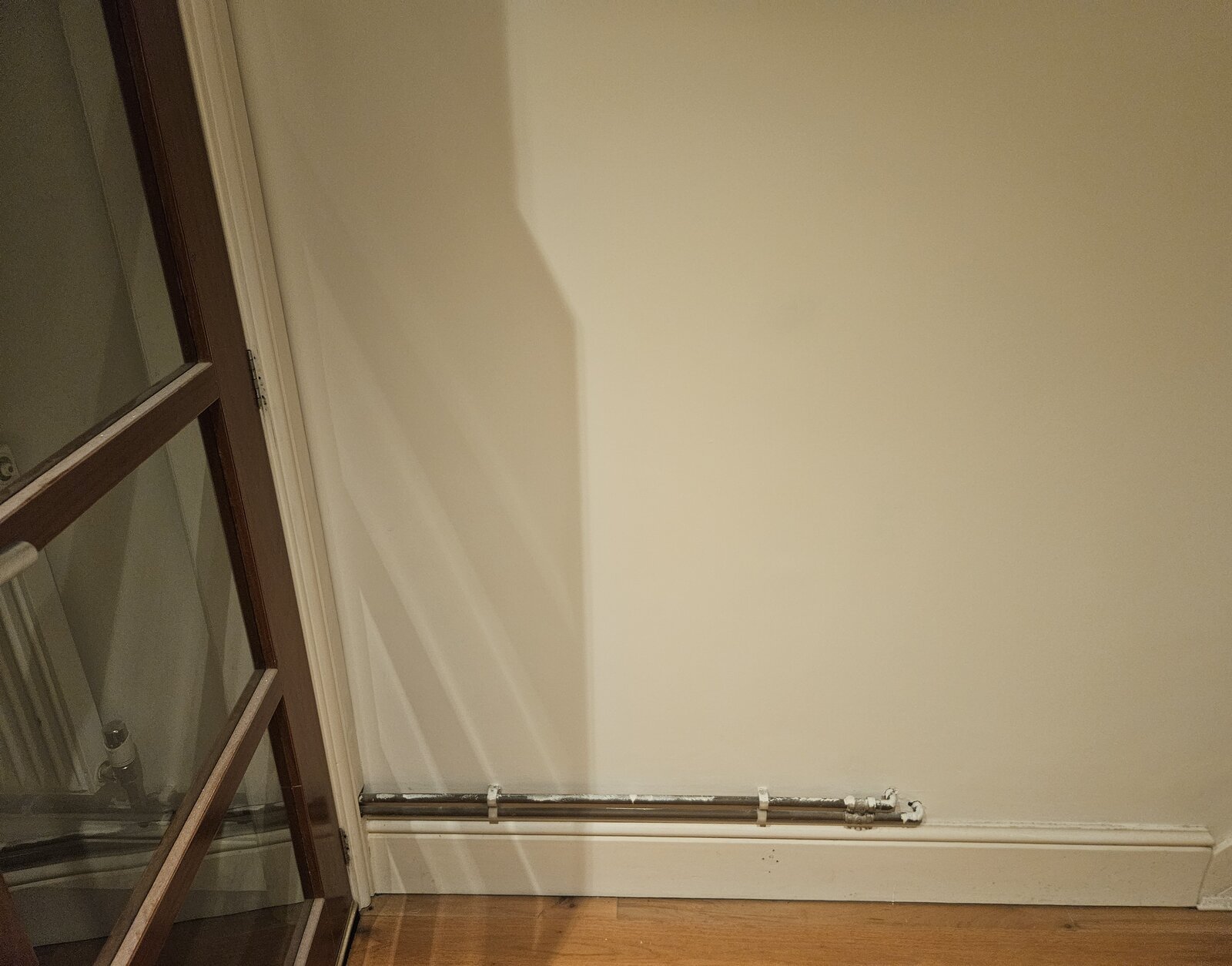

This is the one I was talking about - 1800 X 600 double. As above, the valves are on the bottom and don't line up with the current copper pipes, so I'm looking for a solution to get some angles to make it fit!
Thanks!
Nope.
Like this...
But with the irons in chrome not brass.

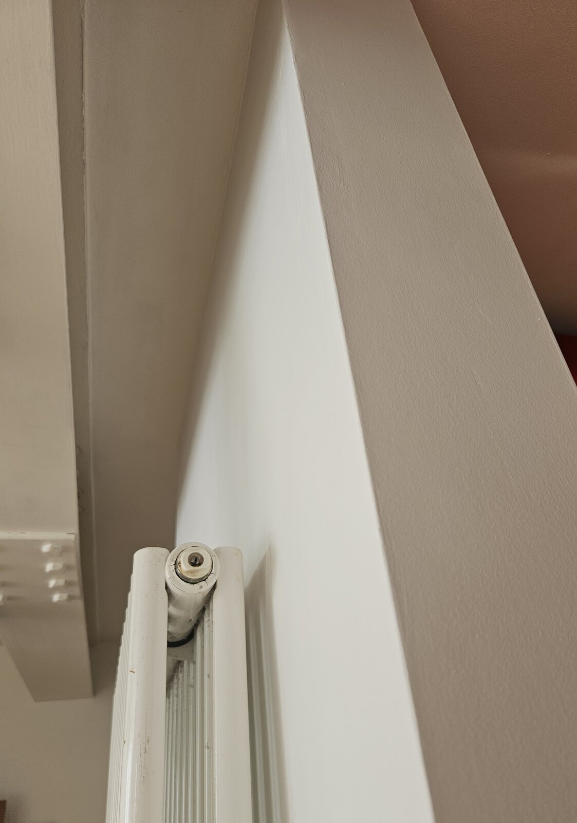

Also, above where the radiator sits there's a beam. I know you spoke about how convector radiators work - this may be a stupid question, but if the heat is travelling up and out the radiator, would this beam disrupt it's travel out into the rest of the room? I've attached a picture.

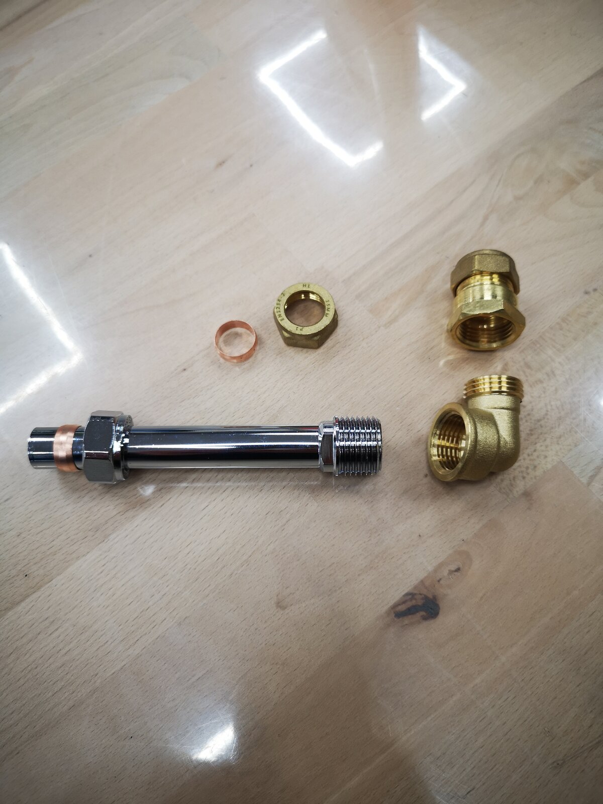

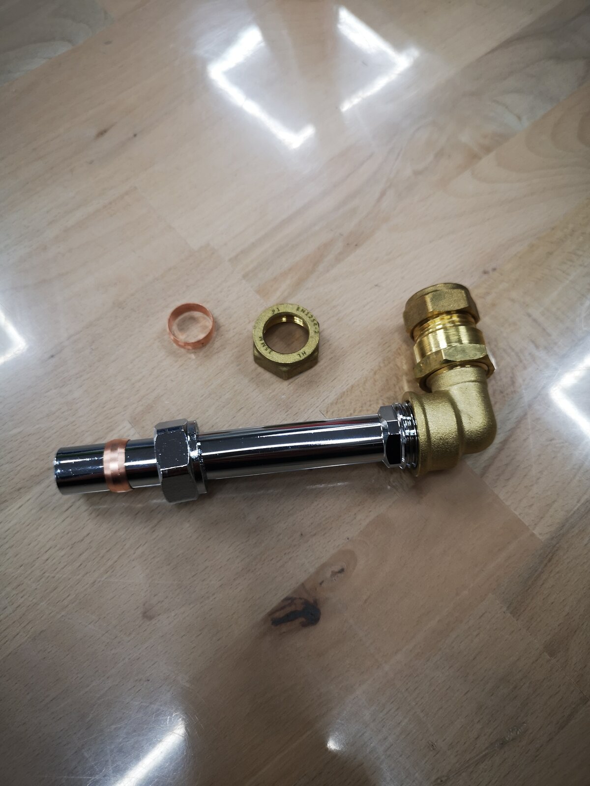

Nope.
Like this...
View attachment 360225View attachment 360226
Amazing, thanks for doing this! As a failsafe before I consider now ordering this radiator... if the two couplers together make it come out too far, is there anything to be done here?
Also, does the straight coupler on the pipe have to go all the way in, or is there some flexibility on this?
Thanks!
Ahh okay, fair enough, thanks for the explanation. In any sense, I'm guessing that this radiator would still be better at heating the room than the four column one I initially put?
Can't really say given we're not on site and don't really know the layout of the room. I would certainly think it would be more effective at getting it's heat into the room yes but given it's under the heat loss requirement for the room it would be hard to be sure as to how much warmer it would get, trying to compare one to the other, if that makes sense.
Thanks!
Cut the copper out the wall accordingly!

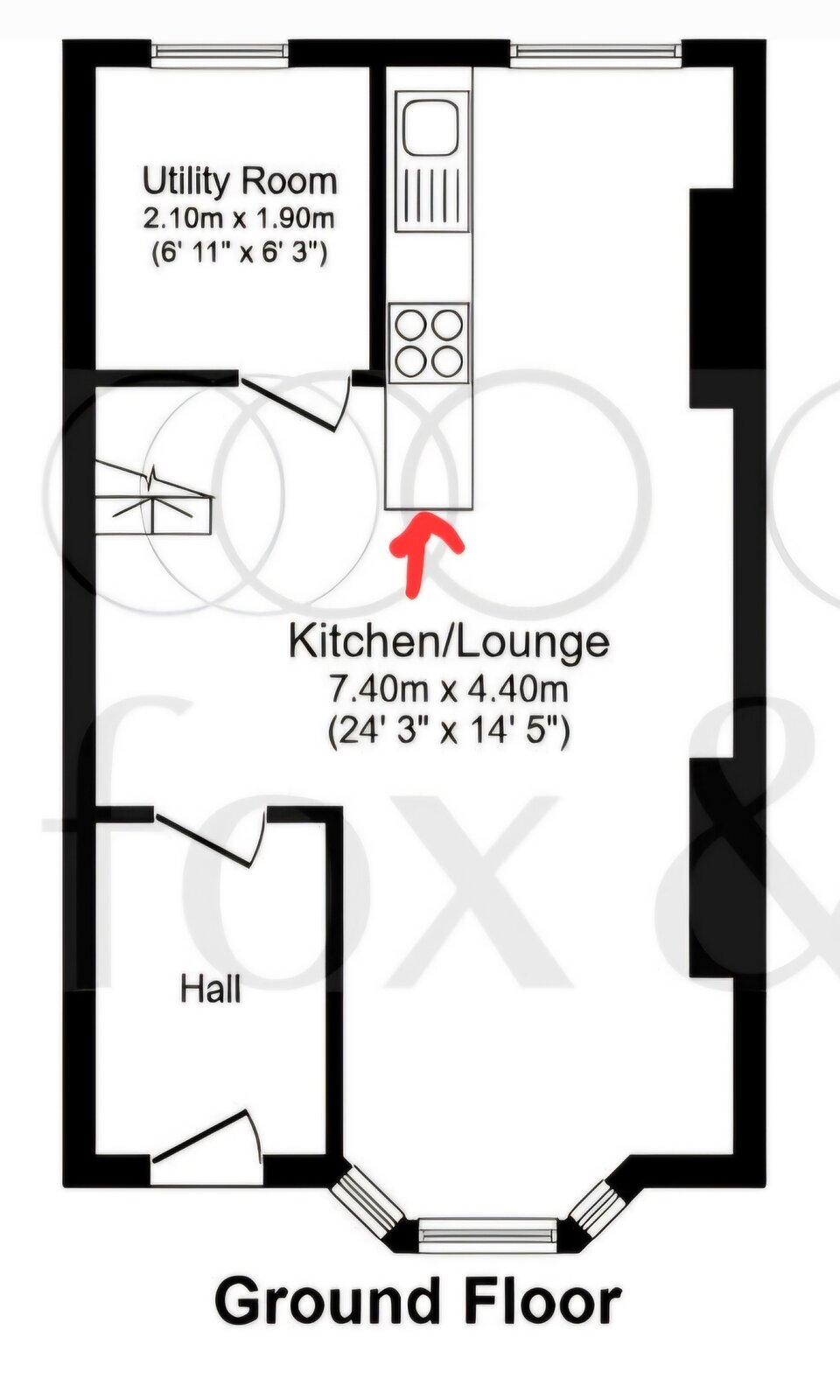

Yep, fair enough! I've attached an image of the layout of the room in any sense and where the radiator is!
In your experience, would the beam running above where the radiator is affect the convector type circulation of the heat around the room?

Oh my - well given the size of that and the actual open space - a column will struggle to heat that space unless it was waaaaay oversized. The convecting rad will certainly be more effective at warming the space, how warm it will get is not easy to say, given it's around 30% undersized.
You say there isn't anywhere else to put another rad, I take it all that wall real estate is taken up? I would even have considered UFH for that size of space.

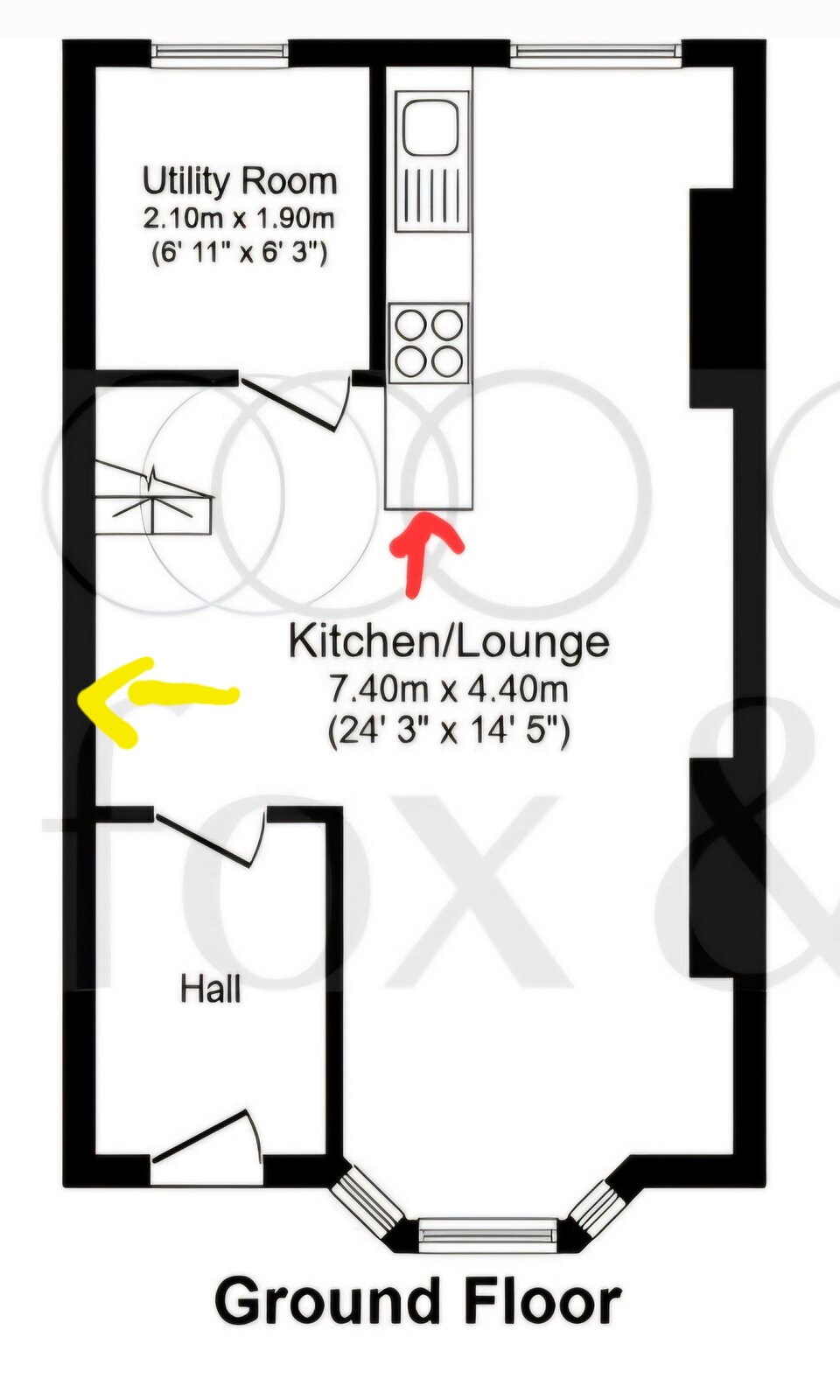

There's wall space available, however, I was just trying to keep the costs down as much as possible, so was going to just to use the original pipework already in place, if possible.
I'm not sure if there is copper pipe that runs around the rest of the living room / kitchen. The only place I can see there is definitely some is on the wall is just past the entrance hall. I guess I could use some tee compression fittings and install one there too? I've attached some pictures (yellow arrow is pipe area, red is column heater already there). There's a radiator just a bit further along in the entrance hall, the other side of the door.
Also, having looked at electric convector heaters, how is it that one considerably smaller than the one I am looking can reach 3KW of heat?
