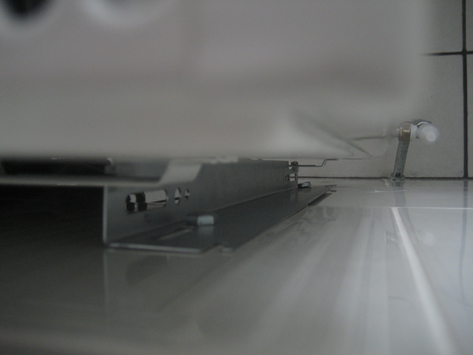

our hallway radiator is corroded and a little under power, so I’m thinking of replacing this type 21 for a type 22 to give a bit more umph!
My problem is that the existing radiator inlet/outlet centres are 66mm from the wall, whereas a type 22 will be 83mm (according to the spec sheet). There is little to no movement in the pipework, so wondered is there was some kind of adapter that can be purchased?
I’m really trying to avoid draining the system as it is an absolute pig to get all the air out!

The Kudox type 22 bracket can be reversed which would give you a 66mm wall to centre fitting, or 83mm as you quoted.
I've used a pipe freezer kit a couple of times on 15mm central heating pipe, it worked for me, just make sure system is cooled down.
Otto
1. My system is an older system with header tank in loft.
2. I was aware the bracket could be used in two ways but took the stated measurement as being that quoted on the Kudos website. I guess I’ll have to check because that would be a huge help
