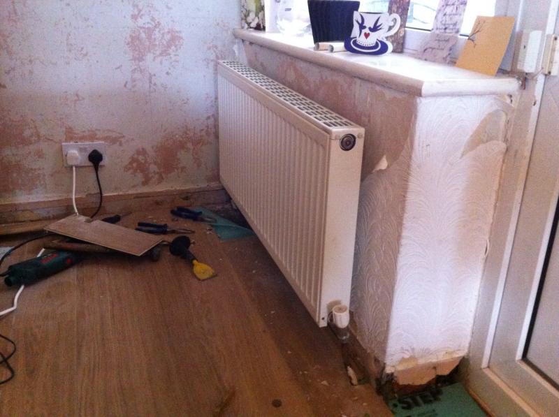

Hi all,
After some advice before I move a radiator.
The half-height wall needs to come out and the opening will be later filled with patio/sliding doors.
I want to move the rad onto the wall next to it. I will sort the socket move first of course.

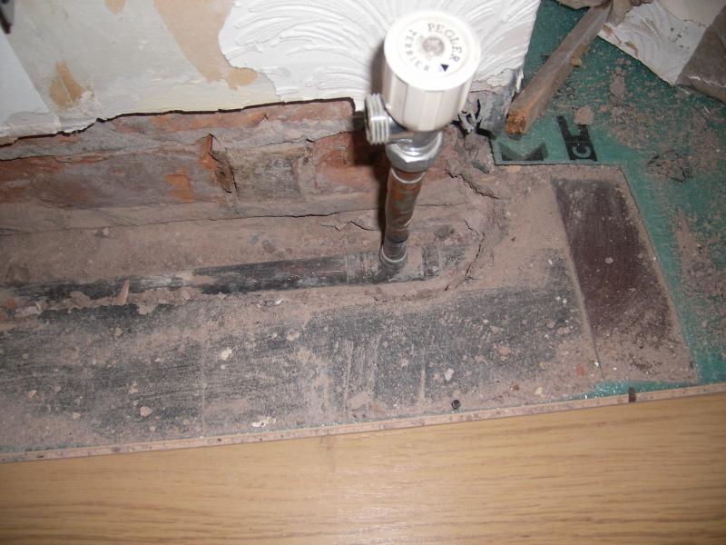

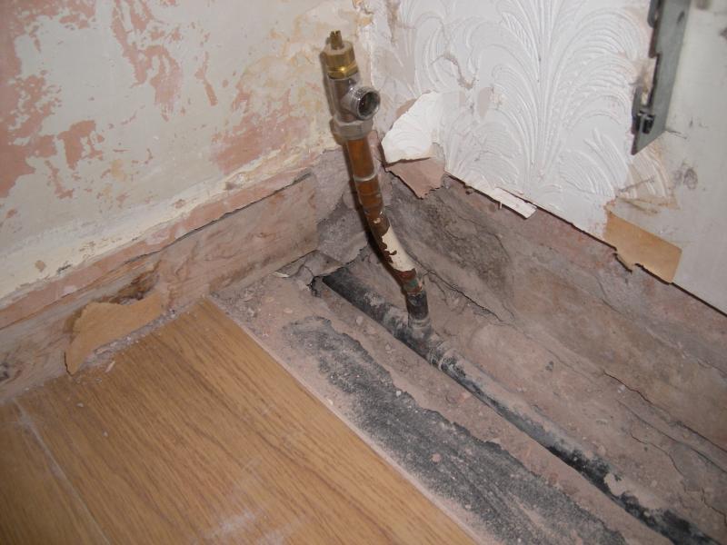

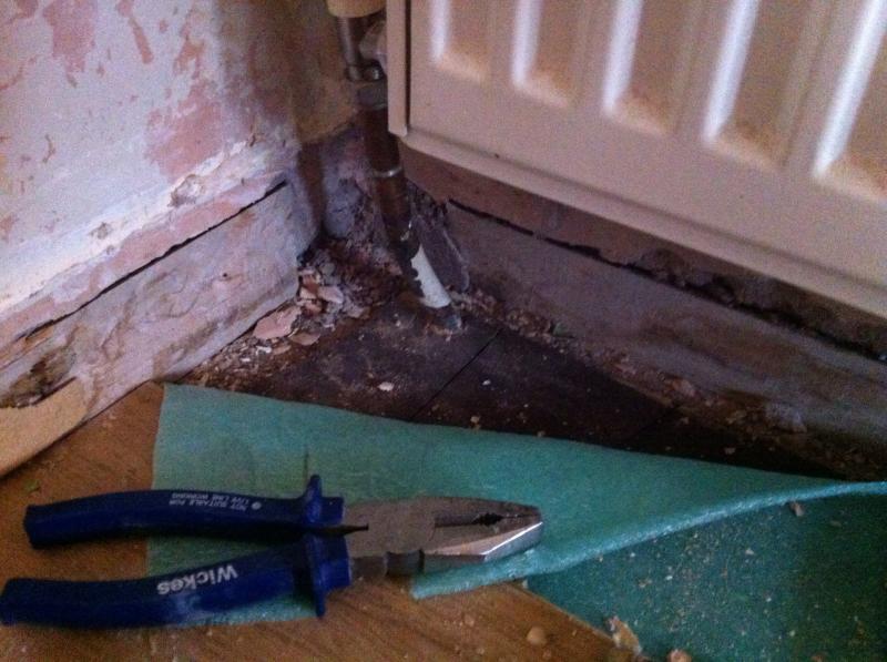

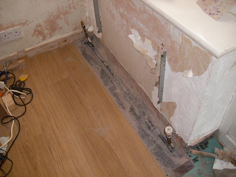

Have opened the floor now after draining the system down.
Some pics for a closer look.
Is it usual for the rad in/out to be on the same piece of pipe?
There's not a lot of play in the pipework, as it's tight in the wall and continues under the concrete at the other end.
I also found in the kitchen that the existing pipework was imperial rather than metric 22mm, so not sure what this is yet.
Any advice how best to approach this? Where to cut etc.
I'm not sure if more of the wood floor will come up easily. If need be, some pipework running along above skirt wouldn't be the end of the world.
It's a one pipe system, if you're not fussed about pipe running along skirting just put a tee in, run the new pipe along skirting and branch off for both sides of rad valves and solder a stop end just after where you tee off.
Thanks for the prompt reply.
It's not very clear from pic #3 (my apologies) but the pipework continues elsewhere in the house.
I'm assuming that means not to put a stop end after where I tee off? Do I tee off and come back in to the original somewhere it is exposed?
