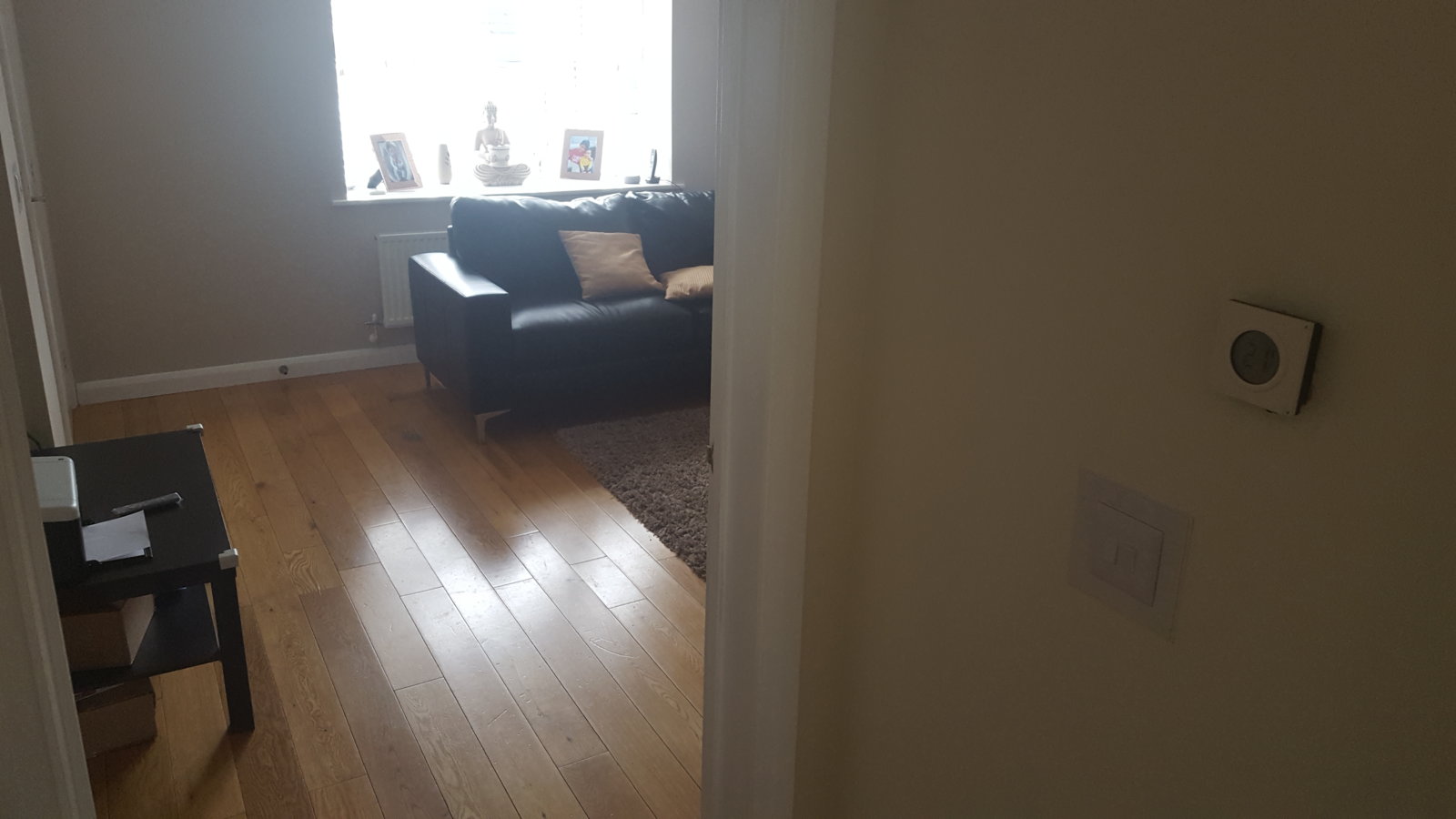

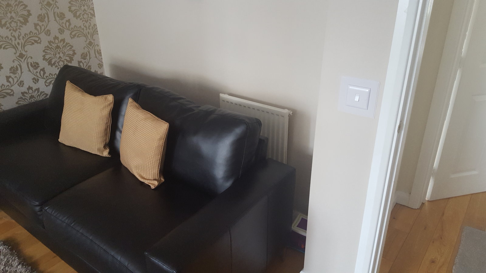

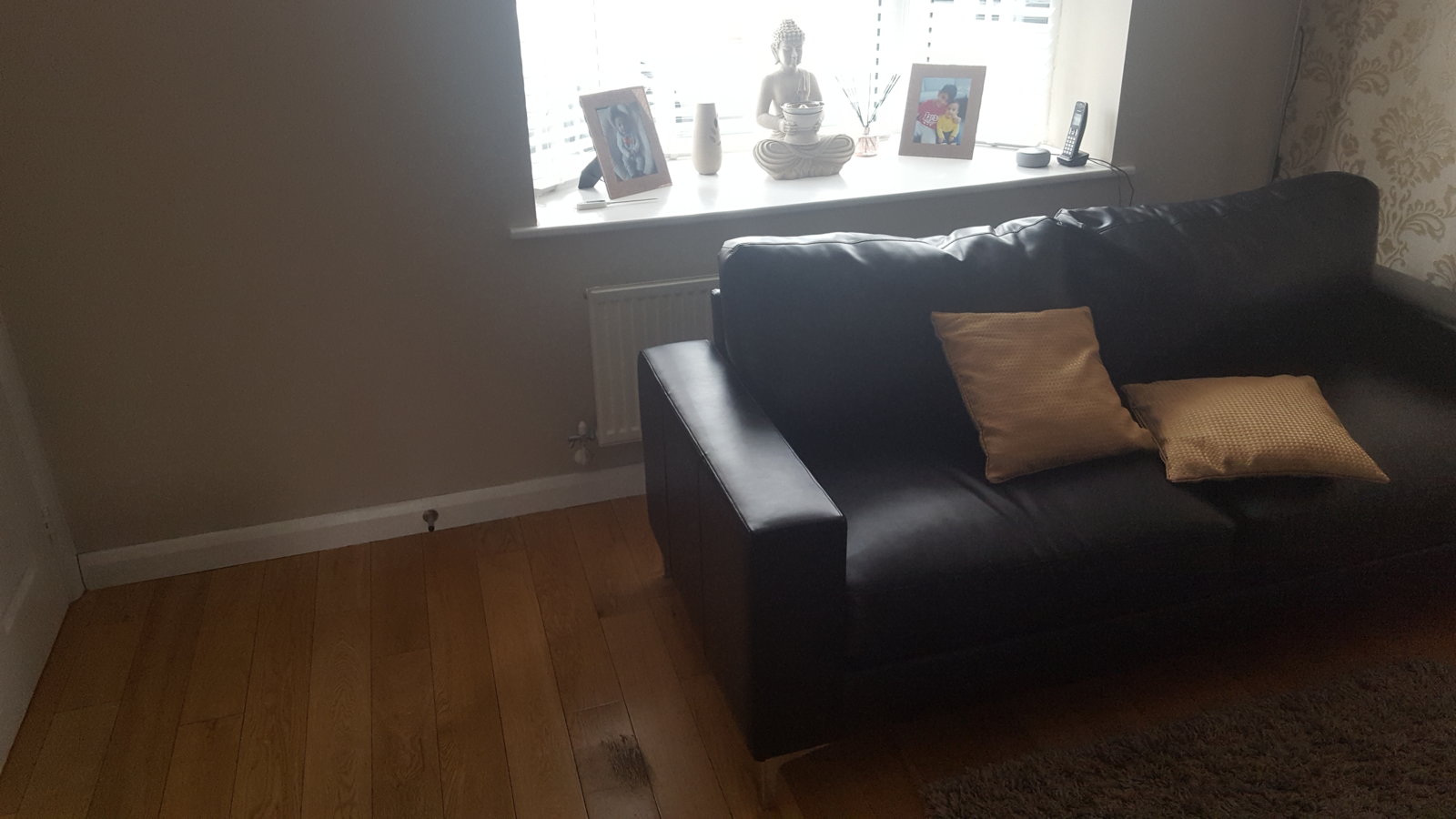

In my living room I currently have 2 radiators one opposite another. Also I have my room thermostat in the same room. However both radiators appear to have Wheelhead Valves on the right and drain off valves on the left. I understamd why they dont have TRVs.
My question is how open or closed should each valve be? Currently the room isnt very warm.
Thanks.
Where is the room thermostat is location to the radiators? Is it near any heat sources such as a radiator, direct sunlight etc? Are the radiators warm/hot? Do they require bleeding?
Hi The Novice,
I have sent you a pictures of the room layout aa you can see there are no other heat sources nor is the room stat near any direct sunlight.
The radiators do get warm but keep firing on the boiler which in turn courses Short cyling. The rads where alot hotter a year or so ago.
I have also bled the rads with no sign of air. Hope this helps.
