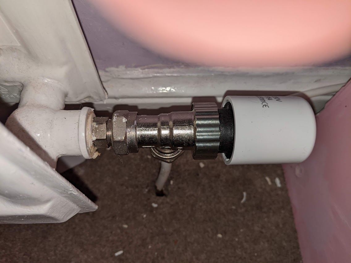

Radiator valve replacement unsure how to connect microbore.

Copper pipe ? If so solder a fitting reducer onto the pipe. Hopefully you will have some free play in the pipe if you need to gain some length.
If I could get the same valve which took microbore I would buy that, but it needs to be 30mm thread on the TRV side. I'm home automating it at the same time.

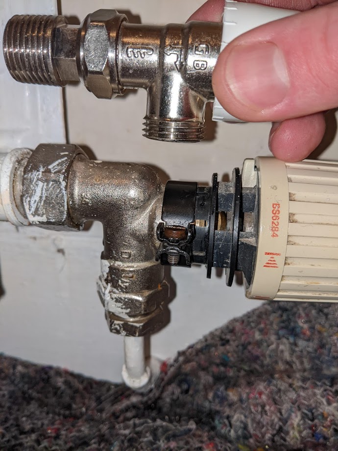

In the attached picture:
The valve I am holding is the new valve. The one currently fitted has microbore going into a female 1/2 inch connection on the existing valve.
I'm just trying to plan what parts I need before I crack open the connection to the existing valve.
I'd rather not drian the system.
I did this on another radiator, and it was a drop in replacement because it had a nut and olive that fit right onto the new valve.
This is what I succesfully installed on another radiator, but it had a nut and olive which accepted the new valve.
The TRV I posted is the same as your old one, just use the old existing nut and olive, it will fit the new valve.
