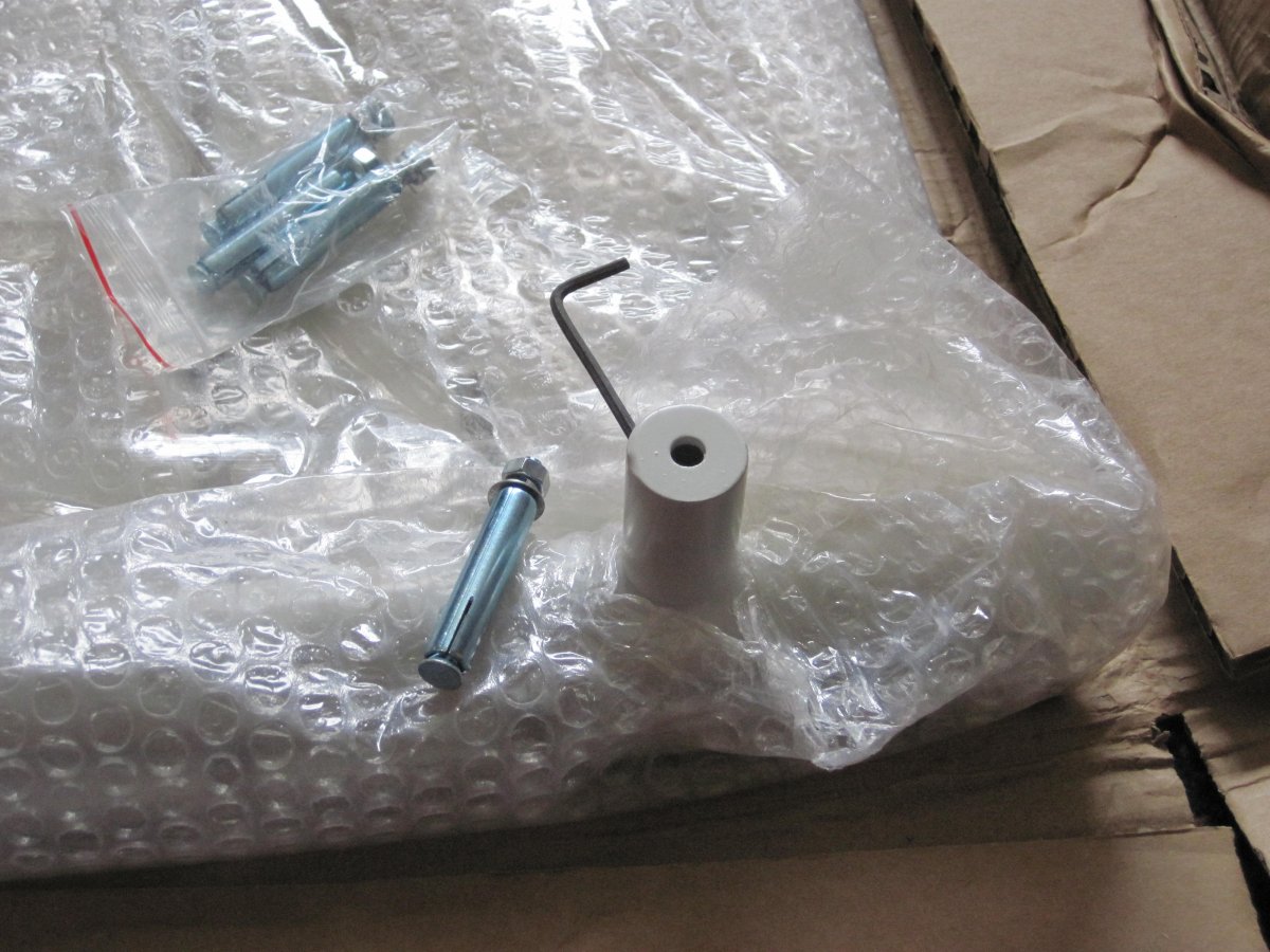

This radiator is designed to sit quite close to the wall, (it has to fit in a walkway and needs to avoid taking up too much space) and has a sort of peg/lump on the back at each corner, each of these has a hole as though it relates to the 4 bolts but how that all works we have no idea.
A picture of the bolts would help. Do they have a screw-in hook on them?
Hello,
Photo attached, the peg/lumps at the corners have a grub screw in them which operates with an allen key, as showing in the photo.
The little tubes are fitted to the wall and the similar fixings on the rad interface with them.
The expanding bolts are suitable for most wall constructions. But the plumber should have experience on what will suit your particular wall.
One of the biggest problems is that the wall fitting do need to be very accurately set out. The instructions should give the dimensions.

It is pretty simple.
On the back of the rads are small stubs.
The separate tubes supplied are screwed onto the wall and the radiator stubs are pushed into them and tightened up with the grub screws.
The only question is how you will fit the tubes in an exact position so they will line up with the stubs on the rad.

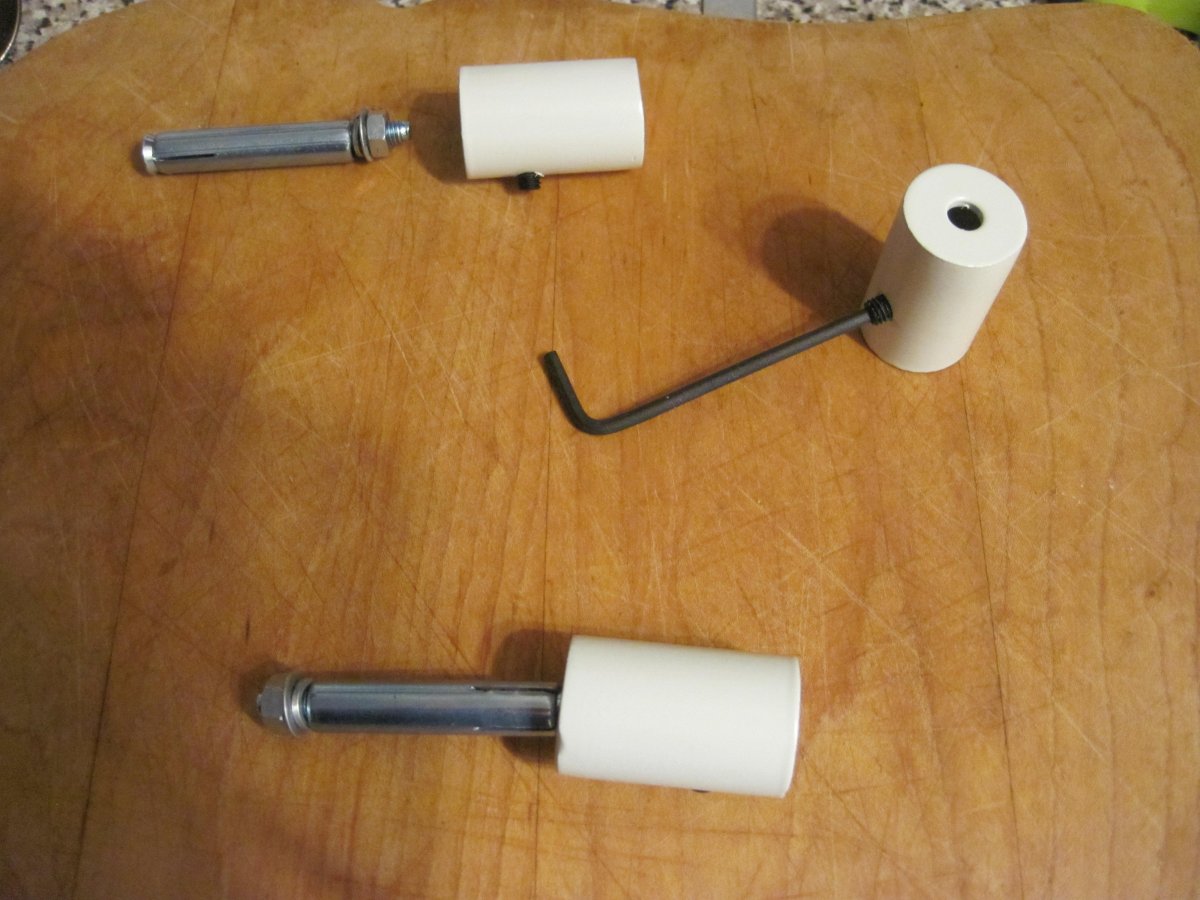

OK Thanks, having slept on the matter the penny has now dropped! When you undo the grub screws on the pegs at the corners of the radiator you can actually pull off the outer cover of this peg, you can then feed your fixing screw/bolt through this outer cover and then bolt/screw it to the wall. I have attached a file with a photo showing the bits.
If the radiator had come with some very simple instructions to this effect it would have avoided the need for this thread.
Many thanks for all your comments on this and sorry it took us so long to get our poor old brains around the resolution of this mystery, but we got there in the end.
Nearly there :)
The sleeve anchor needs to be the other way round - as the nut is tightened, the bolt head is drawn into the sleeve and the sleeve splays out (that's what the four slits in the sleeve are for)
