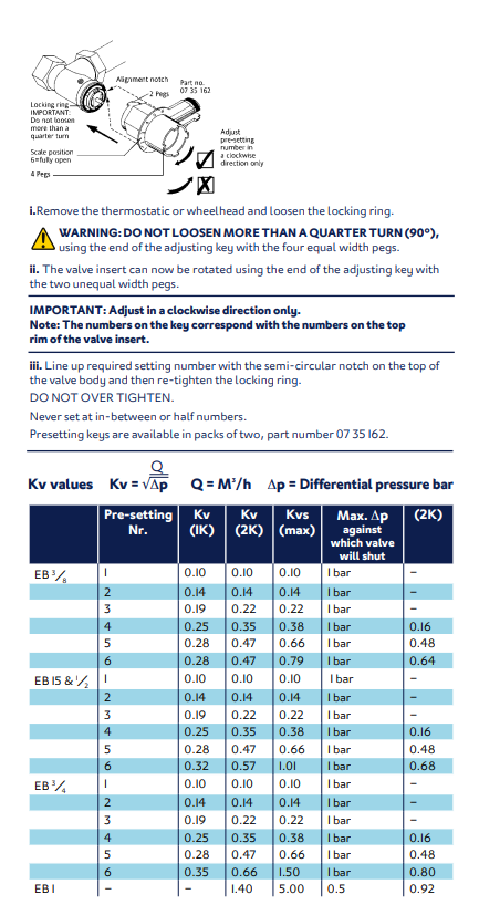

Earlier today, I spent a couple of hours balancing my radiators. I did it via the Drayton TRVs using their balancing key.

A setting of 1, Kv of 0.1 is a flowrate of 0.1m3/hr, 1.67LPM @ 1bar dP, if one assumes a "average"1M dP across the rad then the flowrate is 0.032m3/hr, 0.53LPM?, this flowrate, theoretically, will give a dT of 27C/kw of rad output, you say you are getting a dT of 12C across the column rad which infers the rad is outputting ~ 2.3kw normally?

I have changed the TRV to pre-setting 3 to roughly double the flow. I think the volume of water in the column radiators is much greater than the Type 22 rads?

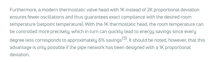

What do the (1K) & (2K) in the 3rd & 4th columns and the (2K) in the 7th column mean.
It apparently refers to the 'proportional deviation'. I don't think my system was 'designed', so I've got no idea what my system's proportional deviation is. I presume it is 2k, because 1k appears to be better and I think the system fitter wasn't very good.
