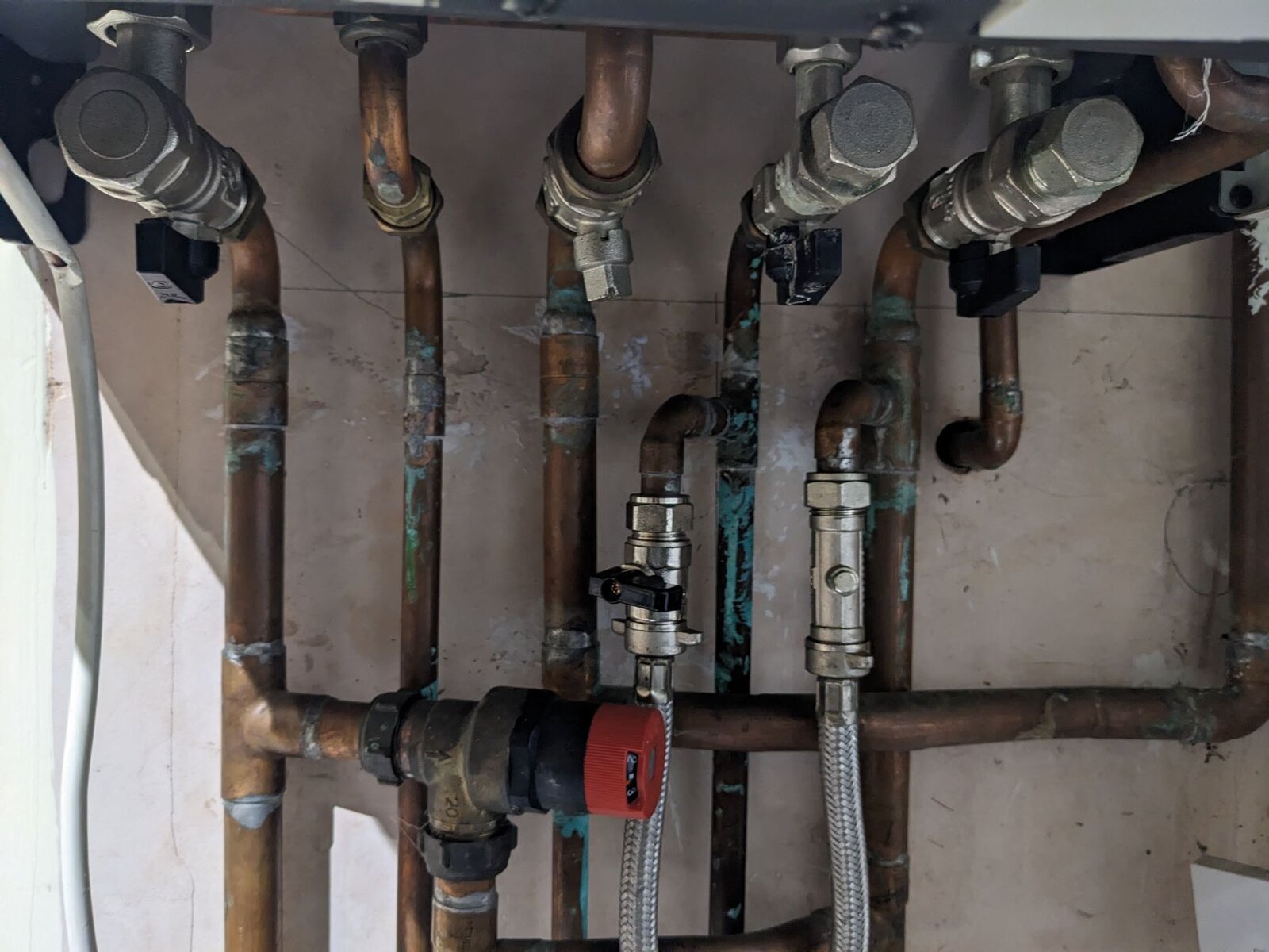

Very frustrating, I tried closing off all the radiators except one to see if it was balancing issue but that did not work as the radiator which was left on did not get hot at all... which prior to closing the valves on all the other radiators did get hold. I have tried opening the valves on all the radiators again but now none of them are getting hot. The pump is spinning fine and getting hot. The hot water works fine still with no issues. Does it point to a blockage in the pipes/radiator or could it be in the diverter valve, I did refurb it using a kit from ebay already.
The heating flow pipe is hot under the boiler too.. but none of the radiators or the pips on either side of the radiators. The first pipe in the picture attached (1st pipe on the left is hot)

Sounds like there is no flow. Given that you have worked on the diverter ,did heating function at all after you worked on that ? If it did ,then the pump would be the next suspect.

how can you diagnose if it is the diverter valve or not? Both the pushrods come out and activate the microswitch on it when the CH is activated.. can there still be blockage or parts in the Diverter valve not working properly, is worth me taking it apart again or getting another refurb kit for it and changing the internals on it again?
Bound to be the diverter valve ,isn't diverting !!
Are you certain the pump is good ? Take it off and Examine it.
the pump spins fine.. is making all the right noises and getting hot. I undid the middle screw, water came out and used a screw driver and it was spinning/turning without any issues. What else do I need to check on the pump?
Also will just taking apart the diverter valve and reassembling it be sufficient given that it has had new parts inside two weeks ago approx or should I get another refurb kits? Both the push rods on the diverter valve pop up as they should when running.

You appear to have manually turned the pump ,but with boiler / heating turned on is it spinning ( electrically propelled )?
I have undone the screw on the middle of the pump and when the boiler is activated HW or CH is switched on it is spinning. i can see it spinning and when touch it with the screwdriver feel is spinning.
It is the diverter valve, the refurb kit I got off ebay must not have been the best quality, I had to use a screwdriver to push the pushrods fully in and out on the diverter valve to get everything workings as it should do. Where is the best place to get a good quality diverter valve refurb kit from?
