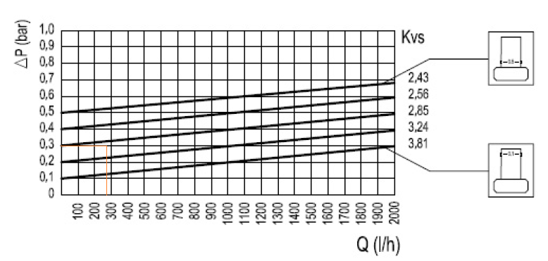

I have found the instructions for the OP's bypass valve and have plotted the requirements on it: Flow 4.5 litre/min = 270 litres/hr; Pump setting CP1 = 30kPa = 0.3 bar. This shows that the bypass has to be set somewhere between 0.2 and 0.3, but where exactly? At 0.2 the flow will be too great; at 0.3 there will be no flow? How can you accurately set the valve without a flow meter?
The engineers I asked are far more knowledgeable than me and want to know the ins and outs of a ducks bottom. They say do not need a flow setter, just set to minimum flow of boiler, how you get to that I suppose is our problem. They most certainly know their stuff
