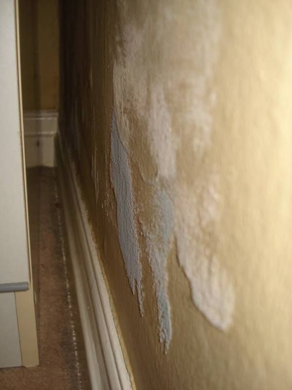

The plaster and wallpaper in my living room keeps getting soaked in severe storms and water literally pours in above the window through the wallpaper (coming through the stone) and also pours in through the wood door frame around my front door and there is visibly damp on the wall between my window and door. This last winter my living room ceiling got a soaking, became discoloured and cracked, I'm worried it may come down or the timber up there may rot if I don't get this water problem sorted.
The pointing is in excellent condition.
A bodge firm over 15 years ago put in replacement wall ties, it wouldn't surprise me if they did something wrong when installing them.
There's no cavity insulation.
The outer stone is visibly porous and crumbly.
The roof can't be the culprit as I've had it replaced.
My upstairs bedroom windowsil gets thoroughly wet each winter, expands and blisters even though the silicone around my window outside is in perfect condition.
The house was built in 1935.
I've had a builder round who says not to bother putting water repellent spray on my masonry and he wants to put in cavity trays above my front door and ground floor window. In your opinion is that the way to go? If my living room ceiling got soaked and it's a clear foot above the front door then surely having a new cavity tray above my front door won't stop my ceiling from getting wet? Also surely if an abnormal amount of water is getting into my cavity, it would roll off either side of the cavity trays still and get my inner skin damp?
My dad advises not to have any structural work carried out and to apply water repellent spray onto the stone every 10 years to stop the water from getting in in the first place.
Can I have your advise please as I'm confused and don't know what's for the best and I don't want to throw money down the drain on work that won't cure the problem.
Ruined wallpaper and mould above my living room window and on my ceiling.
Water coming through the wallpaper above my window.
Water pooled on my windowsil.
My ceiling above my front door.
My living room between the window and door.
The living room, note the ceiling is a foot higher than the door.
The house after a storm. You can see my stone looks wetter than the neighbours either side.
What I have to constantly wipe off my walls in my bedroom upstairs each winter. The walls in my bedroom don't appear to get wet, there's a bit of wrinkled wallpaper but no pouring water coming out of anywhere but this area has no bricks or plaster behind the wallpaper (don't ask!) and so there must be a lot of moisture in the cavity and mould forms here.
Yes you probably need cavity trays. All windows and doors should have one above them.
For a waterproofing, look for a silane/ siloxane based product. These will last more than 20 years.
There's probably more than one issue. How long has it been like that? Have you had any other work at all undertaken that may have lead to this? It cant have been like that for many years as you'd have addressed it before now.
Cavity trays might work - but they weren't there when the house was built and it wouldn't have leaked like this then.
Is it even cavity wall construction? When were the windows doors fitted? Has anything been done to these that may have lead to this amount of water getting in?
Sealing the stone work might help, but I doubt that amount of water is getting in via the porosity of the stone.
Also, dont rule out the roof entirely - I understand that youve had it done, but assuming that cant possibly be the problem may lead you to barking up the wrong tree
That front roof verge looks wrong.
There is no apparent overhang of the tiles, this will allow water to enter the wall and run down within it. It needs to be corrected.
looking at the window cill and reveal widths it looks like the walls vary in thickness quite a bit, some cavity,some solid?
