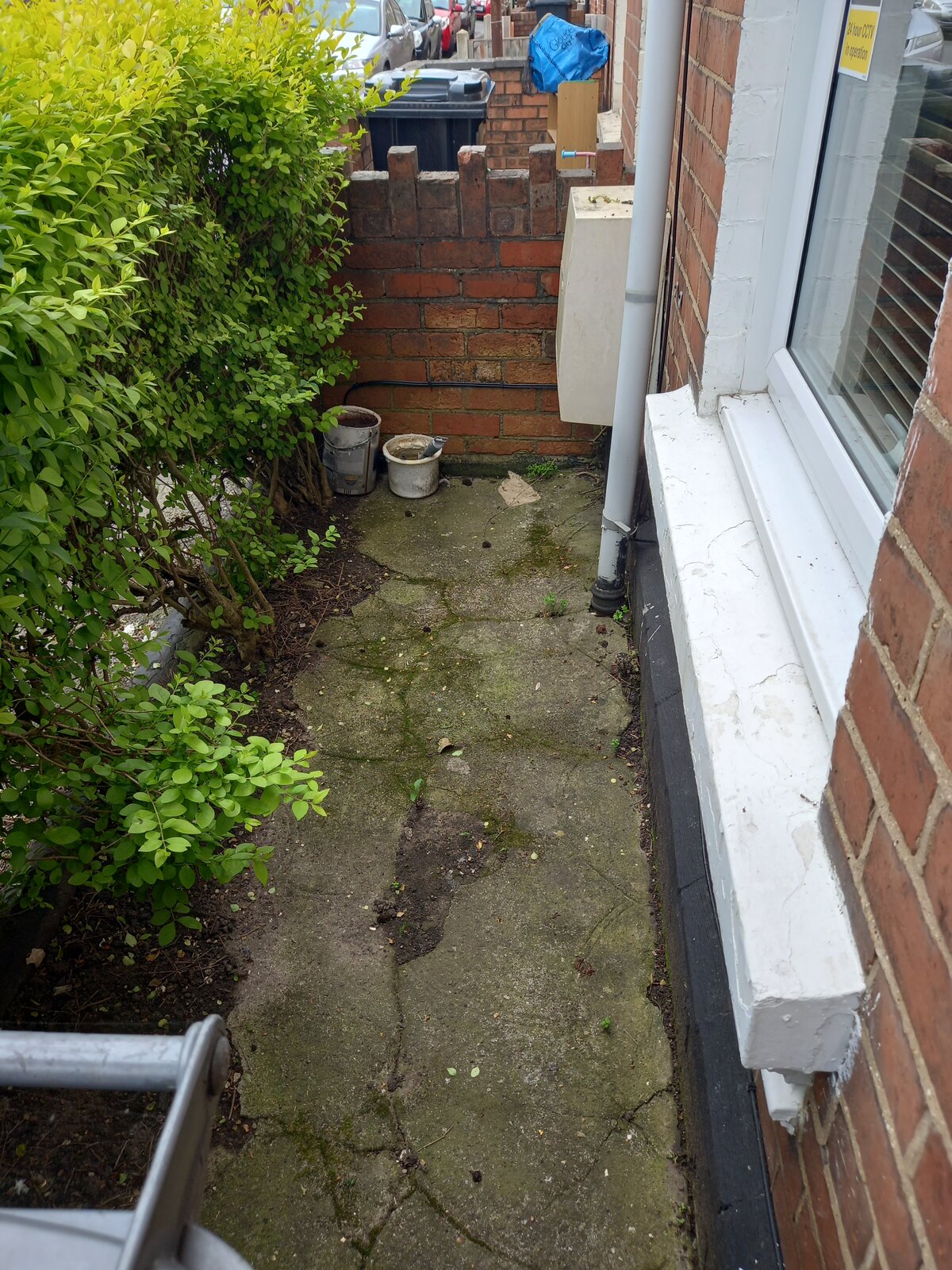

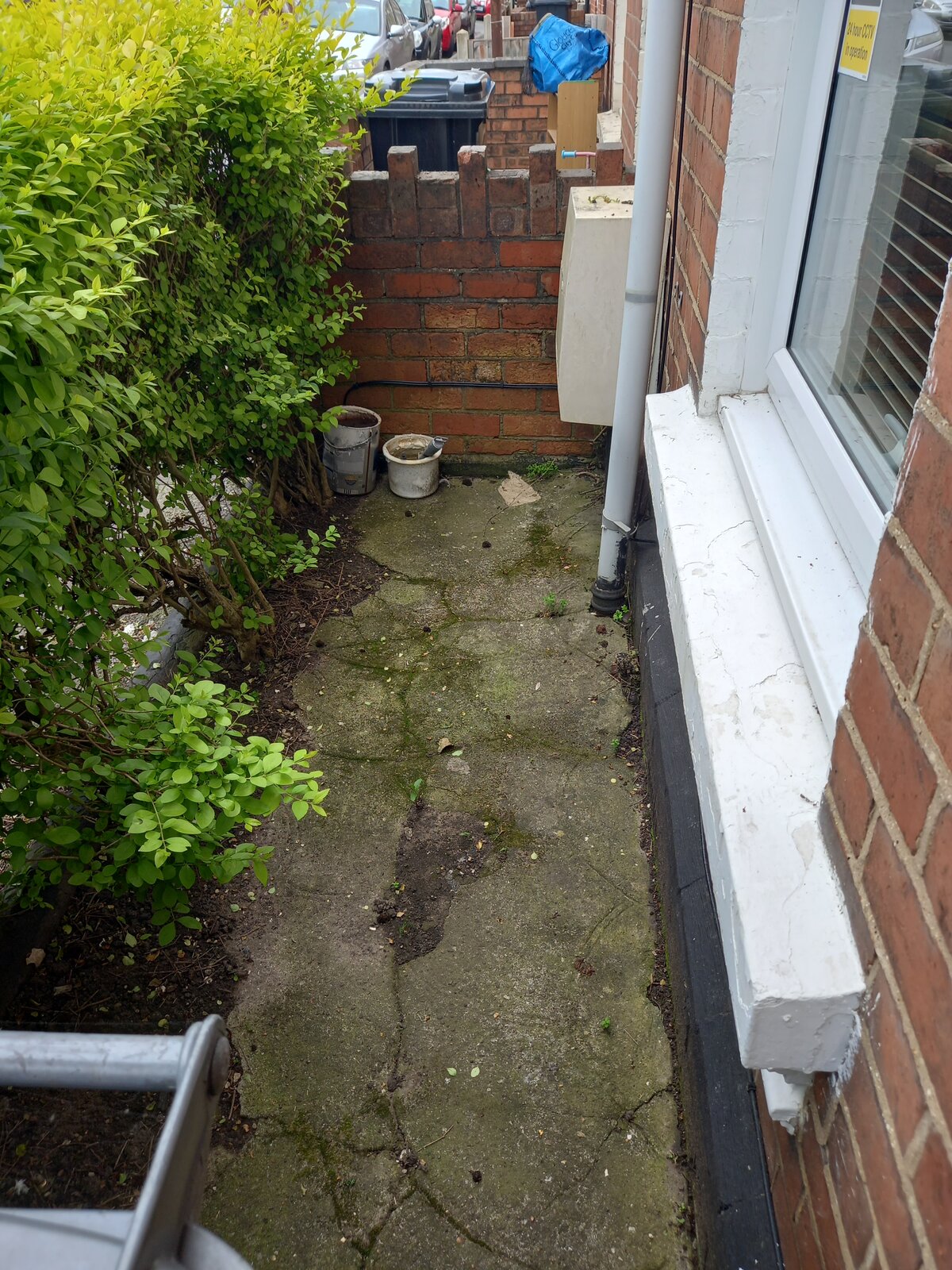

The neighbour's ones run straight into the ground. From what I can see, all of them along the street are the same. Not sure which have outlets onto the street, I didn't look that close.
From the attached pics, all of the houses' down-pipes look like this.

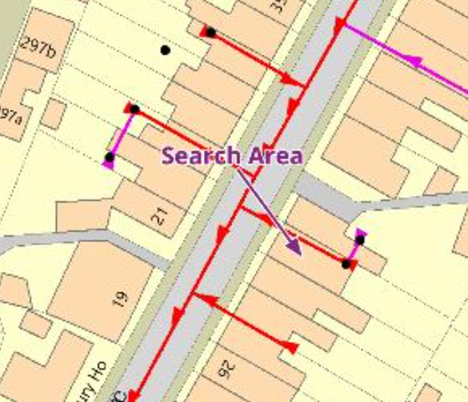

The other pic is from the Searches when we purchased the house. I assume that the lines with the arrows are the foul water runs. Not sure what the properties with no drainage runs showing, do.

my house a mid terrace [1907]the gutters at the front right to left into there drain then at the back left to right so all drains are the responsibility off sesw
are you sure you dont share with the neighbours both back and front ??
the plan you show is rear drains only from what i can see ??

This is the query. There does not appear to be any plans showing rainwater drainage, particularly at the front.
The arrowed property is mine, with next door (to the left facing the front), draining into mine at the rear. I assume to be sewer.
I'm assuming that all other properties with drainage runs not shown, will somehow drain into the next run down-stream?

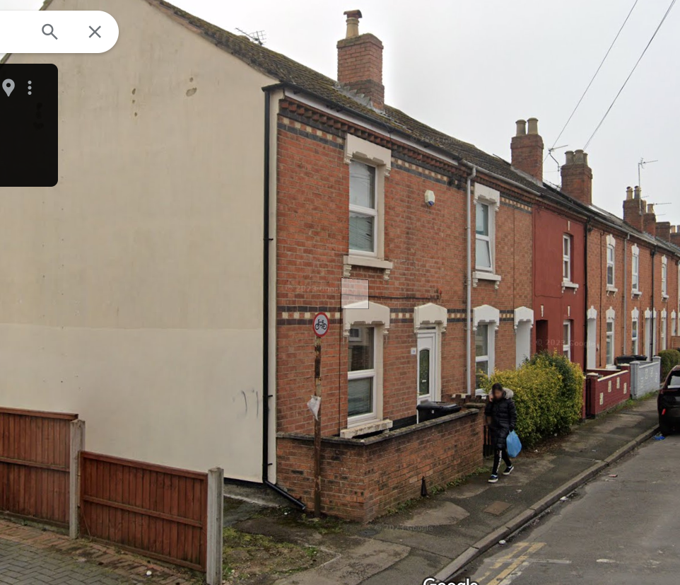

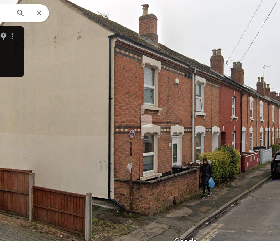

If this is the case then there wouldn't appear to be anyone's drains running past my front door as the same neighbour (left facing front) being end of terrace, has in fact diverted his from going into the ground and kept it surface, see pic.

The rain water pipes probably drain straight into the ground like an informal soakaway. Yours has probably been directed towards the road because it was suspected of causing the damp. Whether or not it did, the damp is still there, drying out. Something else may have caused/contributed to it, look at tne dpc, is it bridged?

Are gutters clear and draining correctly , ?often the narrow frontage on terraces is compromised by high ground levels so rain splashes up the walls causing damp .If you have cement to front you could dig out, reduce height and fill with shingle to aid drainage .
Common practice in the Victorian era was to put rainwater from the rear into a combined sewer, and the front, straight to the road, where it would find its way into the Road Gullies, which then either went into a surface water sewer, or also connected to a combined sewer.
I would hazard a guess you've got some pipework underground that heads towards the road, and also equally possible the dozy Council have buried it at some point in the past when they've laid new kerbs and/or raised the footpath....
