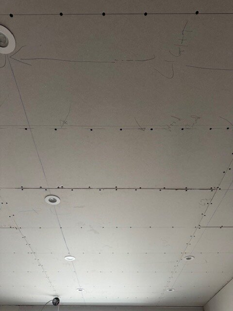

Raised edge between plasterboards - how much is a problem?
25 Nov 2006
901
22
London
Hello
What’s the maximum workable uneveness between plasterboard edges when skimming? I’m wondering how big a problem this one is going to be. And how can you fix it? It’s square edge plasterboard. Do I need to measure it? Thanks
A plaster worth their salt should be able to feather it out ....have you used different thickness boards or trapped something to get a lip?
Thanks. No, it's the same thickness plasterboard. I didn't do it myself but the person who did said he struggled with the joists not being level. (I'm not surprised, nothing in this house is square or level.) I know he was using packers so I guess this is the best the could do.
Thanks. He was diligent in how he fixed the screws in.
I asked because a friend had commented ‘you’ll never get that ceiling looking good with that ridge’. I feel more optimistic about it now.
