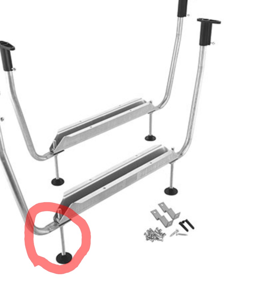

That's brilliant thankyou. I think the tile was blind and stupid.. They put Grout to seal round the edge of the bath rather than silicone so of course it's all crumbled away.... The legs look like this.... Is it straight forward because it didn't seem to budge when I loosened 2 of them. The red circle is where there is 2 nuts either side of the supporting bar so this design is slightly different

Bath may well (should!) be, screwed to the wall with some 'L' shape brackets that are concealed behind the tiles. I'd be wary of trying to raise the bath without checking for these first, and in any case, would be looking to seal the gap as is, rather than lift the bath to suit.
