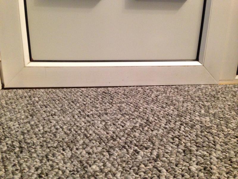

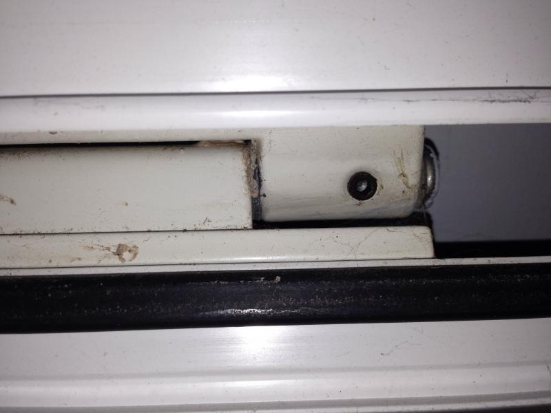

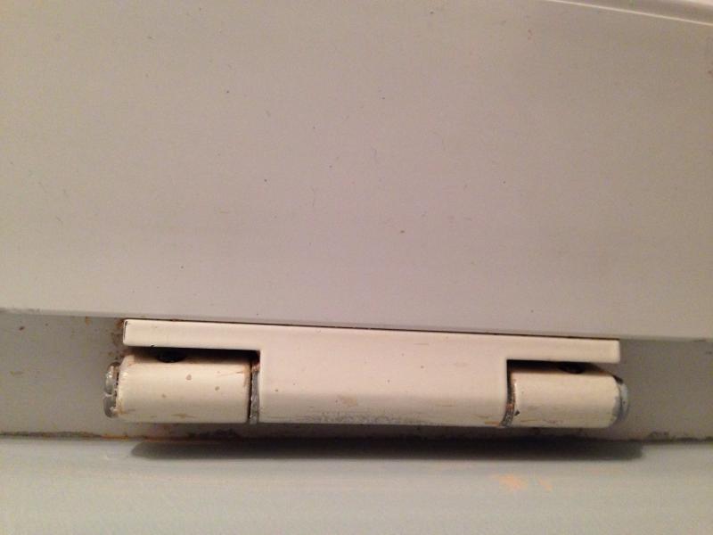

I recently made a switch from laminate flooring to carpet and unfortunately my front UPVC door is catching slightly on the carpet. Its an external door and I would guess is approximately 10-15 years old
My question is whether it's possible to raise the level of the door by 5mm or so with this hinge arrangements. Alternatively is it possible to plane a UPVC door?

There's no adjustments on the hinges, so....
Option 1. Toe n heal the door higher, enabling the door to clear the carpet, you may need to move the keeps on the frame to suit the new higher position of the door.
Option 2. Not ideal but cut 10mm of bottom of the door, shouldn't effect the efficiency or performance and won't really notice if cut straight
Option 3. Cut into the carpet a welcome mat, this would need to be set in slightly lower than the carpet to gain clearance

I can confirm that the laminate flooring has been removed, but the combination of Carpet and underlay is sitting higher than before.
As for heel/toe - I'll have a look on youtube and see if there is any examples. From its description I assume it's simply a case of wiggling the door up the frame slightly? If an adjustment doesn't work should I look into replacement hinges or is this no possible with UPVC doors?

Take the fixings out of the door and cut the sealant off, then wedge the frame up a bit and refix in new holes, if there's not much room to go up then take out the whole door and frame cut 10-15mm off the top then refit higher :mrgreen:
