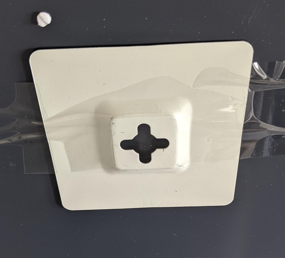

Hi
i've got a mirror to put up on a bathroom wall.
wall is plasterboard (hollow behind i believe, internal wall).
mirror weighs about 6kg, so is reasonably heavy, and in the orientation will have 2 mount points on each top corner (it's wide and thin).
so looking to know which rawl plugs/screws i need to secure this to the wall.
photo attached of what the mounting brackets look like
i believe it is hollow, however it was the weight of the mirror that concerned me.
it's wide and quite heavy, around 6gk i believe.
also, the screw head being big enough to fit the mount on the mirror

If I interpret your photo correctly, the mounting bracket is a version of a keyhole fastener, so you can lift it onto the screws and it is intended to space the mirror slightly off the wall.
If the mirror is 4 ft wide, it is pretty sure to span at least two studs, possibly three. So you can cut a horizontal batten to the width of the mirror, top and bottom, and screw it to the studs, which will hold the weight, and screw your mirror through the batten, which will prevent it tilting. This will prevent the heavy mirror wrenching the screws out of the plasterboard.
sorry, that's not a route we will be going down.
that's correct, the mirror will hang off the screw that is in the rawl plug.

i'm just worried that the weight of the mirror hanging on the screw will pull it down and eventually out the plasterboard, as the mirror will not be screwed into the rawl plug but essentially hanging off the screw.
Move the hooks on the mirror to match the position of the studs
whilst i appreciate all repsonses, can i just get the advice i asked for? which is specifically about which rawl plugs i need.
i'm not going to pull off the glued on brackets (weakening them in the process) on the back of the mirror just so it matches a stud position.
Glued on brackets???
No matter what glue it's been used, it will fail given time, temperature and humidity changes.
So your last worry should be the fixings.
Get some proper brackets/rings,hooks and SCREW them into the mirror frame with appropriate screws.
Besides, if you really trust those glued on brackets, use plasterboard fixing; they're strong enough to hold well over 6 kg
