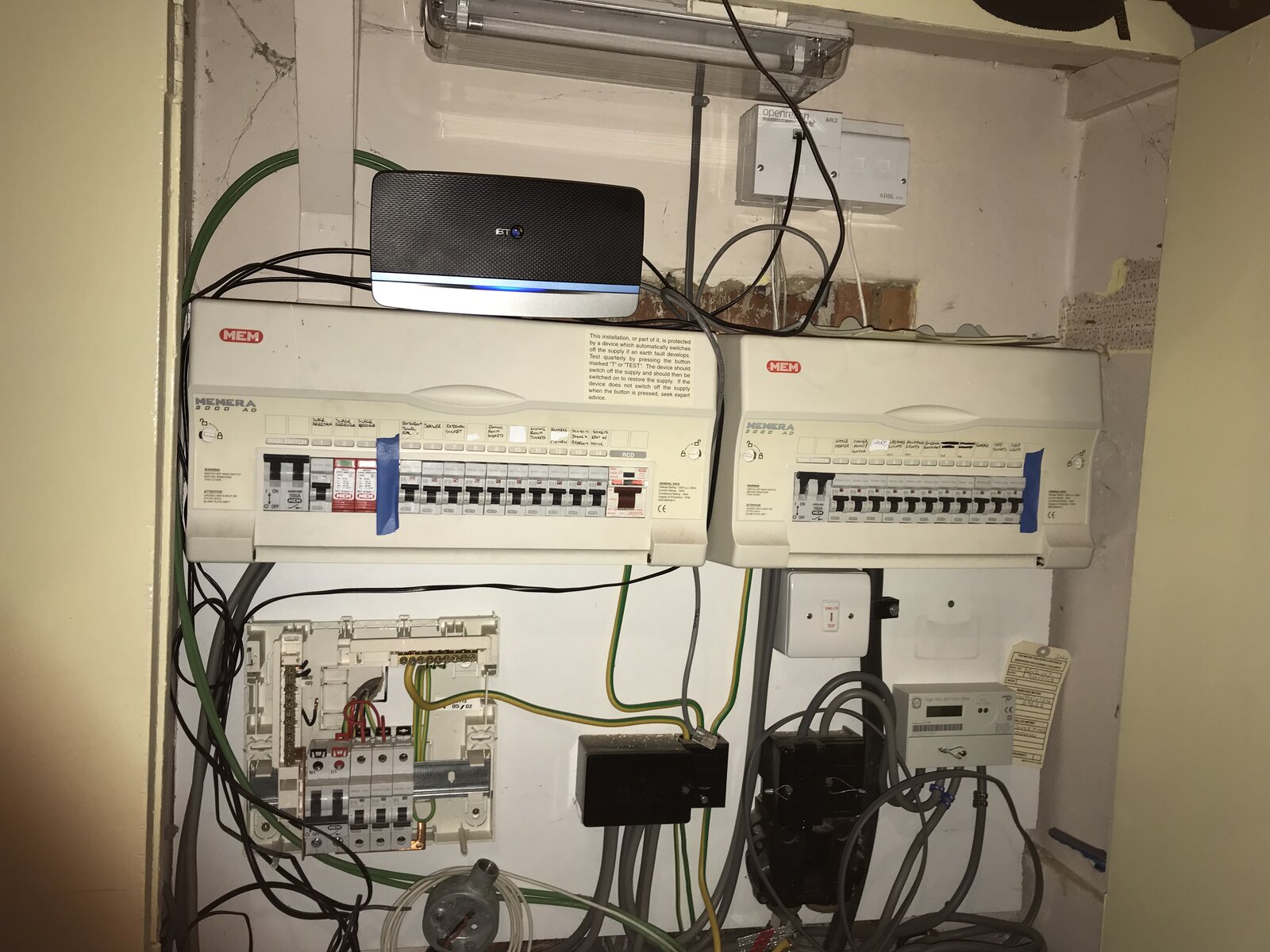

Had a strange one today.
The RCD at my parents house tripped for seemingly no reason. It’s a MEMera 2000 board installed by me about 20 years ago. It’s effectively a split load 16th edition installation, although its done with separate CUs for historical reasons.
The board supplies all the sockets, central heating, shower pump etc. All wiring is PVC/PVC of varying ages.
They reset and it held for about 5 minutes before tripping again.
Reset it a second time and it held for about 90 mins before tripping again, so I went to investigate.
First thing I did was a global IR with the RCD off L&N>E as there were still loads connected at this time. I got a reading of 0.8MΩ. Not ideal, so broke the install down, removed the loads and tested each circuit, and they all tested good.
Put everything back together and the global IR was still down. After a while of trying to work it out, I disconnected the RCD functional earth wire, and the global IR went straight up to 48MΩ, which is probably about for the installation.
I found a new old stock exact replacement in one of my boxes of crap at home - I knew it would come in useful one day! Anyway new RCD installed with functional earth and the global IR remains at 48MΩ
The power has been back on a few hours now and touch wood, everything seems ok. What are the chances that the RCD its self was causing the problem?
Out of interest, I tested the old RCD in situe under load conditions and it tripped at 21mA on a ramp test and the trip times were all within spec.
As I was just arriving at my parents, their across the road neighbour whom I have done work for before came running across saying she needed me as thier RCD had tripped this afternoon, and then again about 90 minutes later, almost exactly the same time as my parents house. What are the chances that this is just a strange coincidence? IIRC i installed her a split load half RCD half RCBO 17th edition board. I’m not sure which device tripped yet, but I said ill bob in and have a look in the next day or so.
Here’s the setup purely for your own amusement.

I'd always disconnect the functional earth when doing the global IR, most makes of RCBO it drags it right down, tbh I don't know with these, and these are the only 61008 devcie I know of with the functional lead.
Its odd that the new one does not drag it down to 0.8 as the figrues look right... 48meg for the install and 0.8meg if you forget to disconnect the functional earth. Could yuou have reversed the polarity of the IR tester between these two tests, perhaps there is a diode in the functional earth path of the RCD and it only drags it down to 0.8meg on one polarity... should be easy to check, can you do the tests on the removed RCD that you have on your bench?
Think the MEM RCDs of that age did have poor EMI filtering, I have heard of a caretakers PMR radio taking a load of RCBOS when he was stood near the board
