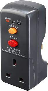

Second thoughts; if the test is between 'L' & 'E' then no. I've not looked into how RCD testers work.
A plug in RCD
uses both 'L' & 'N' for the test so will (or could) trip either or both RCDs in the CU.

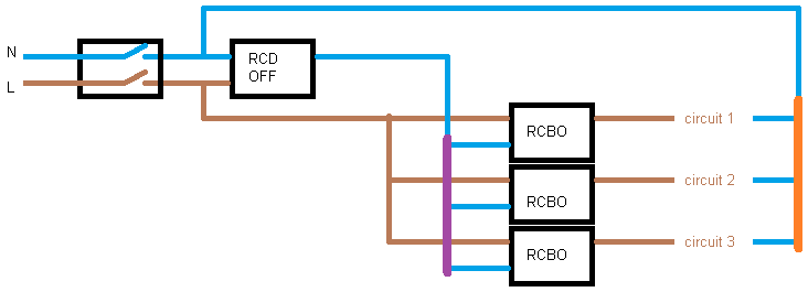

Just had an interesting chat over the phone with a friend, and mentioned this thread and putting the neutral wire in the wrong bar.
He described an inspection on a CU which had been upgraded to all RCBO but one RCD had been left in place feeding a neutral bar shown purple, all the RCBO neutral wires only got a neutral supply if the unused RCD was on. The outgoing neutrals were in another neutral bar which was proper neutral shown orange.
The customer was happy with the work until they noticed the RCD was 'off' and flicked it 'on', things tripped and they called sparks in when they couldn't leave every trip 'on'.
I couldn't see how it could work until I drew it out, I hope I've interpreted it correctly.
