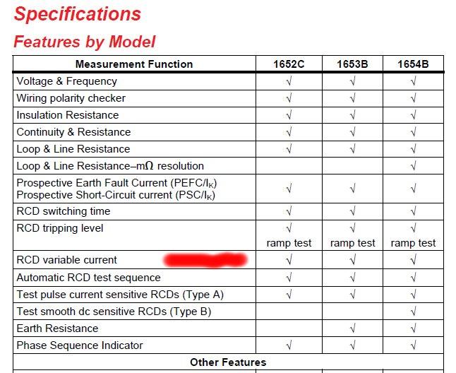

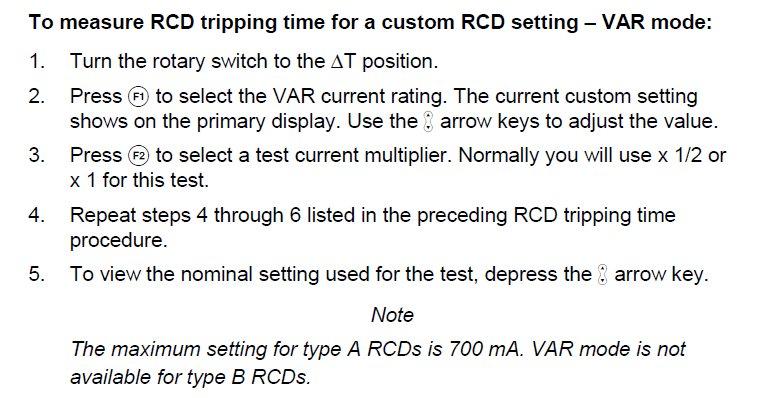

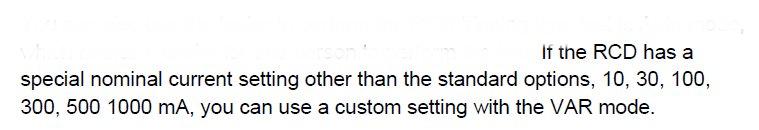

Perhaps not explicitly "2x", but many meters (like, AFAIAA, all the recent Flukes) offer a 'variable RCD current' facility, which enables one to manually set whatever current one wants.
I'm not sure what you mean by 'explicitly'.
My and your 1652 cannot test at 60mA so a 2x test cannot be done.
I meant that there is no "2x" setting available on the meter.
If, like mine, yours is literally a '1652', then that's true. However, my understanding is that from 1652C onwards (I'm not sure about 1652B), you could set any test current you wanted, including 60mA.
Kind Regards, John
No, mines a 1652B and cannot do it.
There is nothing in the Fluke manual - which also covers 1653s about this.

Ah. that 'VAR' only refers to the currents that the machine can do - 10, 30mA etc.
You cannot 'set' it to any current you wish, e.g. 60mA.
