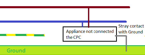

Can I ask why leave the cpc connected to the earth bar and not disconnect please?
If the CPC is disconnected from the Earth bar ( and hence no longer connected to Ground ) then resistance checks between Neutral ~ CPC and Live ~ CPC will not discover the stray contact as in this sketch. The word appliance includes cables and wiring as well as equipment.
A cable that has has its insulation damaged / chewed and hence has a path to Ground ( not the CPC ) through damp or moisture is likely to cause the RCD to trip but checks of insulation resistance from Live to CPC and Neutral to PC will be "good".
EDIT... checks of insulation resistance from Live to CPC and Neutral to PC will be "good" as the Ground is not connected to the CPC.
