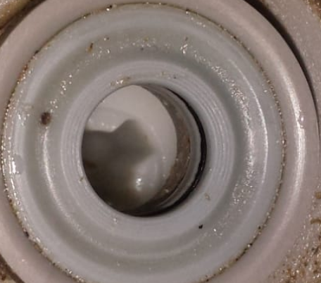

I have a bosch dishwasher that has a leak.
It looks like it is from a worn o-ring seal that the diverter motor cog slots into. You can just see the tiny sliver of a rubber o-ring. I can't think the leak can stem from any other seal. I don't remember losing a washer or anything when I repaired the mechanism.
However, it seems like this o-ring fits into a groove, and it is tiny, and probably not meant to be replaced. I probably disturbed it when i fixed the diverter valve actuator.
It has drip leaked since....and only just got round to trying to fix it.
The drip actually stops once the dishwasher heats up.
But.....assuming the o-ring replacement possibility is very low (i would probably do more damage trying to get it out) would a high tack plumbers paste work if I coated the shaft and the o-ring in it?
I have read that Molykote 111 might be the best stuff for this and will resist any washout. Are there any other pastes or seals that might work in this situation? Or might be better? Or is there a better solution?
Dishwasher otherwise works perfect, and is around 25 years old.....I'm not giving up on it now....

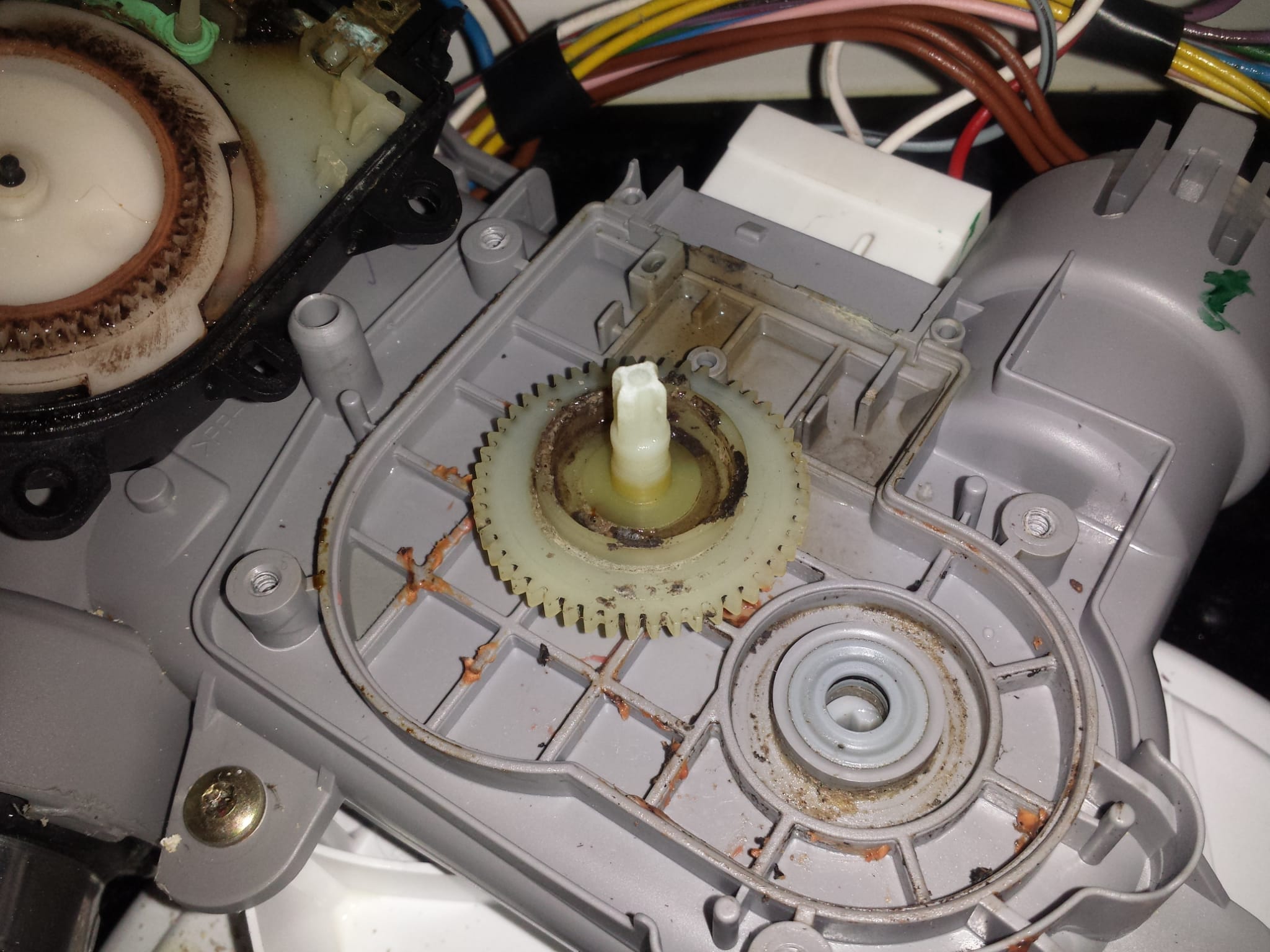

Not really into dishwashers, but if you want to keep it going is there a sub assembly you can replace can't really tell from your pic what that is. If it's a diverter valve try googling your model number to see if there is a seal or kit or the assy.
Molykote 111 is the right stuff for this. It is a silicone grease so it is safe on the rubber and it will not wash out or dry up the way normal plumbers paste would. Smear it on the shaft and the o-ring, run a couple of hot cycles and check it. Fair play keeping a 25 year old machine going.
Inspect the O-ring with a magnifying glass for any tears or nicks, bear in mind that rubber can harden/shrink/expand over time, so it might not fit as it used to.
If it needs removing, a safety pin can be used to hook it out. If Bosch can't provide a replacement (unlikely) then a specialist bearing/O-ring supplier might have one (try Orbic)
Clean away the existing grease and any debris, and regrease with your moly stuff.

In my experience, the difficulty with replacing worn O-rings is working out what size they were before they became worn.
See if you can get an assortment pack. What is the approximate size?
I'm not removing it to find out....yet.
But the internal diameter of that hole is 2.5mm, so assuming that o-ring is sitting in a groove, and some is meant to protrude, I imagine the external diameter is about 3mm.
A standard 2.5mm ID O ring has, I think, a minimum CS of 0.5mm which gives a OD of, 2.5+(0.5x2), 3.5mm.

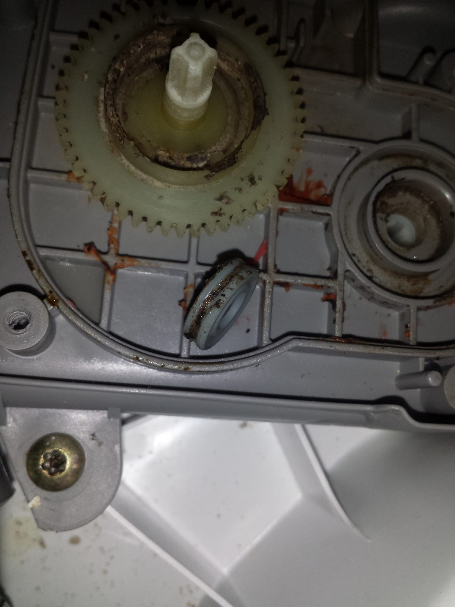

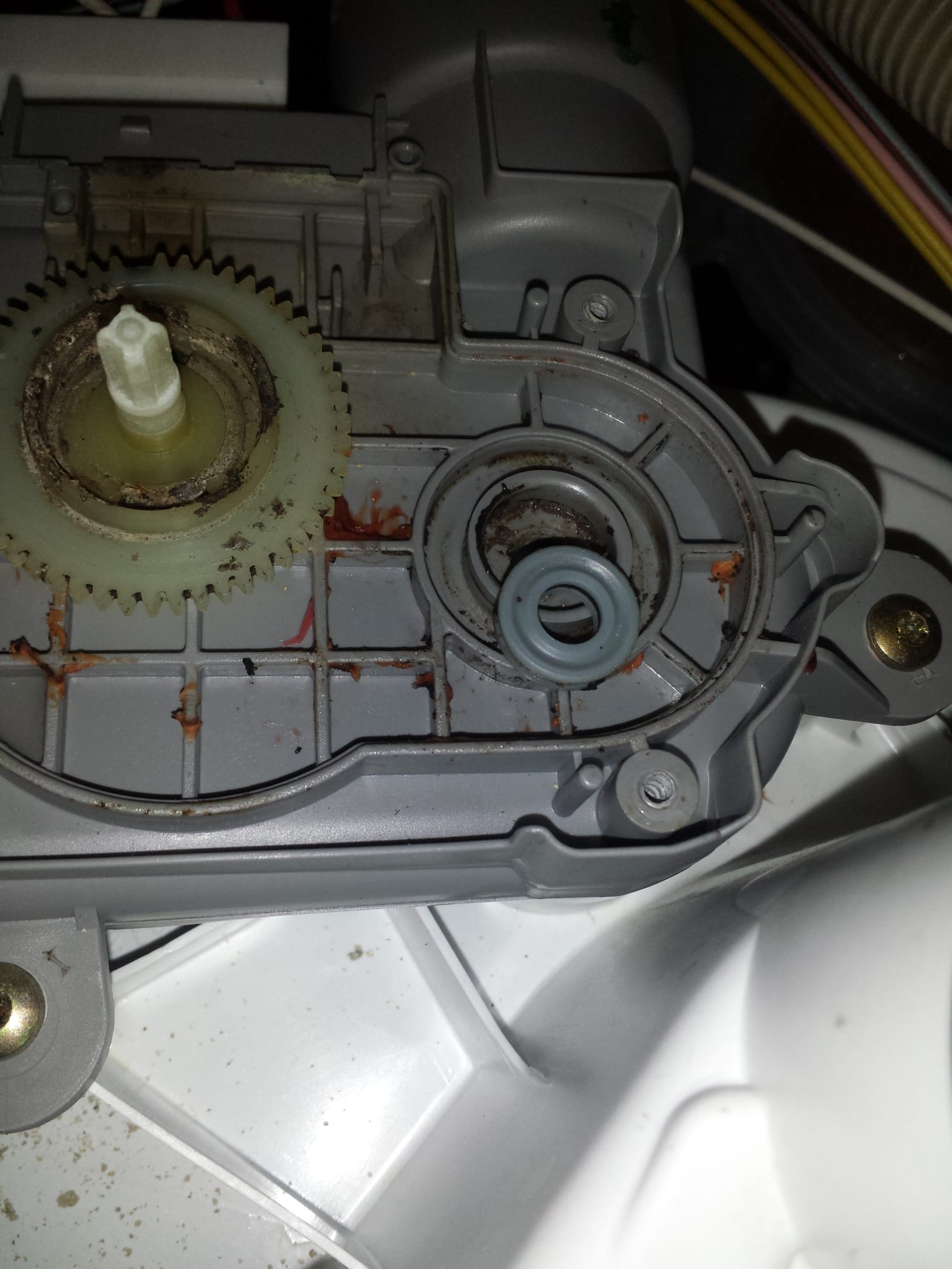

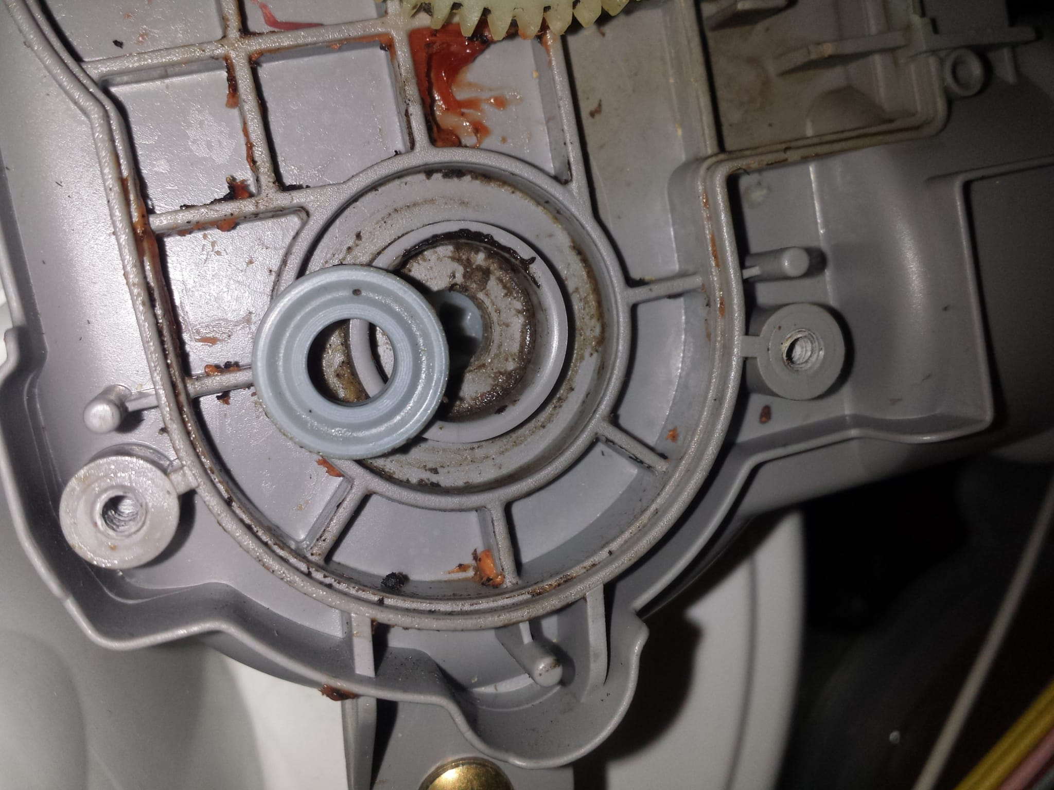

Seems the o-ring is not what i thought.....
Whilst prodding and taking a measurement, I realised that that gray doughnut was actually soft rubber. It is a chunky doughnut o-ring, not just the slim black part.
Looks like I need to work out if this is available as a spare....

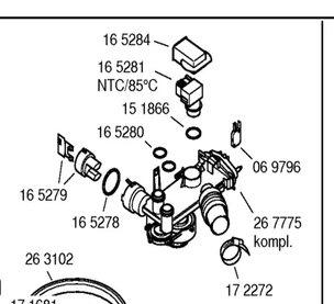

Try typing you model number into the Ranson spares search page. I have always found them very helpfulin getting parts for old machines if you can't find them on the site you might need to ring them or send them your pics. They often have excellent exploded views of appliances
Alas, I have used the exploded diagram but to no avail.
The actuator mechanism and the grommet/o-ring is the underside part of that heater unit.
I suspect because it is technically inside the unit as a whole, they do not supply the individual spare. It's considered part of that unit.

After a few weeks of pontificating, and not wanting to buy some expensive grease that might not work, i decided to try the cheapest method first and see how it went.
So some ptfe tape costing 25p it was!
First I really cleaned the grommet and seating area. It could have just been disturbed, affected by dirt and/or not seated properly when I did a repair last time. But I think it might have been dripping slightly before that.
But, to be safe i did a light wrap of ptfe tape around it's circumference(not too thick so it kept all it's groove indentations. I also wrapped a bit on the cog spindle it slides onto.
I also took the time to do a deep service of the dishwasher. Cleaned all the waste pipes and drip tray. Cleaned out the filler matrix. Also a bit of ptfe on some of the o-rings for those pipe connections too.
Reassembled.....and looks like it is working good as new!
So far, not a drip!
