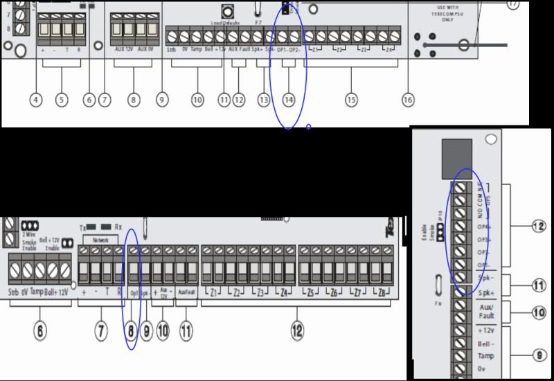

Secureiam: Where is the panel output in premier that is open collector?
The collector is one leg of the transistor. See the image below where the pull up is external to the device. When the circuit is not open collector, this resistor is on the PCB and connected to the +'ve power rail. This means that the voltage that's switched by the output is fixed and not set by the external device.
Do you have an installation manual it be easier to look on that for your panel.
if not i will dig some images out for you tomorrow dont have pc sccess at the minute.
see circled in blue the panel outputs, the wireless 12 and 24 will have OP1 only.

Thanks for that, I think I have that port on texecom premier 24, so I'll use that, what size of pull-up register I would need to bring-down the voltage from 12v to 3.3v? is there any formula to find register value?
