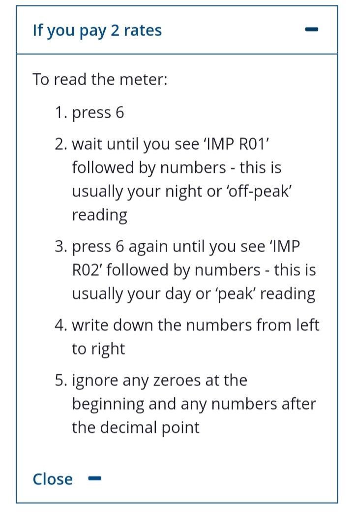

I had a smart Electric meter forced on me about three years ago. All seemed to be OK, reading the meter was relatively simple, Press 9 on the keypad and a series of readings are displayed, the first one was IMP KWH (IMP indicated Import) and then a meter reading, the next readings were totally useless as they were for Export and KVAr import and export and a few other useless numbers. Fine I thought as all I wanted was the Import meter reading. For three years I have accepted this without question. Last year I changed my supplier to E-ON, I was informed from them that as they did not install the meter they could not access the meter reading. No Problem I said, I would give my meter readings monthly. I always work my own bill out just to check on the suppliers calcs. I had a lot of other issues with E-ON, but one of the issues was that they were using a different Electric meter reading than I was giving them which I found odd, but it would all sort itself out at the end of the year as I knew exactly what I was using and therefore what I would be charged. When my tariff was coming to its end, E-ON contacted me with offers and also sent me a bill which showed less electricity usage than I had used as recorded by my smart meter. This made the estimate for my new contract to low, SO I contacted E-ON to ask why they had different usage numbers than I had on my meter. After some investigation and several telephone calls, it transpires they the can read my meters and the readings they get are not the same as I read. A complicated discussion took place which I did not understand because I have no idea how these Smart meters operate but I was told that if I pressed 6 on the meter key pad 4 times, I will see the number they use as a meter reading. This number is substantially lower than the one I get by pressing 9 on the key pad to get the meter reading.

The reading you should be supplying is the
'TOTAL ACT IMPORT', see:
https://www.citizensadvice.org.uk/c...ter/how-to-read-your-smart-electricity-meter/
It will be the same figure shown on the in-home display. The energy suppliers won't expect consumers to take a reading from the many options on the meter itself :)
Edit:
Sorry, just re-read your post. It seems as if they are asking for on and off-peak values?
Thanks RandomGrinch, the citizens advice is what I have always done to get a meter reading ie Pressing the Keypad 9 button., since transferring to E-ON, they use a reading which is not the one I see for Total Actual Import, they are using another one which is obtained from pressing 6 key, four times. This number is referred to as IMP RO1, the display then progresses through numerous other readings relating to RO2, RO3 etc to R14. This is where my confusion arises. I get no sense out of E-ON regarding this reading which is different to the one I get by using the instructions indicated by Citizens advice. I have no idea now as who to get some advice from.

It looks like E-on are taking either the peak or off-peak values for your bill. This would be quite strange if you don't pay two rates!
OP - Is this a 'Secure' manufactured meter? If so, and you do NOT have off peak, nor anything feeding in - then 9 gives you the correct number of Kwh consumed and needed by your supplier - less the number of Kwh it recorded when you last moved suppliers.

You haven't answered my three questions - Is it a Secure manufactured meter (it will say on the meter and the remote display) ?
Are you on any sort of off peak tariff?
Are you on a feedin system (solar panel or wind generator)?

1. The Meter is a Secure Liberty 100 Meter,
2. I am not on any sort Peak Tariff ,
3. I am not on any form of Feed in System

Same as my system then. E.on must have you on a wrong tariff, or have your address mixed up or meter mixed up with someone else. I'm surprised they didn't notice anything amiss when they first took over your supply. You need to get back onto them and ask to speak to a line manager to get this sorted out properly, or be faced with a massive bill when you next move. Have the meter number to hand when you ring, though it does sound as if they might be reading the correct meter, just the wrong register in the meter.
