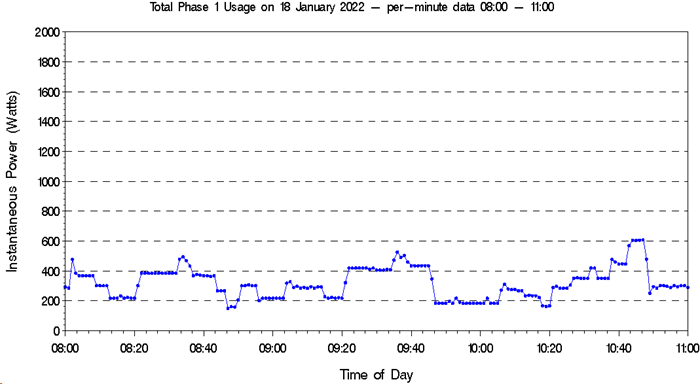

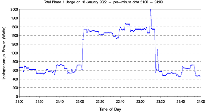

Since I haven't got a 'wired-in' monitoring system, I cannot tell you about the short-term fluctuation in PF in my installation. However, I can show you the short-term fluctuations in total consumption as determined by an assumption of a PF which remains constant (at the 'average' value) - as per the couple of graphs below from yesterday, which shows 'calculated' consumption for each minute over 3-hour periods. These don't 'prove anything', but show that short-term fluctuations in consumption (calculated using average PF) are relatively modest (and primarily due to on/off of individual loads). In the second graph, the hour or so for which I switched on 1kW worth of fan heater is obviously apparent but the short-term fluctuation during the entire period was, again, fairly modest.
