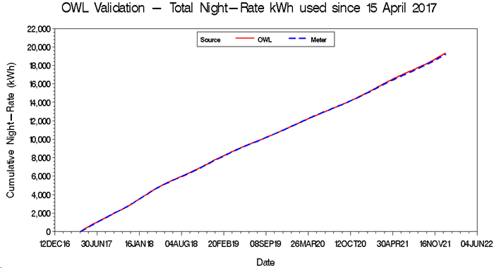

The Owl has a clamp meter and is not very accurate at low levels (a few hundred watts). And it only receives periodic signals. I have an idea that some loads, such as fridge and freezer compressor motors, are not very accurate. Larger, resistive loads such as heaters, are pretty good. ... It is surprisingly accurate above 1kW (try switching on a 3kW kettle or immersion heater).

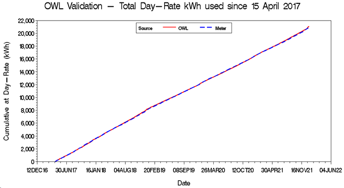

As I have previously illustrated, once I had established an appropriate 'average voltage' and 'average PF' to use, my OWL has proved incredibly accurate over the long-term.
As the two graphs below show, over the last ~5 years, the OWL's cumulative total of my usage, for both day and night, differs from the 'metred' ~20,000 kWh (for each of day and night) by only a very small handful of kWh, even though total usage is most often considerably less than 1kW (commonly around 500W). It is also very sensitive to small changes - even when the total consumption is high (say, >3kW), the effect of switching just one LED light on or off can easily be seen.

John what you have done is beyond the capabilities of the average buyer.

My first introduction to an owl was by a single female painter/decorator who didn't know one end of a fuse box from the other, one day she asked me to look at her graph which covered all of 2018 and half of 2019 with weekly readings of her mechanical KWh meter. For all intents and purposes it was a clone of Johns graph except the last 3 or 4 readings which were significantly higher than the owl... Reported to energy supplier who changed the meter straightaway and accepted the Owls results for the bill.
Yet again it's all down to learning how to use the equipment.
