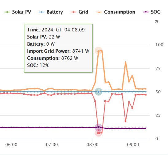

I was very interested in the gas consumption, the meter showed how much I had used, but not how much I was using, there was only one item using gas, the boiler, and the boiler could modulate (turn down) so having some think like the clamp on meter used with electric would have told me if the boiler was modulating and by how much. This would have helped setting up the central heating.
Electric is easy, plug in energy monitors, clamp on ammeters, and numerous CT transformers tells me what electric power I am using without any need for a smart meter. I can see today when I made coffee and when daughter has a shower 1704360122744.png now using oil fired central heating so the gas smart meter is no longer an option. Due to have electric smart meter on the 19th, interesting to see what it can tell me which I don't already know? I think only gain will be auto meter readings and payment for export.

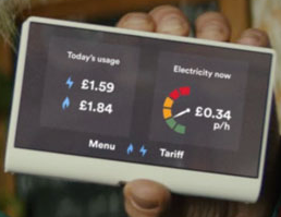

But looking at the pictures 1704360554081.png it seems it shows electricity now, but gas only what has been used today, so how that would help knowing the amount the boiler has modulated I don't know, seems the gas meter is not very smart? However neither is the electric meter really, it shows no more than the old clamp on energy monitor, but at least does show a now reading.
My display does show both instantaneous electric and gas use. Gas isn't updated quite as frequently as electric, but it is useful none the less - I can see on it my boiler modulate down to minimum, and can even check how much each ring uses, on the gas hob.
