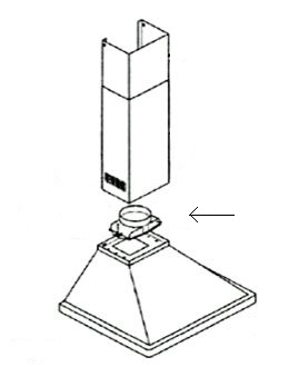

I have fitted a few chimney hoods of various makes, and all have all had a spigot that you can fit a flexible duct to. The duct is then routed to suit the application. It can be bent by 90 degrees to allow rear venting. [Mine at home is like this] or installed vertically up through the ceiling. I can't recall seeing one that couldn't be installed with a rear outlet.
Not sure if you mean a chimney hood as stem describes or an under cupboard type. They can usually be vented out of the top & have a knockout in the rear panel to vent them through the wall.
