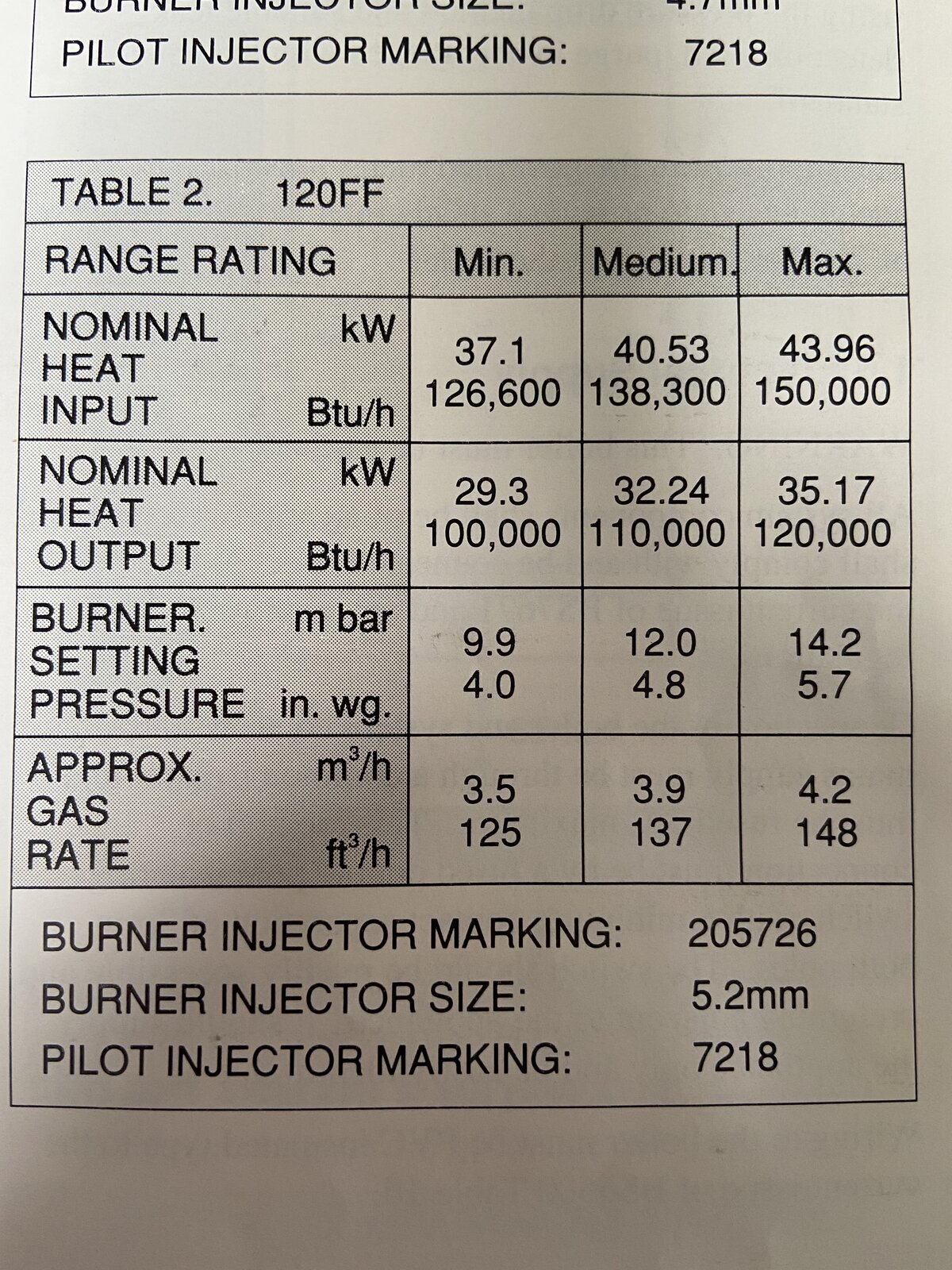

Those are minimum values. See table attached.

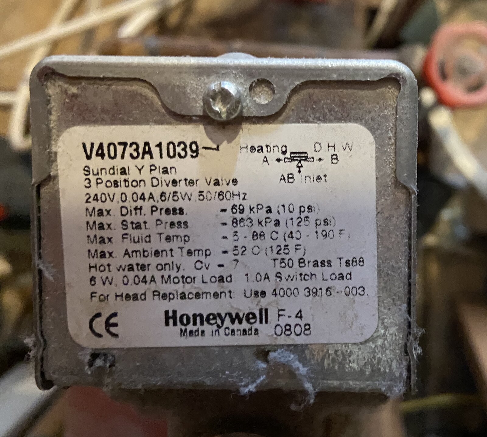

You don't say whether your 3-port valve is either/or (Honeywell W-plan) or mid-position (Y-plan). If it's W-plan the cylinder stat must be satisfied before CH is available. But that's not usually a problem. Cylinder heat loss is small if it's well insulated (preferably pre-insulated with foam) the heat lost goes into the house anyway. If it's Y-plan you can have HW or CH or both.

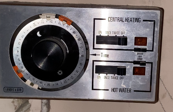

3 port valve is Y Plan. Programmable timer is very vintage so maybe this is the problem? Going to be replaced with a Nest.

It's an even higher output boiler than we thought! Do you know what setting it's currently on? I assume it doesn't have 3 switchable settings, but varied continuously by adjusting the burner pressure at the gas valve, but you or somebody else might tell me I'm wrong. If you don't know the setting it can be checked by measuring the gas pressure with a manometer. But if it's a very old boiler it could be scaled up, with efficiency below nameplate data.
Once you know the setting, and knowing whether the current boiler seems borderline, about right, or OTT, should give you an idea about what you need from the new one, in addition to a calculated figure based on property details. Sounds like a biggish place, lots of rads, but I'd be surprised if 30kW output wasn't plenty.

If the timer works OK I doubt it is causing poor economy.

The table you show is for a Glow-worm Ultimate 120FF.
So far as heating the house is concerned, the important number is the heat output as this is what goes into the water flowing through the rads. Heat input is what you pay for; the difference is due to the efficiency (or lack of it) of the boiler.
The table shows three figures, min, medium and max. These allow the installer to set the boiler to the appropriate output for the house. The chosen setting should be indicated on the data plate inside the boiler. If no indicator, assume the maximum, i.e 35.17kW.

The ultimate 120ff is 78.1
% effecient so flat out on 5 it generates 27kw of usable heat before losses.
