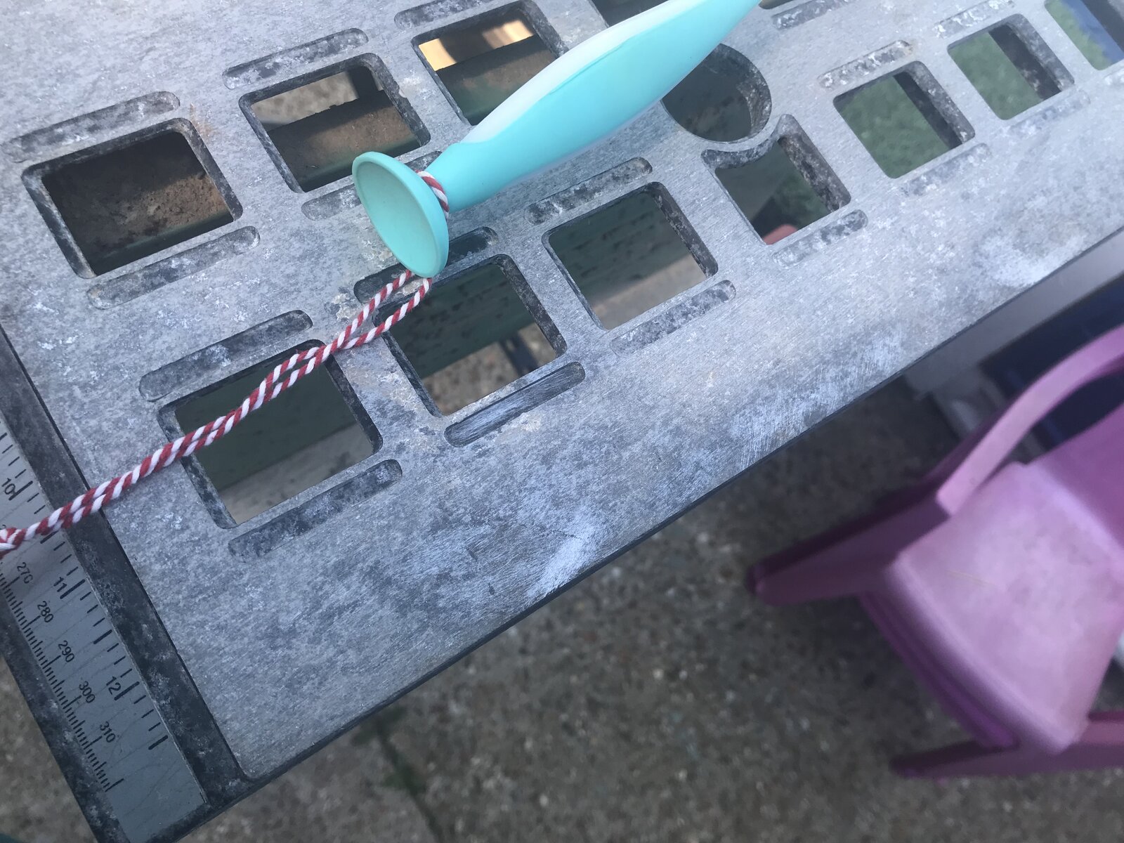

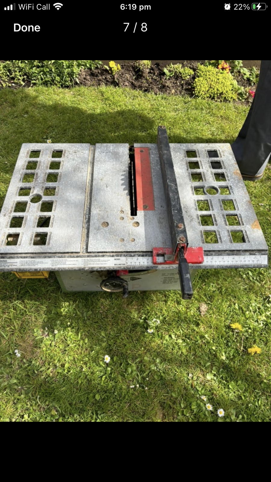

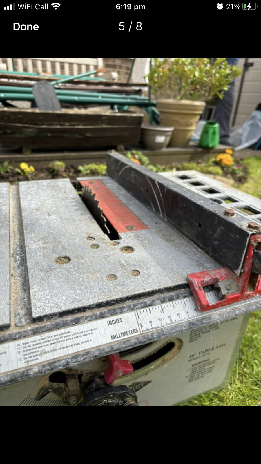

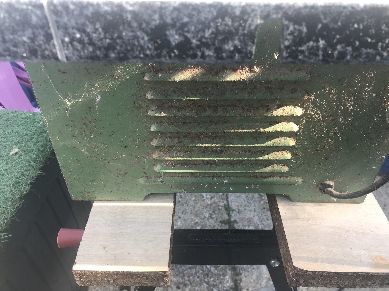

New question regarding same saw…
Images show the online listing pictures and after my work cleaning, fixing bits, and making the saw operational once again. Although not yet turned it on.
Listing pics
After cleaning etc,
I have no manual for this saw, but I want to say the top was painted all black, and the base that green colour when brand new.
I am thinking of getting something similar to the green, and hopefully get a coat of paint on rust, no need primer and completely unsure what to do with the top. When spraying the base, I plan to just tape and mark off the areas I don’t want coated, but would it be easier to paint it if I can take it all apart? I am mostly talking about the inside areas.
