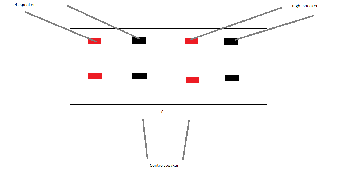

Finally decided what to go for. I decided to use one of my spare amps -- nothing special, just a bog standard Realistic STA-720 from ~1981.
I bought myself a Cambridge Audio SX-70 centre speaker as space-wise it works, and it also gives a good all-round sound output. I was also lucky to be given two Cambridge Audio Aero 3 speakers which although designed for use in a surround sound setup, do work really well combined with the SX-70. The Realistic amp can handle them as it has four channels.
My only question is how to wire in the centre speaker. Obviously the left and right speakers have four wires (meaning two into the left channel and two into the right channel on the amp). However, the centre speaker only (being a single speaker) has two wires -- where do these go in the back of the amp?

It has a 'mono' button, so I believe you can bridge a set of speaker connections for a single speaker, but I will have to investigate further!
...and it means the Aero3's will also only have a mono output.
There are simple ways of just connecting a single speaker, but there is likelihood of damage to the amp, or speakers. Not best practice!

Edit: another thought, although a shame after choosing the SX-70; maybe swap it for a powered subwoofer? The output could then be nicely matched to the Aero3's - there's no guarantee that would happen with the SX-70 :oops:
...or just get another SX-70! ;)

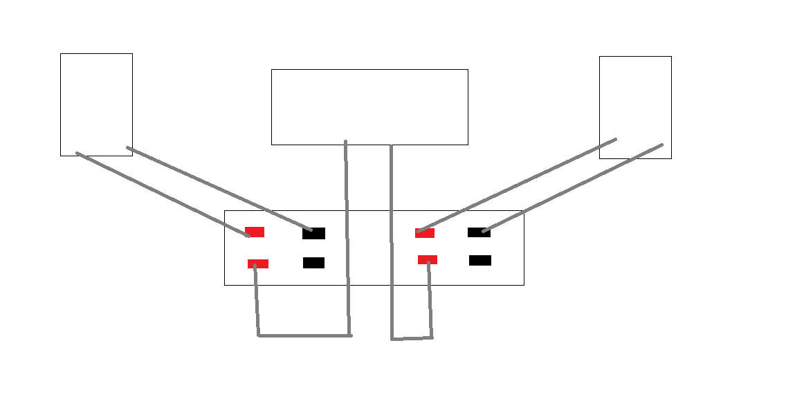

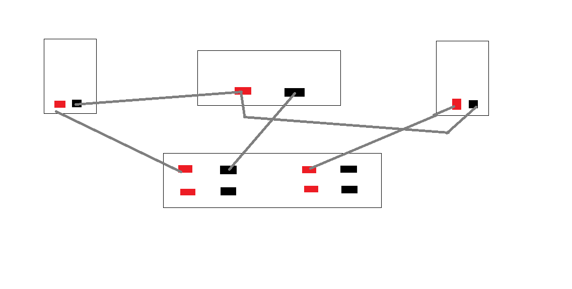

It does have a mono button yes (useful when playing some records from the '60s where there seemed to be an obsession with vocals in one speaker!). Unfortunately I can't get another SX-70 though as there isn't room -- it just works mounting the Aeros on the wall and the SX-70 on a shelf.
Would either of the attached two options be work? Option 1 is a setup I think was popular in the 70s (just not sure how effective it is) and the other is one I found on an audio forum which still gave the user stereo output. Again, please excuse the shoddy drawings on MS Paint!

I believe option 1 will 'work' - caveats:
The schematic shows your speaker outputs are paralleled, so the speaker impedance will effectively be reduced; your amp is capable of driving into 4 Ohms, so 'should' be ok!
Keep the volume down to start with! ;)
The centre channel will receive a mix of the stereo signals, with some parts just cancelling out. What you receive through the speaker will not be 'everything', from both stereo channels. More like a sort of centre 'effect'.
As there is no way to independently adjust the volume for the channels, whether the output volumes from all the speakers match, will be down to luck! :)

The only other option I can think of; separate the speaker connections within the SX-70, and feed the speakers independently?

I'll give option 1 a go when it arrives and see what it sounds like... really I'm just after more 'ooomph' and bass/lower frequences which the Aero 3s don't give on their own. They are great for clarity (I'm hearing backing vocals I didn't even know were in some of my library!) but not so great for things like the deep synths on some stuff.
I do like the idea of separating the two speakers, just means trying to open the speaker case up neatly. When it arrives I'll have a look... would be a neater install and would mean the amp is properly powering four independent speakers through four independent channels.
