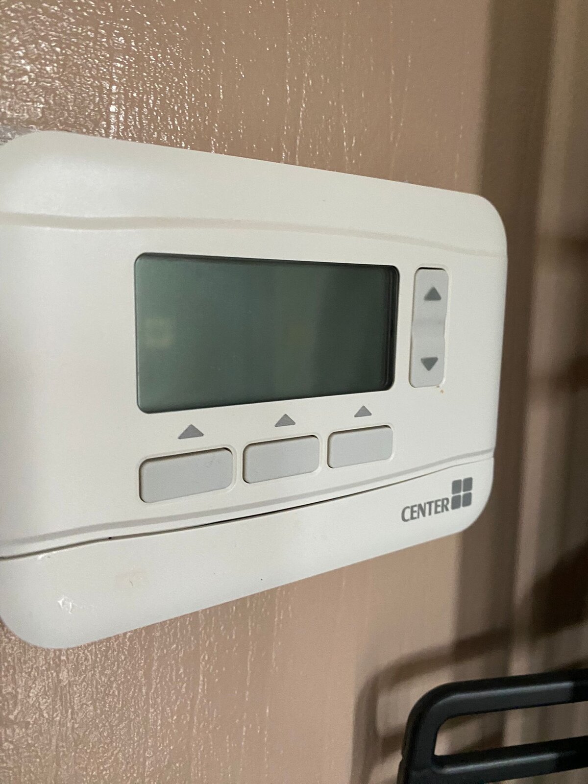

I have Center RF Wireless Transmitter (340017).
Its been turning On/Off for few weeks. Changing batteries won't help.
I think I will have to get a new one.
Any recommendations to replace this thermostat with a new one so it can work with my old receiver? (Transmitter and Receiver were installed just over 2 years ago)
Would I have to get the same transmitter or are there any other better alternatives?

That unit is mage by Honeywell for Plumbcenter
get another from Plumbcenter or get a wireless Honeywell programmable unit.
Both will come with BDR91. Remove existing receiver and fit new onto the backplate or bind to old receiver
When you say turning on and off, do you mean the display disappears and comes back? If so, try gent pulling the battery tab on the right hand side out a little bit.
In the battery compartment bend the contact tab out a bit failing that have a look at esi one about 60 quid and easy to use and set
