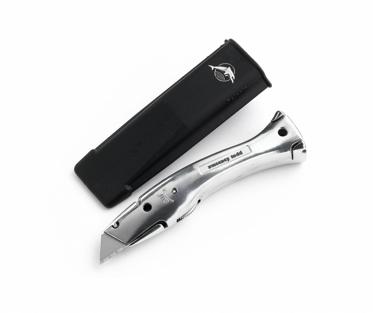

Many flooring fitters I have worked alongside seem to favour a knife called the "Dolphin:

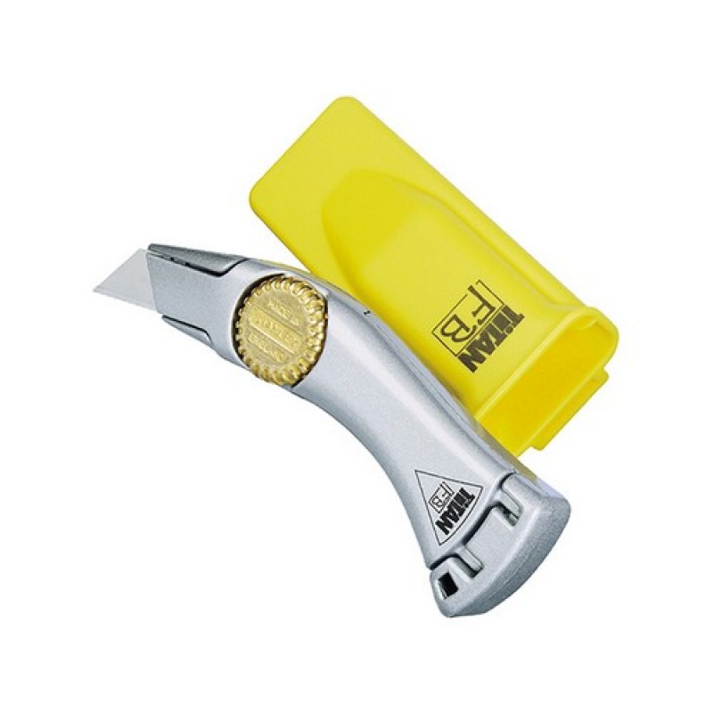

They cost about £12 to £15. If you've ever seen a Stanley Titan knife:
in fixed blade, retractable blade or even Fat Max (retractable) varieties:
you can pretty much guess where Stanley got the idea for the shape from. The shape of the Dolphin (and Titans) means you can apply more pressure to the cut because your hand is at a more comfortable angle than it would otherwise be with a conventional straight utility knife. It also makes it possible to pull the knife backwards towards you with much less risk of losing your grip on it. The Stanley Titan knives share the angled grip but aren't quite as easy to grip and pull backwards (but being more mass market they are generally cheaper, and they are good general knives)
