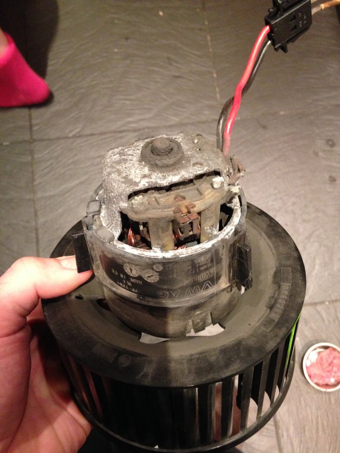

The fan in my Golf has packed up (2006 GTI). Replacements are expensive because it has the climate control but if you strip the unit down you get to a motor that's very hard to turn.
What sort of place would be able to fix this? Auto electrician? Tool repairs?
Any recomendations in the Rochdale area?
Id just bite the bullet and buy a replacement, they are not terribly expensive and do a lot of work as the climate is on all the time in most modern cars. Ive brought a few back to life by oiling the bearings but they have generally gone again within a few months.
Should it have got corrosion like that in normal use? Maybe your heater plenum drain is blocked with leaves?
They are £230 new and £70 on e-bay for a 10 year old one.

I'll try and free it up but when I put a battery to it nothing at all happened.
It does look like its been damp, I didn't notice before you mentioned it Dave. I'll have a look under there too, could save the replacement going the same way.
Rochdale ReTool gave me the number for Rochdale Motor Rewinds, he said to drop it off and he will have a look to see if he can repair it. I've had a google and its a VALEO 698812, used in many cars, I could probably get one easily enough from the scrappers if it cant be reconditioned.

Check also the brushes are in contact with the comm, a good spray of electrical cleaner is good around this area to get all the excess carbon out.
I didn't get chance to call into the place so ended up getting one from e-bay for £38.
Works a treat :)
