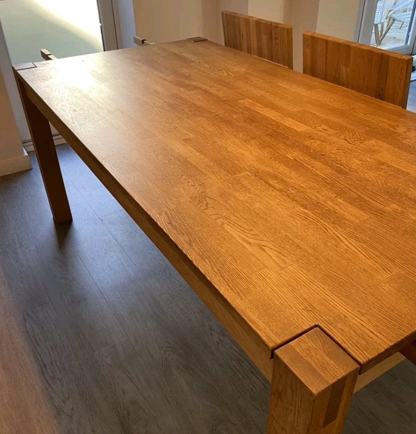

I need some oak for a few projects, short boards around 4-5" wide by about 1.5" thick.
I'm thinking of buying a used oak dining table off eBay and cutting it up. I have a bench saw, plunge saw, router etc so I'm happy with cutting and putting a simple bevel on it but I'm not sure about finishing the cut edges, will it just be a matter of a quick sanding and applying the new finish (probably a clear varnish)?

Yes, those tools will work fine.
Oak is hard so you need sharp tools and using a router or bench saw you need to plan your cuts so you can avoid stopping as theres a risk of burning - and it’s very hard to sand out.
for end grain, just cut with a sharp TCT blade then sand
regarding finishing avoid polyurethane varnishes they can look plastics on oak, maybe use polyx oil
