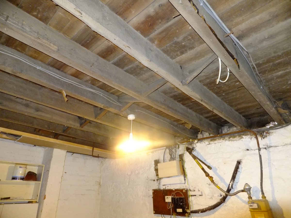

Damp along the front wall and the party wall just behind the door.
Damp surveyor has recommended an "effective dpc" and the ground level be lowered to at least 150mm below the inside floor level or a stone filled soak away. Gas mains runs 10cm below the joist level. The joists sit in the masonry unprotected.
Would it be a okay to take up the flags to the right of the doorway carefully dig out around the gas pipe and fill with gravel to a lower ground level. Ive been looking at French drains but I have no idea of where or how to funnel the water as the reduced ground level will be lower than the drained footpath on the other side of the wall.

You need to use stones at least 1" diameter for a french drain rather than gravel. the gravel will fill with dust and dirt, and then you're bridging water across again. As long as you did down to bare earth, then any water will just drain into that. Injected DPCs are old hat, and I don't know how well they'd work in stone - if at all. A dryrod DPC, or silicone injection into the mortar is more common nowadays. You'll definitely need to take the plaster off and let the wall dry out, but I expect you'll find it's a solid brick wall, so you may need to batten the wall internally, and then use plasterboard - even though this wasn't the original design of the property. And that's the odd thing about the setup; was the gas main installed with the property, or afterwards, and how far out from the wall is it. If you expose the gas pipe whilst you're digging the french drain, then you need to find some way of supporting and protecting it.

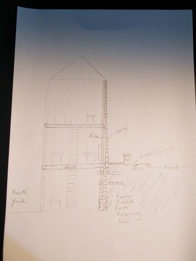

Do you know what a section view is - could you sketch one of the area in question from cellar floor to FFL?
Yes I am buying this property. It looks as if the first houses don't have basement floors as you go further along the row the houses start to cut into the land and the houses start to have basement floor.

The house is on a slope, therefore you are fighting against the water table as it comes down the slope.
Your basement walls seem to be relatively damp free - some staining in a corner.
Membrane, pump & sump (draining to the rear) would be the way to go for any refurbishment.
Probe the joist tails with a small screwdriver - are they built in or are they sitting on a brick ledge?
I dont think that much useful could be done at the front - perhaps a couple of air bricks, & removal of the sand and cement fillet.
The interior damp plaster could be removed and rendered back in lime and sand. This will give you a say 20yr breathing space before damp salts appear again.
Nothing you show above would be a cause for concern - the house is what it is.

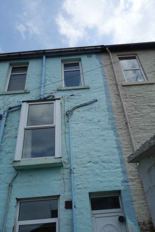

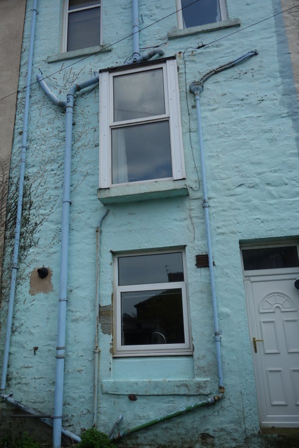

Mr A, going back to the airbricks in your OP, as the rear of the basement backs onto the yard, do you have airbricks in this wall.
On the other side of the staircase(rear of the Property) on the lower ground floor is the kitchen and it doesn't have air bricks built into the wall. It does have a vent sucking air out of the kitchen though and a vent that looks to line up with the combi boiler. It has one air brick at the top near the roof. Looks to be redundant drainage pipes and aweful paint make the house look abit of an eyesore.
So the backdoor leads into the basement, and am I right in thinking it's fairly dry then. The combi boiler is getting it's fresh air from the outside, but you'll need fresh air in the place. Rather than airbricks, I'd suggest trickle vents on the tops of the windows
The kitchen is drylined unsure of the method of tanking if it has even been tanked the damp/timber surveyor was unable to test as it would have meant a destructive test. The stairs run through the center of the house, to the eye the rear basement room(kitchen) looks fairly dry. But the earth retaining side of the house has some water ingress to the right hand party wall where mortars been forced out.

Leave the air brick in the rear of the basement - its a basement, there's a chimney flue needs air, and dry lining in a basement might have been done as a method of dealing with damp.
Through ventilation from front to rear is also needed.
