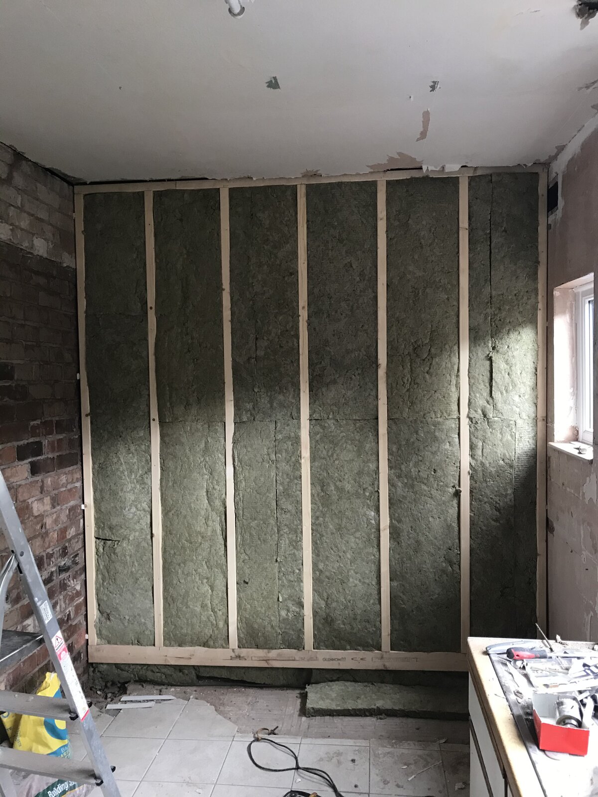

2 kitchens back onto each other either side of this wall:
I want to reduce the noise and plan to build a frame from 2x2, spaced 50mm off the wall, fit a full layer of 50mm acoustic slabs behind it then a further layer between the wood.

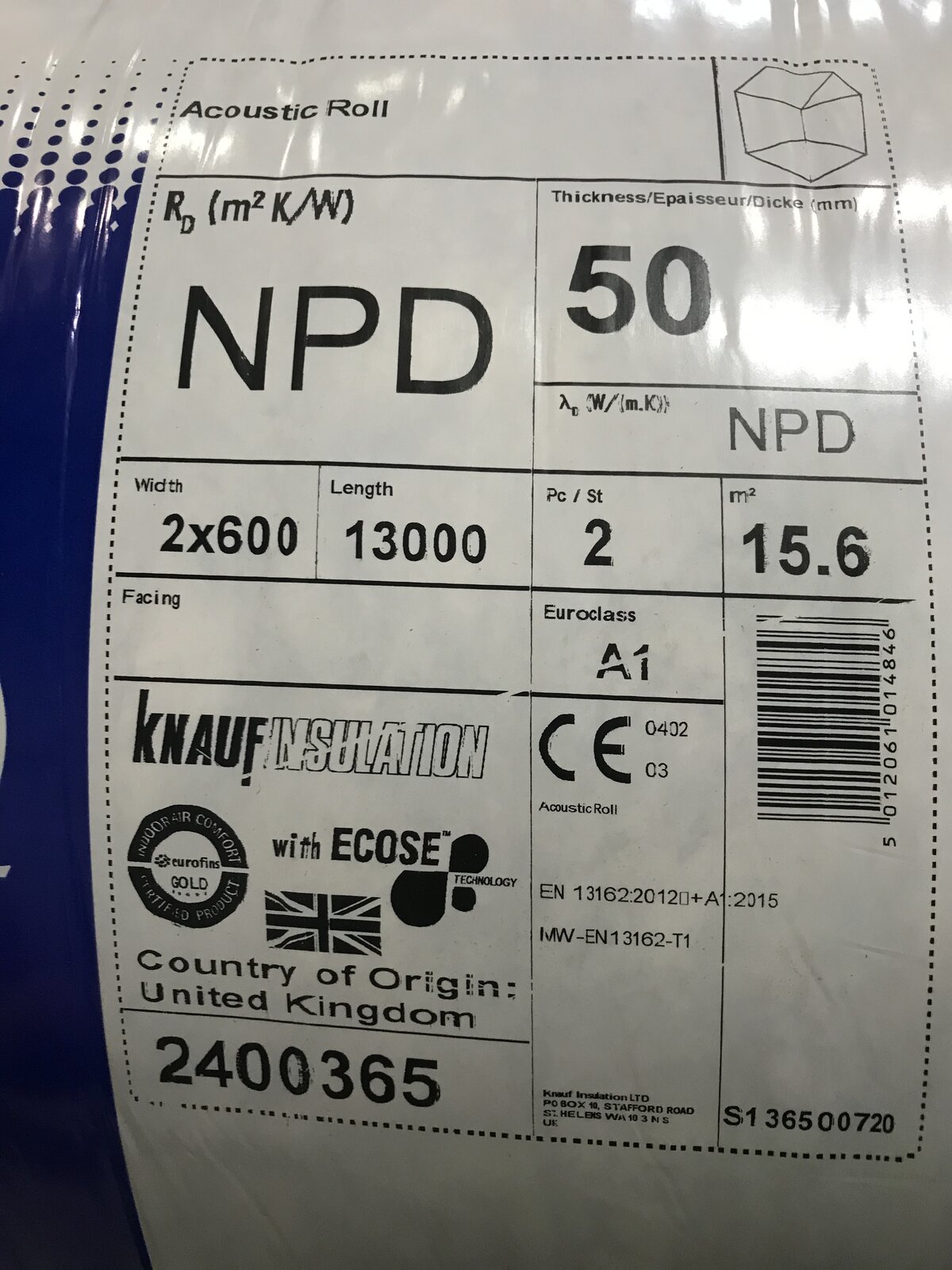

I went to get some Rockwool RWA45 today but was told that that will reduce noise but it’s not specifically for sound. They recommended this but I couldn’t see its weight per meter:
Can anyone recommend a product?

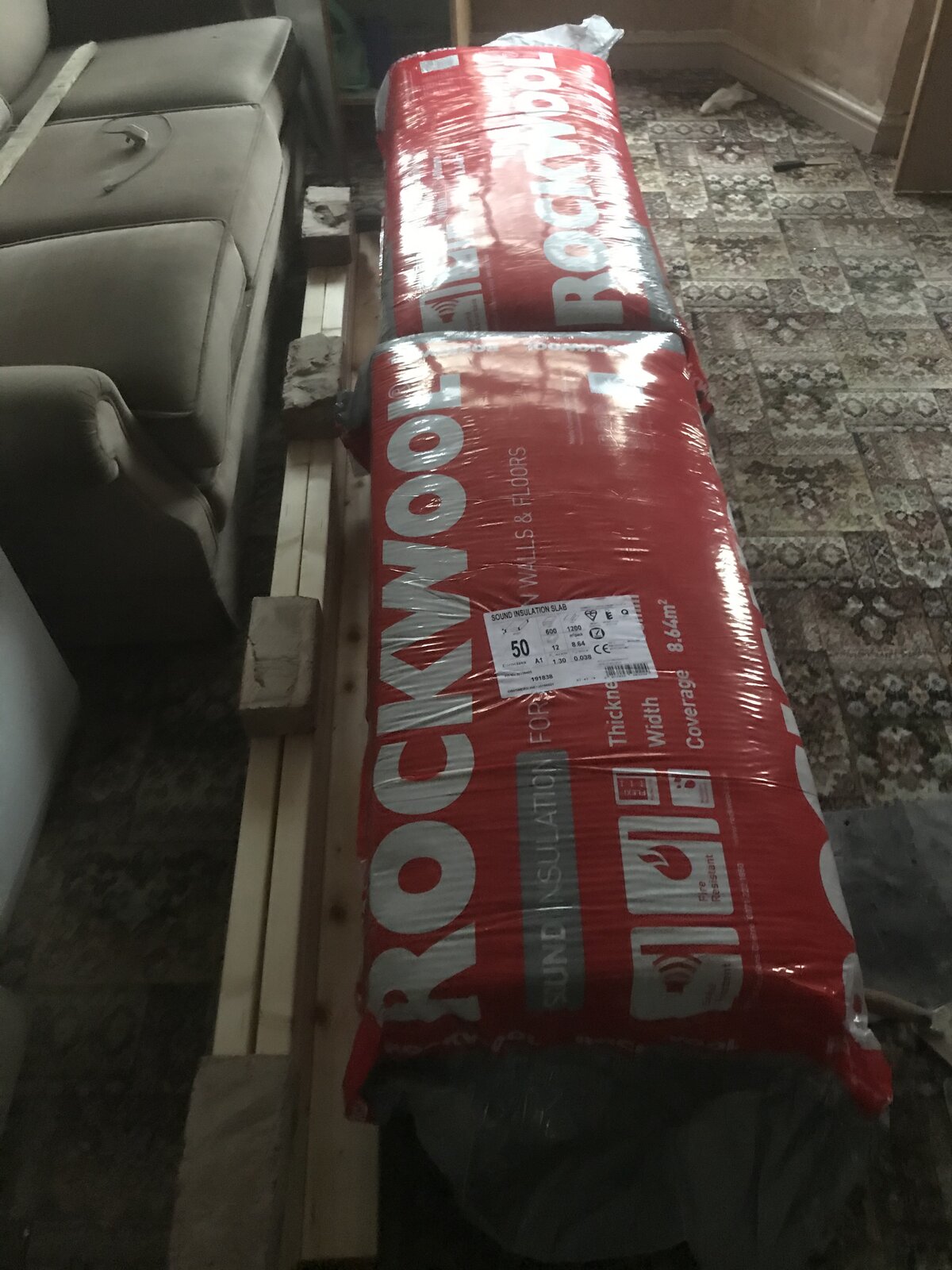

I’ve seen Rockwool RWA45, RWA3 and Rockwool Sound Insulation Slab (which sounds ideal)
I had a read up today and chose Rockwool Sound Slab, seemed heavy at 60kg/m3.
So now I plan on actually doing the job.
Where I fix onto the walls at the sides should I put rubber washers between my wood frame and the brick to seperate them? Same for into the joists at the top?

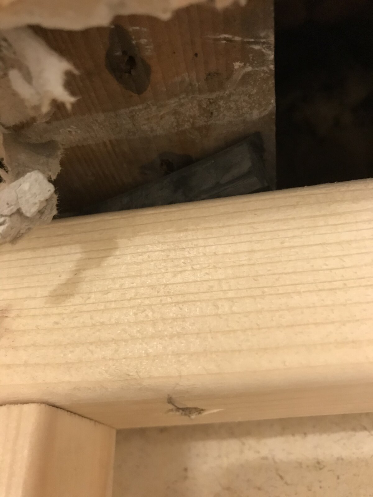

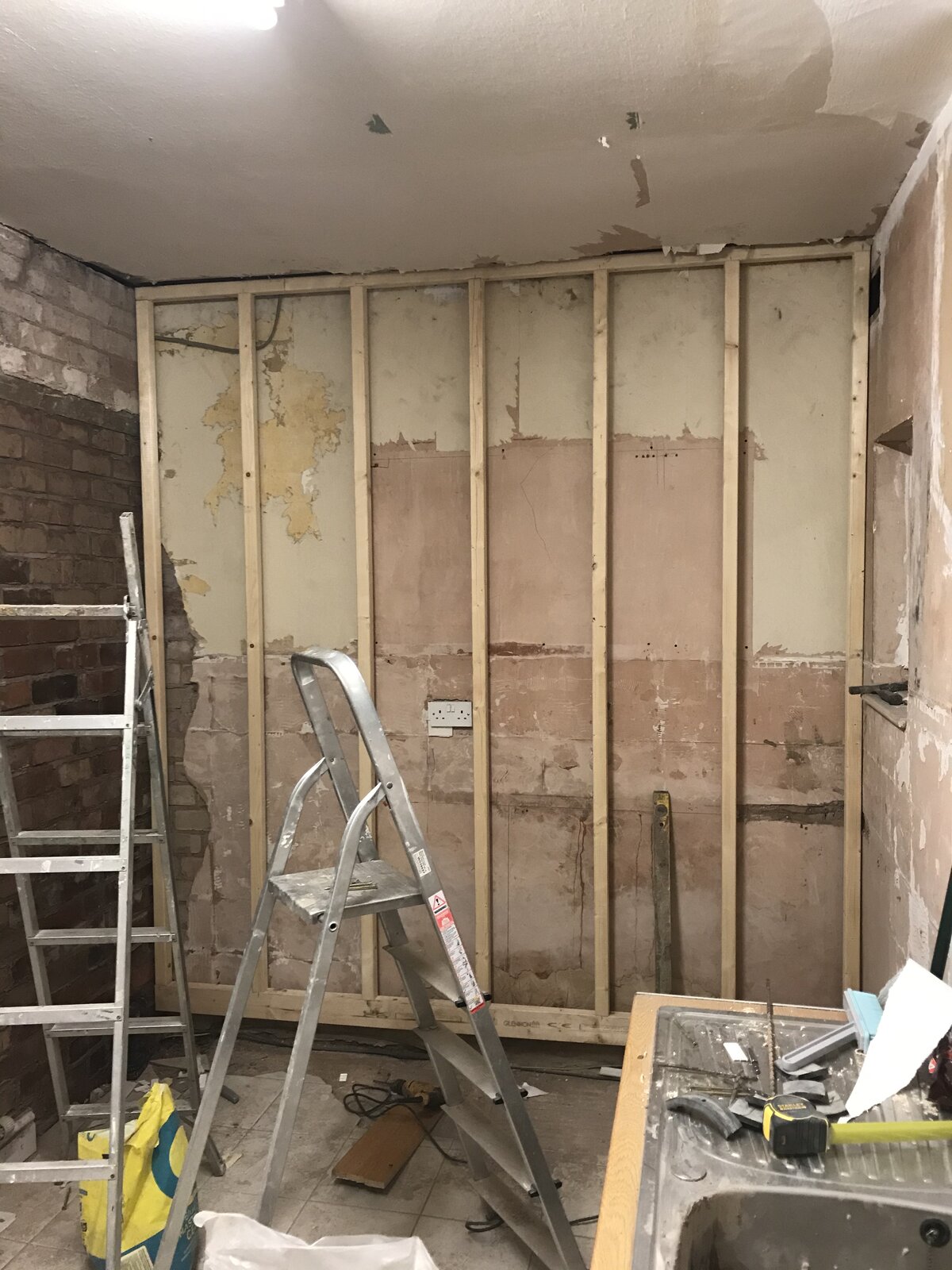

I made the frame tonight. Daughter pulled down the first 6” of ceiling and mortared all around the joists and filled any holes, then we made the frame and fixed it to the ceiling joists through some thick rubber that was a bandseal I had that was missing it’s clips.
Had to stop because we didn’t have a 6mm masonary bit to fix the sides.
FWIW I did something similar on a party wall and my experience suggests/was:
  • The soundslab you have is def better then the acoustic roll which I don't think is dense enough in this application.
  • I used foam tape (resilient foam/strip) around all perimeter timber to try to de-couple a bit from the brick/floor/joists - your rubber might achieve similar - might depend how solid it is.
  • I also heavily caulked around all perimeter timber with AC50 before boarding (on the understanding that any gaps, e.g. between timber and the wall would allow sound through and detailing is important).
  • Fit soundslab or rock wool good and tight between studs on the same basis - i.e. any gaps will allow sound through.
  • Board with acoustic plasterboard if you can/don't mind - it is denser than standard for same thickness.
  • I AC50'd plasterboard joints and perimeter as well - not sure this was necessary but no harm done.
  • I used a single layer of PB because I was trying to limit overall thickness of the studwall and just stopped at that but in reality another 12.5mm would not have made much difference to thickness and may have improved soundproofing even more. If I did it again I would use two staggered layers room permitting.
  • I also put rockwool in the ceiling void between joists on the basis that this was still party wall.
Effect-wise I would say my approach muffled normal tv and talking type sound from a level where I could hear it without trying to having to tune in to pick it up. So basically made the noise much less intrusive.

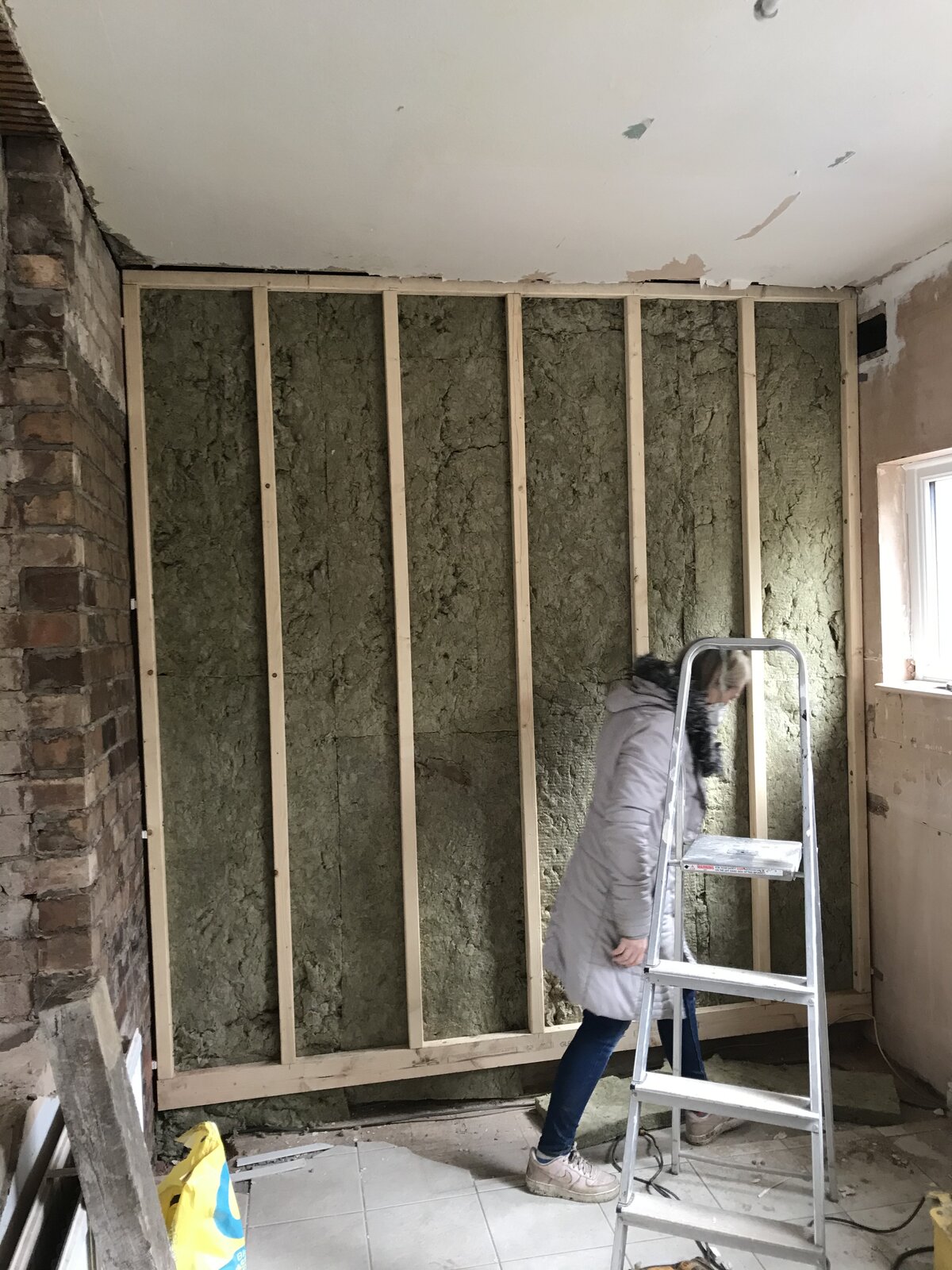

This is where i’m at as of now:
I’ll use the AC50 you recommend around the timber and add some more slab in the ceiling against the party wall (y) The bathroom is above so I will go fully under that to muffle fart noises :LOL:
2 sheets 15mm dbcheck board is standard spec. You will get a slight improvement of you fix the boards to resilient bars. I would also squirt acoustic foam in every joint around the stud framework. The rule is 10% gaps allows 90% sound transmission.
