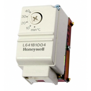

My boiler (Valiant Ecotec Plus 630) fires up at night despite the timer being off. The boiler only heats for around 30 seconds, then displays S07 (pump overrun) for 5 minutes before shutting down. 45mins or so later it’ll fire up again and the process repeats. This only happens during cold weather.
Although the boiler is within an inside cupboard, my hot water pipes run through an unheated garage and I am 99% sure a pipe stat (Honeywell L641B1004) attached to these pipes is responsible for the call for heat. The pipe stat is set to 5c. There’s no frost stat, only the pipe stat, although the boiler does have built in frost protection.
The boiler firing up annoys me as I can hear it from my bedroom, especially the vibration of the pump running for 5 minutes just as I’m drifting off to sleep!
I’m guessing that what’s happening is the pipe stat calls for heat, the boiler heats and circulates water, the hot (/warm) water quickly reaches the pipe stat and as the stat is set to 5c it equally quickly terminates the call for heat. The pump then runs for 5 minutes as per the default setting for my boiler. Does that sound right?
Any thoughts on what can be done to stop the boiler from firing up in this way, or is this just normal operation that we need to get used to?
Sounds entirely plausible. One option would be to disconnect the pipe thermostat and risk the pipes freezing. 5C isn't much above 0C so it must get pretty cold in your garage, therefore I would imagine that could be a distinct possibility without it.
I don't know where you are in the UK, but most of the country will be above 5C even overnight this week, so you should get a good nights sleep for the next few days at least.
An alternative would be to electrically trace heat the pipes where they are at risk and then remove the pipestat.
I don't think pipe stats are particularly accurate. I would put a thermometer you trust in the garage to see how cold it gets. Mine never seems to get below about 7C. Is this the pipe stat and does it have those same settings?
I would disconnect the pipe stat and add as much insulation as you possibly can, to the pipes in the garage.
Your boiler's built-in frost protection, should be enough, with those pipes insulated. It may not entirely prevent your boiler firing up, but may reduce the incidence.

Thanks all for the replies. It does indeed look exactly like the device in your picture @MNW67.
Calling the room a garage was a bit generous tbh as it's entirely uninsulated and not fully sealed from the elements. So I imagine things do get pretty cold out there! I'm nervous about turning the stat down due to the risk of freezing, so I like the idea of using a thermometer to compare the pipe stat against the real air temp. If there's a big difference would it make sense to get a frost stat installed? My understanding is there's only a call for heat if both the frost stat and pipe stat trigger?
