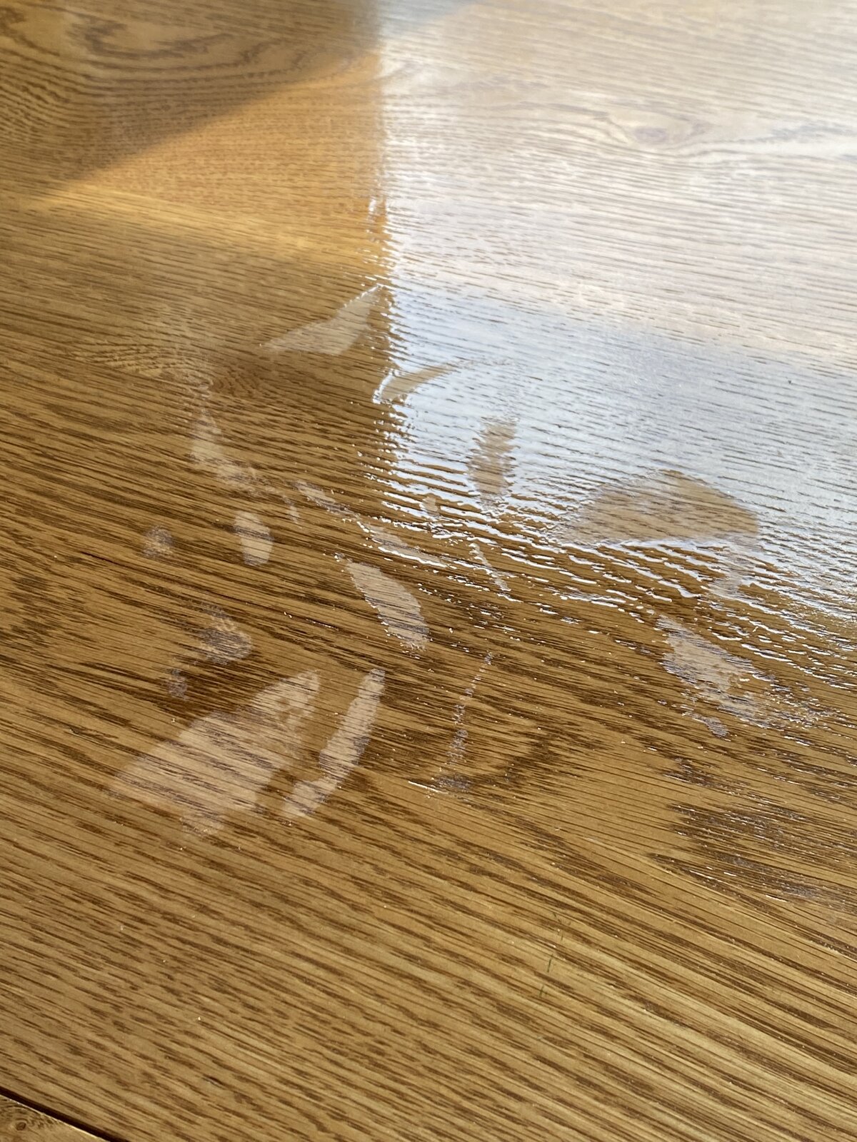

So clearing out the garage last night and I found some ink stain remover to remove the stains as per this thread:
https://www.diynot.com/diy/threads/refinishing-a-table-top.524049
It worked remarkably well but alas it has damaged or impaired the surface which is now sticky. In addition I left the cloth on there and section has no lacquer at all (see photo). The stickiness has resolved in some areas overnight.
What’s the best way forward?
Some sort of varnish stripper?
What can I use to relacquer the table? It’s veneered but underneath is solid oak.
If it has gone sticky then the finish probably isn't a varnish (in any case true varnishes haven't been used commercially for a century or more). Your finish can obviously be dissolved by something in the ink stain remover, but what? (Is there an "ingredients list"? on the pack?) Odds are that the solvent will be one of these: MEK, acetone, cellulose thiners or xylene. Match the solvent and you could clean off all of the finish and refinish the top. That is probably going to be easier than attempting to patch finish a small area

Thanks J&K. I found this
http://www.cloverchem.co.uk/2013/sds/en/712_inkov_sds.pdf
Which states the main ingredient is 3-Methoxy-3-methyl-1-butanol. Googling that tells me it’s an alcohol based solvent and that’s the limit of my Google-fu.
I still have loads of the product left so I guess I could keep using it until I’ve removed the original finish. What would I then use to replace the finish?
It sounds odd but we normally cover the table with a clear plastic sheet (I think PVC) to protect and maintain the table surface.
Found the CoSHH sheet. It says that the active ingredient is 3-Methanol-3-methyl-1-butanol. My chemistry isn't quite at that level, but what I find by Googling is that MMB (the short name for this) is an alcohol-based clear, water-soluble liquid. Makes me think that acetone (as found in nail varnish remover) or IPA (isopropyl alcohol) or failing those MEK (methyl ethyl keytone) might be a suitable solvents to lift the residue. I'd start with acetone (try a small area first) because it is relatively cheap and not as harmful. MEK, on the other hand, is nasty stuff and both it and IPA are highly flamable and evaporate quickly if the top is left off the container for any length of time

I have the feeling that the solvent action of MMB isn't sufficient and that you need to get rid of the sticky patch by using a stronger solvent. After that I think your best bet is either to strip the entire top and refinish it whole, or possibly to contact Konig UK to see if they can advise on a suitable repair lacquer from their range for a patch repair. The Konig stuff is used by invisible repairers, but it often requires an air brush or small spray outfit to apply
This all sort of underlines what manufacturers say about trying any solvent or cleaning chemical on a small, discrete area before going hog wild...
