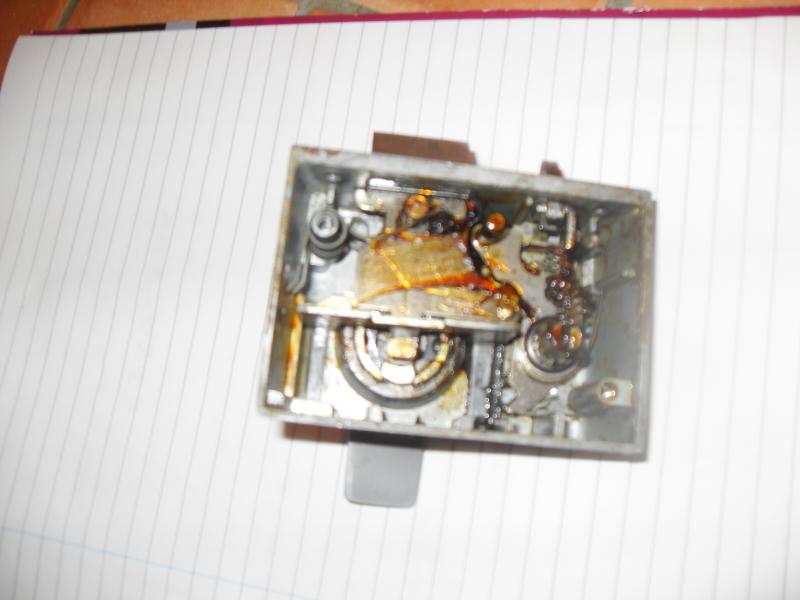

Hello,
I am having some difficulty with a Yale door lock. I removed it to see if I could fix it. The issue is that the brass part (that goes goes into the door frame) slips forward when the door is left on catch, meaning that if you use the catch with the door closed (while you are outside), you can get yourself locked out.
Anyway, I took the lock apart and have tried to put it together, but I can't see how to put the spring back in.
I have looked elsewhere on the internet and found nothing that helps me.
I have attached a photo to this message. I know that the spring sits on the right side of the photo.
Hopefully someone can help.
Thanks for reading.
View media item 49869
put the spring onto the little peg right hand side,the little part of the spring needs to be inserted then the large part pulled round so if fits into the recess on the brass snib.very hard to explain.do you have any other yale type locks,or ask a friendly m8 or neighbour?
Took a close up a bit blurry of a similar lock although not the same as yours but you get the idea, on top left, spring on the cam pin and the longer spring lenght in the guide of the latch and the other end against the lock body, all locks are difference but the idea is the same

Unfortunately I am still struggling to fix this. I have attached a new photo that shows how I currently have the spring positioned. It is tense against the brass part (which goes into the doorframe) but it is not pushing it back when the handle is released.
I have also attached a photo of the spring I'm using. Does anyone know which way this needs to be fitted onto the peg?
Thanks for your help!
View media item 49904
View media item 49905
the end has broken off your sping.
somebody might have a spare, otherwise, cut your losses.
you might get a free used lock if you ask on freegle., or very cheaply on ebay (sometimes with a free door attached)
yours looks like it might be a 50mm case, they are hard to come by, 40mm and 60mm are more common (measure from the edge of the door to the centre of the keyhole)
You can retain your existing cylinder and keys

the spring might have been broken before you took it apart. It certainly looks broken to me as the short arm is so short.

Not sure if the spring is broken, how long is the shortest length? You have to flip and force it back against the lock body for the tension before putting the rest of the spring on the cam pin, however looking at the locks link by John will be a better lock than the one you have.
Hello,
The short piece is about 7mm. When I've tried to fix it, I've been putting the spring coil on the peg first. Should I be doing this the other way round then?
Which way round should the spring go onto the peg?
