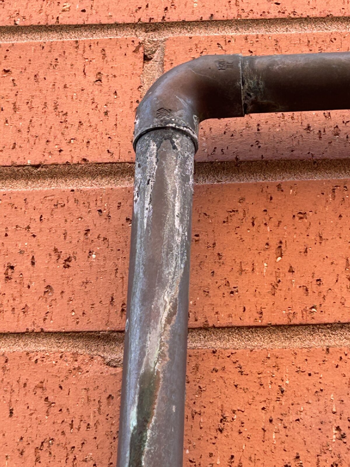

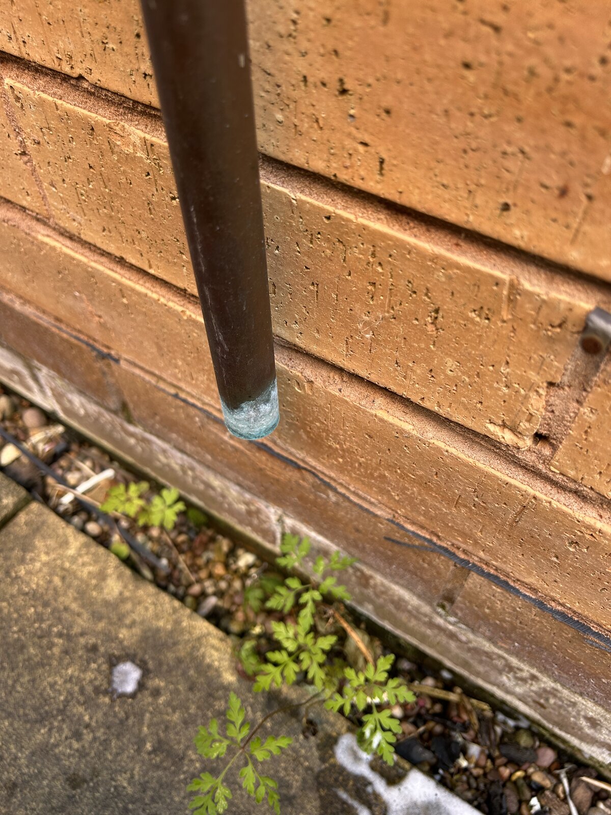

Relief pipe from storage tank weepage ?
2 Dec 2018
243
12
Hi All
My relief pipe from my storage tank goes outside on the 1st floor and down to the ground, I can see marking/weepage on the pipe. photos attached doe that means I have a problem with the tank ?
Presuming that's from an unvented Hot Water cylinder (UV)?
If so, as suggested, you need someone qualified to work on that stuff. If it is a UV, get someone qualified in to service the unit and point that pipework as an area of concern to them at the time.
