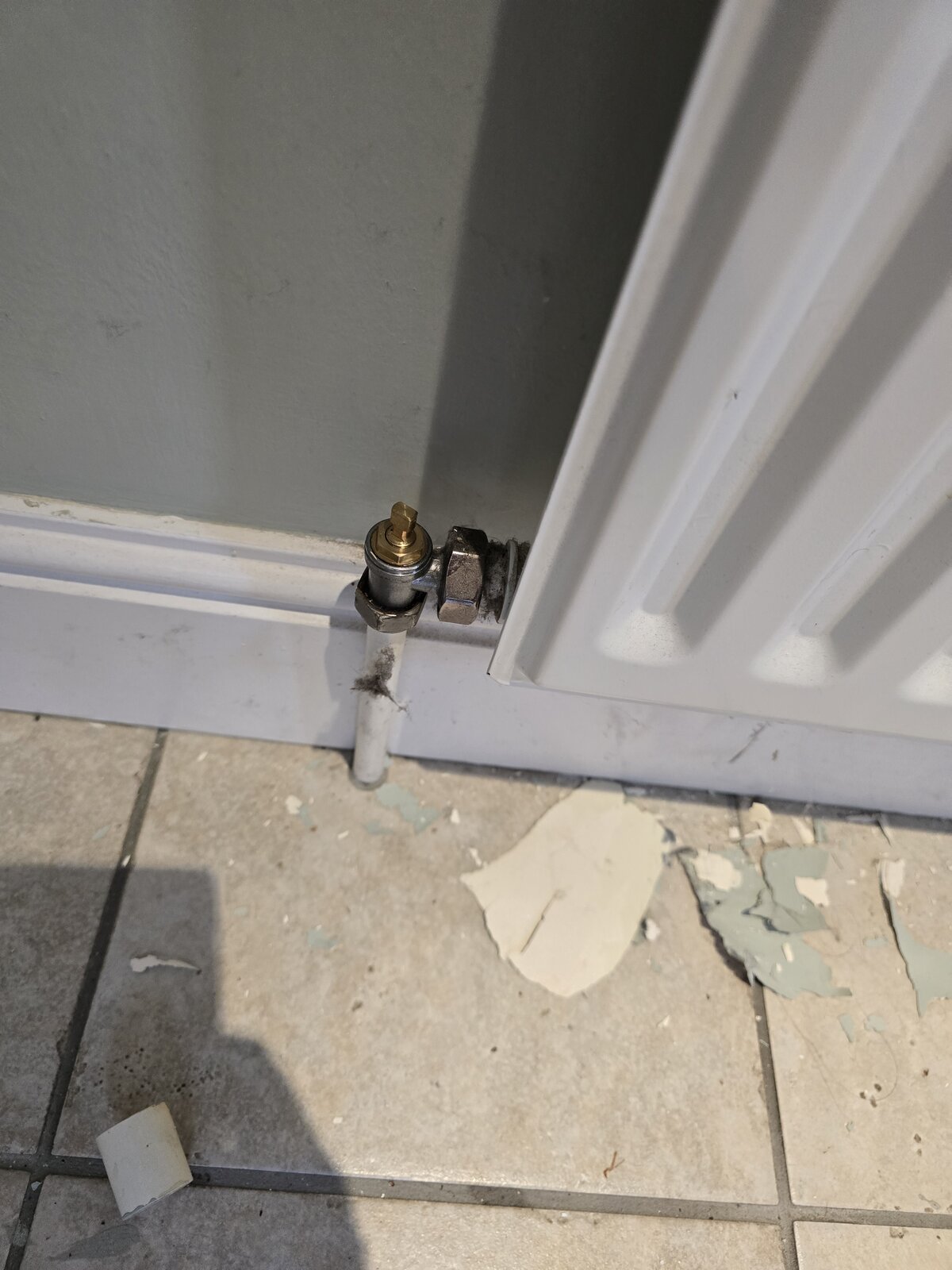

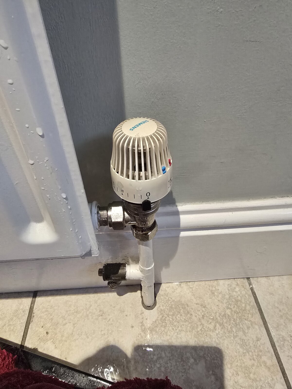

Hi there,
First time doing this, and trying to learn.
Attempting to remove a radiator with no bleed key.
I have isolated the valve on the left with a spanner (it's now tight), and closed the thermostat on the right.
I have attached a photo - the 'drain valve' below the thermostat valve drains if the thermostat is on 5 or 0.
Trying to drain the radiator by loosening the horizonal nut, and the amount of (clean) cold water is excessive, and the pressure isn't reducing.
Have I missed a step?
Should I expect the water to run fpr a long time with some pressure?
What am i doing wrong?
Thanks in advance.
Look behind the radiator there will be a pladtic round cap and once you’ve taken that off a bleed valve
But this isn’t needed to remove the radiator. To do that..
You may need to unscrew the thermostatic head and screw on a cap or simply find a way to keep the pin pushed in.

The “drain valve” is to drain the system. Not the radiator. Once you’ve isolated the radiator by closing each end you will need to drain the radiator into a pot or bucket by opening one end. Once it feels like most of the water is gone. Open the other end and more will come. After maybe 5 mins it will be empty.
The valve below the 'stat is for the system water, if the valves are completely shut, using that drain cock will not empty the rad, just the rest of the system. Slacken the big nut on the left hand valve while keeping a baking tray under it (baking tray should be shallow enough to fit under rad), water will come out, but should quickly stop if the valves have shut off. Have some old towels handy to soak up any water.

I ran the water out on the left hand side, below the thermostat valve, and above the system drain for perhaps 15 minutes. The water was clean, cold, and kept a constant pressure. I was expecting the water to slow and the pressure to dull, it didn't.
Should I be thinking that the thermostat valve isn't closed?
Also, it's getting late, I have stopped the job, opened both valves and put the heating on. The radiator heated immediately. Is this a sign that one of the valves we filling the radiator whilst I was draining it?

Well one of the valves isn't working so assuming it's the radiator valve you need to remove the top control section of this via the knurled nut holding it in place and replace it with a capping piece that holds the thermostat pin down

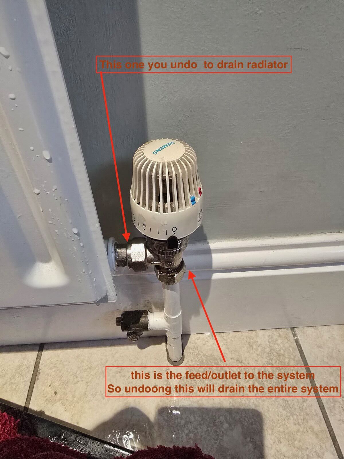

if thats what i think you mean - then you drained the system down - not the radiator at all - if off
see image with annotation

so that maybe an issue - if it pressurised or if just gravity feed - then the header tank in loft may have topped up

Yup - in your photo the TRV is on the right, and the lockshield one is on the left.
But then
But anyway - whichever side, if you loosen a valve where it joins the pipework, you'll drain the entire system. And if it's gravity fed and you've not turned off the feed to the header tank or tied the ball valve up, it will drain forever.
Yes, the horizonal valve to the left hand side of the thermostat (not the valve on the left of the radiator)
There IS a tank in the attic, yep. However, I thought if I isolated the radiator using the valves either side, than that would isolate everything? No?

If you close both radiator valves the radiator can be drained by loosening the joint/s where the valve connects to the radiator. A receptacle will be needed to contain the water.
As others have advised ,the drain cock below the TRV will drain the system ,and not what you want.

If you can lift the radiator enough to get it off the bracket, you can loosen the fittings a tad and hinge it downwards. You'll get some water coming out until you tighten them again, but not a lot.
But that said, if you remove it completely, you can take it outside, shove a hosepipe into it, and give it a flush.
