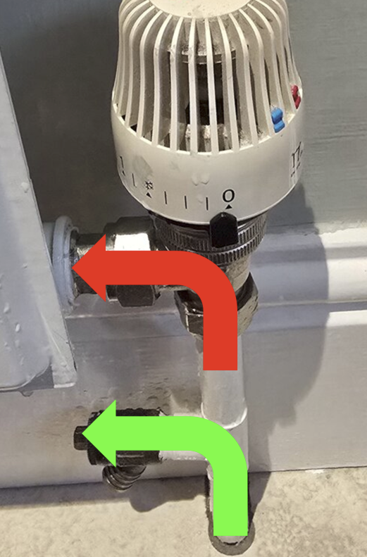

Yes, the horizonal valve to the left hand side of the thermostat (not the valve on the left of the radiator)
That's the drain point for the entire system. Is it/could it be the lowest point in the pipework?
There IS a tank in the attic, yep.
A big one, or a small one?
However, I thought if I isolated the radiator using the valves either side, than that would isolate everything? No?
It will isolate the radiator.
It will stop water flowing along the red path into the radiator. It will do nothing to stop it flowing along the green path out of the drain valve.
