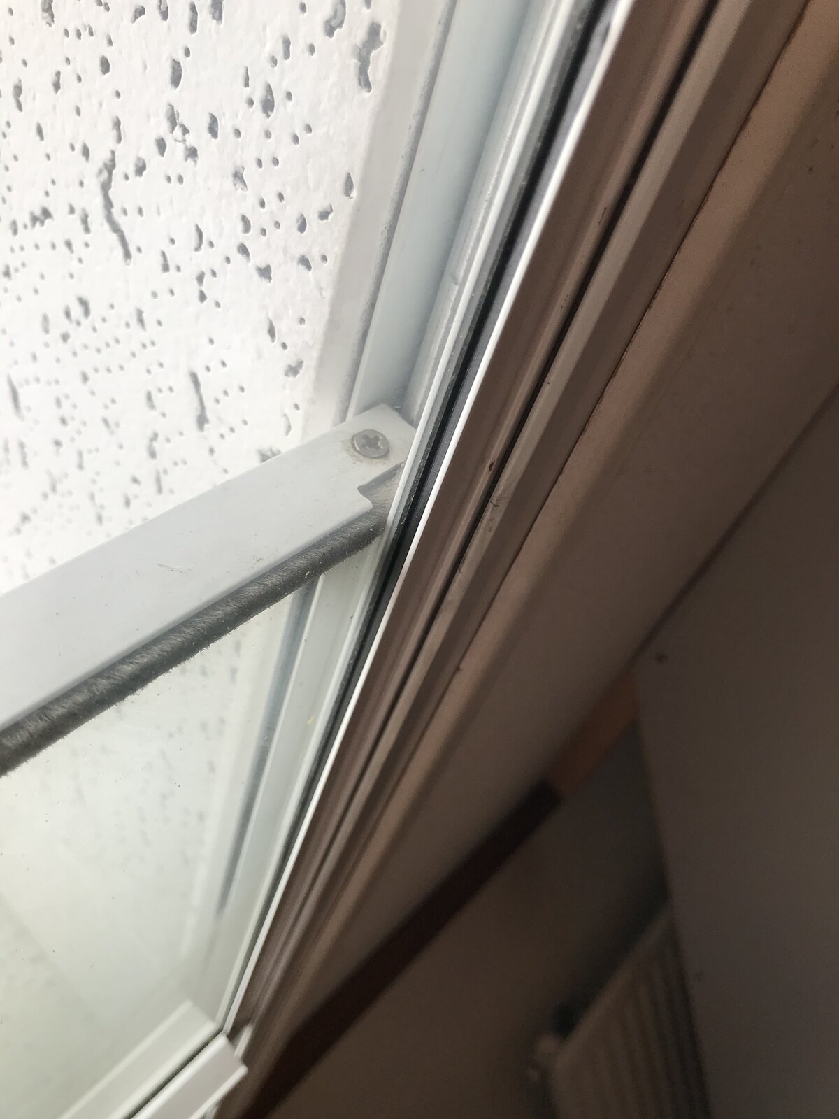

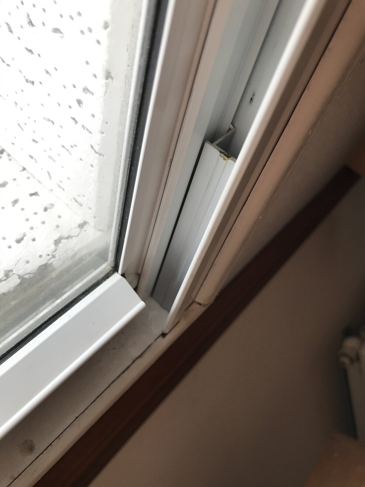

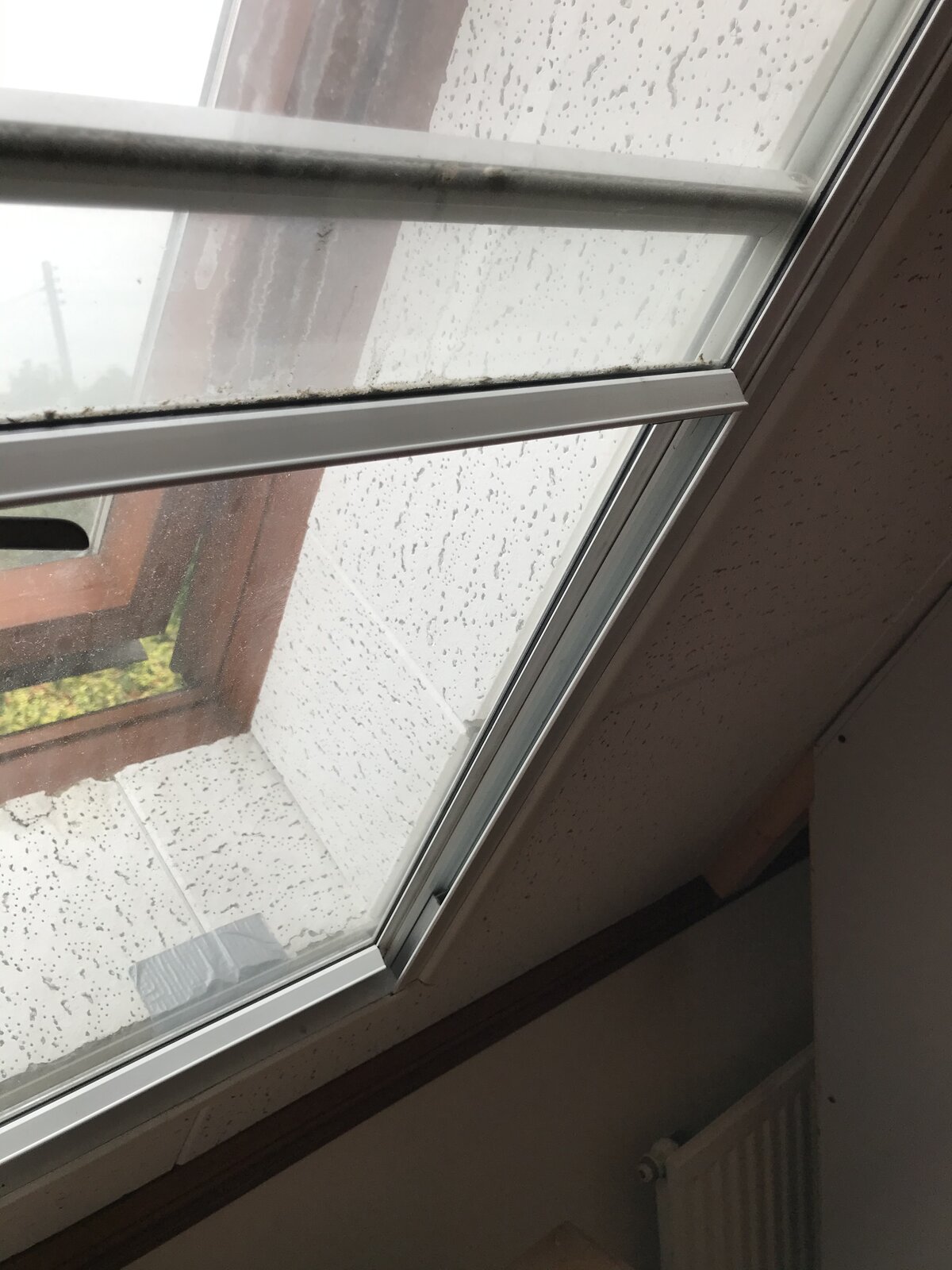

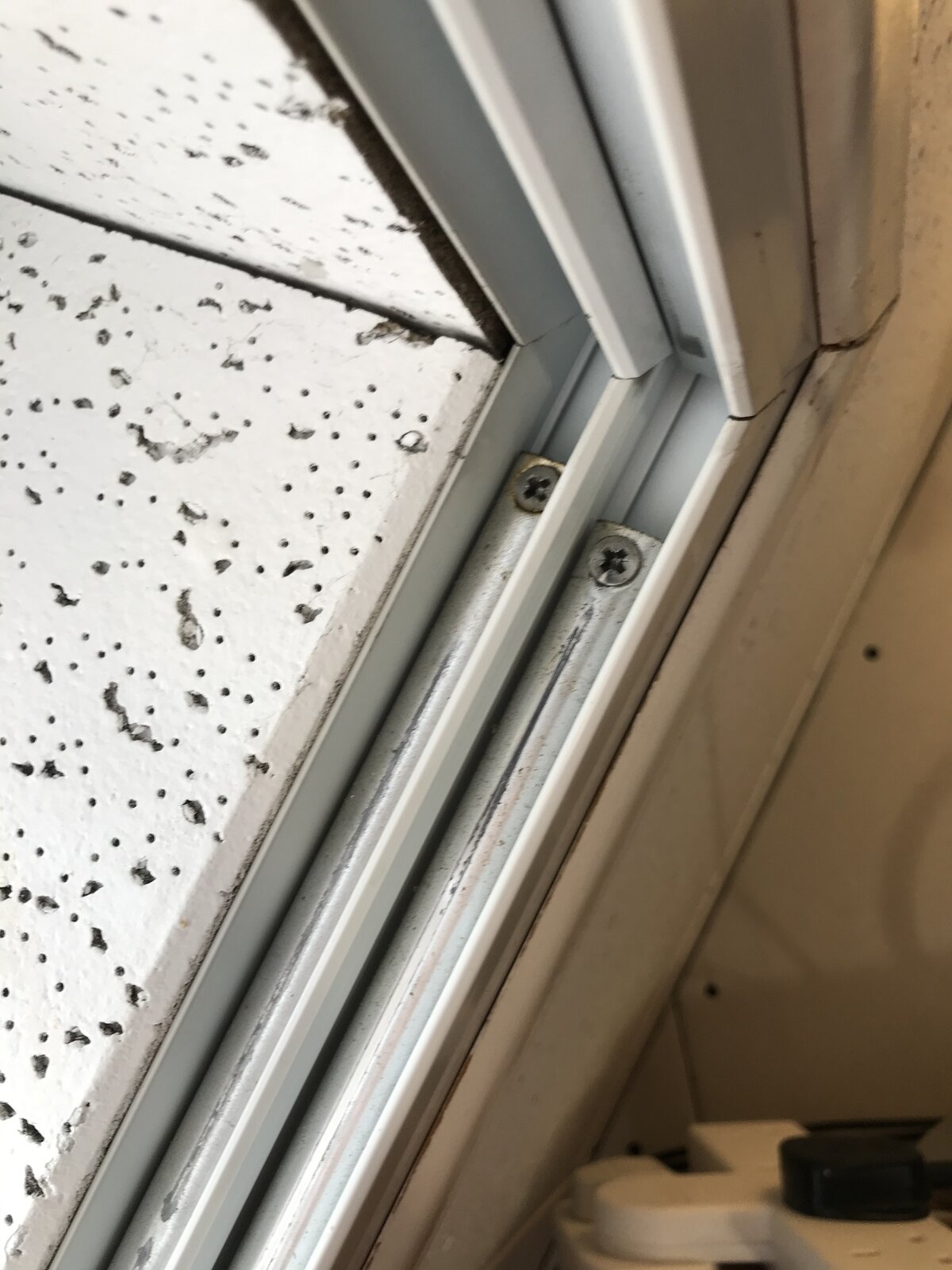

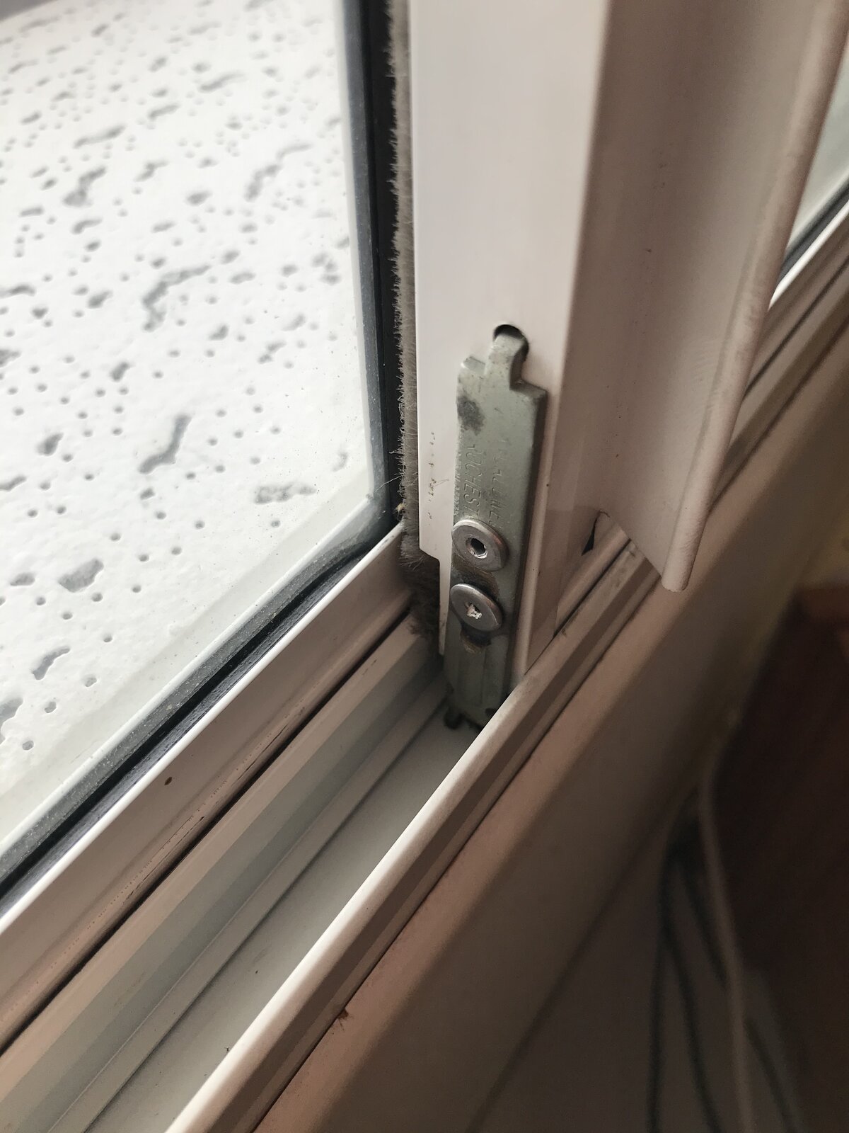

Removal of secondary glazing.
hi all, I’m trying to remove some secondary glazing with a view to re-fixing it but cannot work out how to get the pains out of the channels. Attached some pictures can anyone help please many thanks

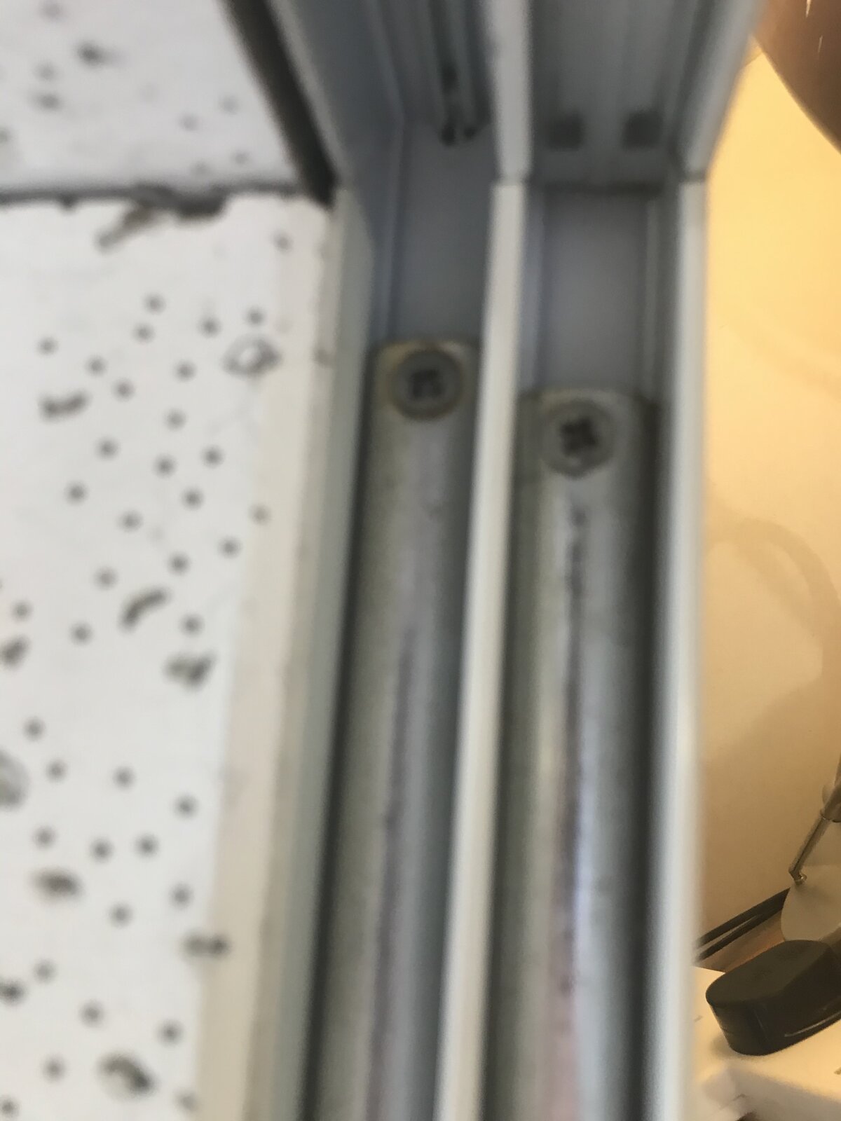

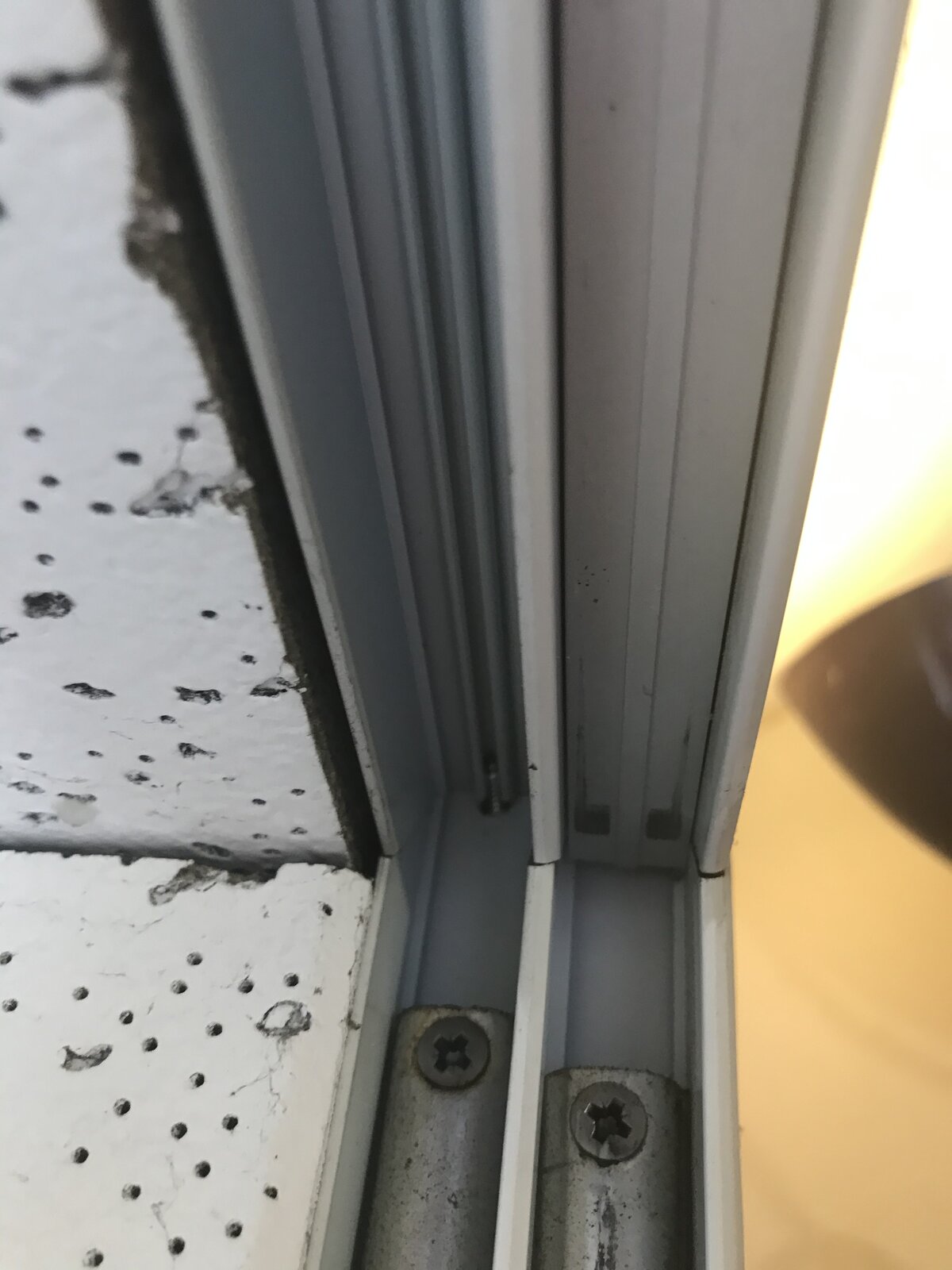

show us the upper parts of the channels, with the sashes pushed down.
I undid one of the screws which allowed the spring to move downwards but still does not provide enough width to move the glazing out Sideways ?

bit confused here
normally secondary glazing is secondary to the main glazing :D
i cant see the main glazing in any pictures :rolleyes:
aahh ok scrub that first picture window the other side off the reveal
suspect the whole frame comes out as one including glass unless the top channel is deeper allows the glass extraction individually easilly or by loosening brackets on the slider to allow extraction
