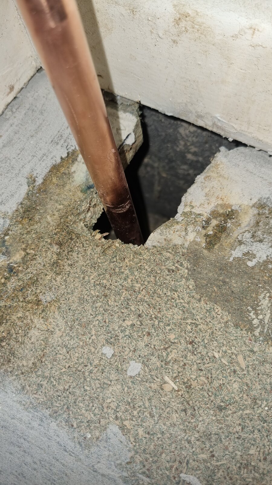

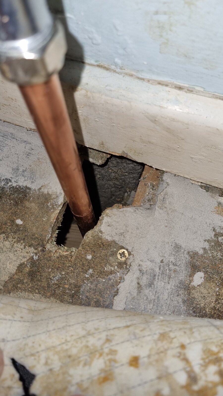

Hello all
I got a Plumber out to sort out the Pipes.
They look so much better without the 'S' Bend:
The issue I have now is, how do I fill the Holes in the Chipboard Flooring?
The Flooring is not able to be lifted, I tried, it is a very snug fit.
I have thought about affixing something to the underside of the Flooring to provide a Base then just use Wood Filler but what and how?
Any suggestions?
Thanks in advance
