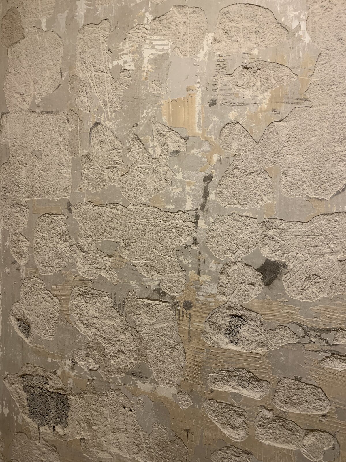

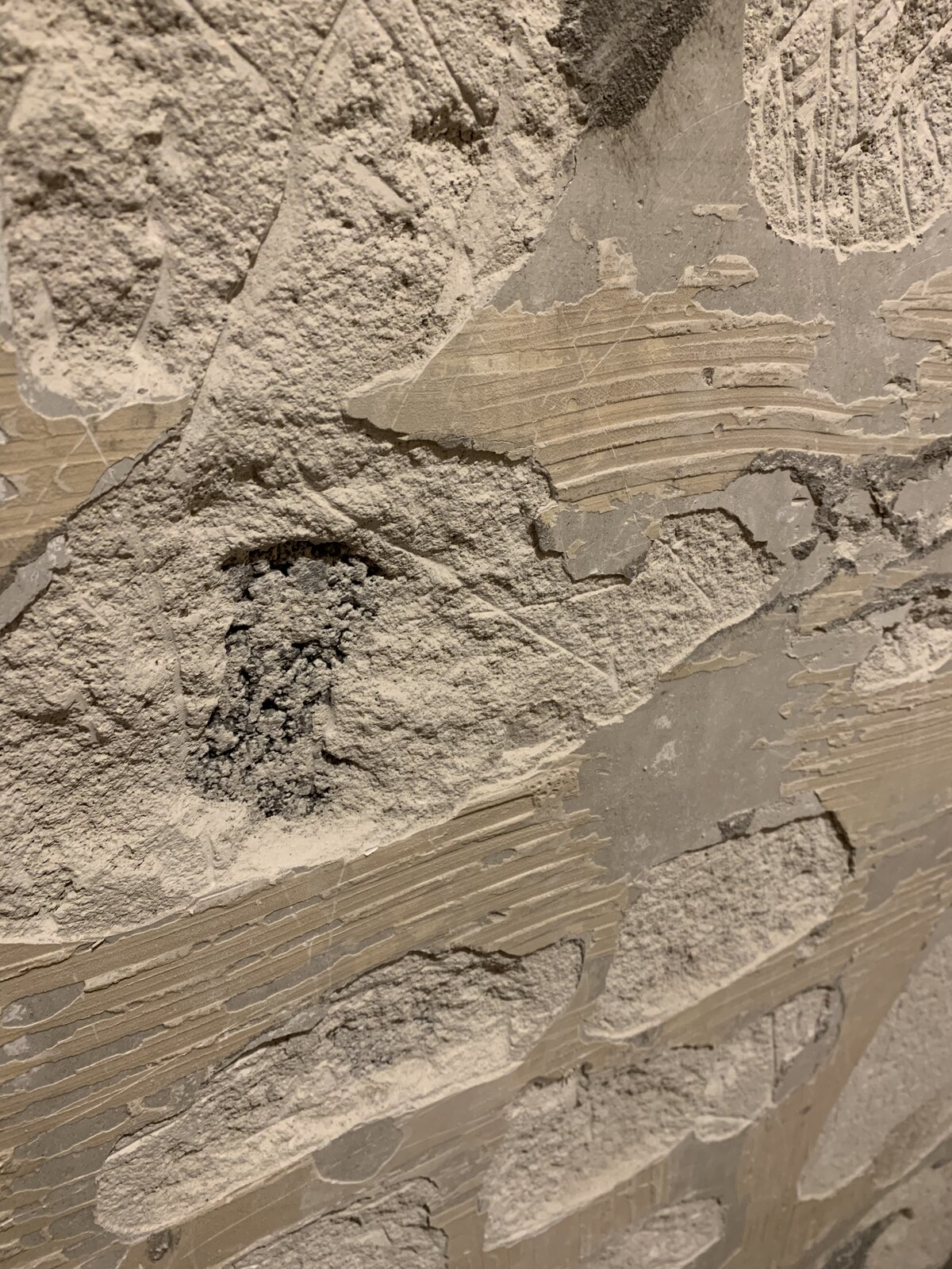

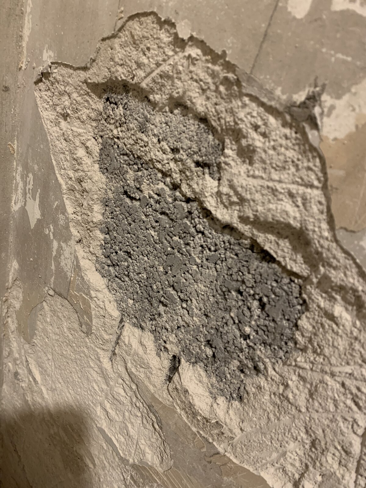

Hi All
Recently removed tiles in my wc which has damaged the walls. Home was bullt in the 70’s and looks like be a plaster type material put straight onto the brick. I was planning to retile the walls although unsure whether this can be repaired or if I need it right back to the brick first?
Cheers
Stewart

It looks pretty solid and will be a lot of work going back to brick. I'd either patch it or put backer board over it.
Elements boards over or seal well and skim.
No need to go digging at solid surfaces.
When I say solid, some areas can come away if you go digging but that's how buildings are.

If the wall is flat(enough) and the mortar sound just patch and add tiles direct

As above, but use a suitable sealer before tiling onto that plaster.
I use either bal apd or mapei plaster primer.
The best solution which would make tiling a breeze would be to line the all room with tiling boards (I like aquapanel).
Would also give you the opportunity to add a vapour barrier behind the boards.
However you would lose an inch space in every direction.
If the wall is okay use a sealer like Bal apd or Mapei plaster primer before tiling. An other option is to line the room with Aquapanel which simplifie tiling but reduces the room dimensions by about an inch in all directions. Consider your priorities for the project when choosing between these options.
