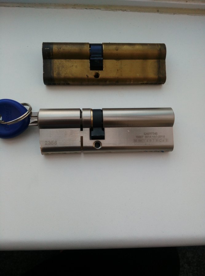

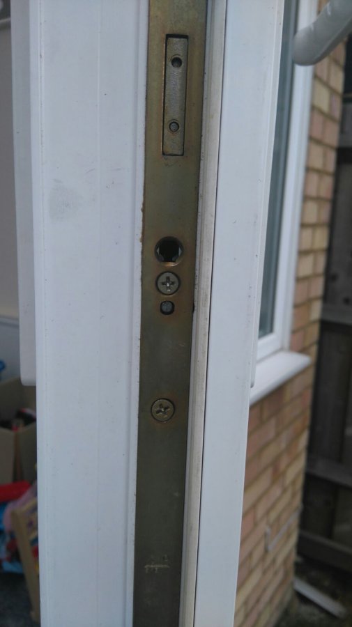

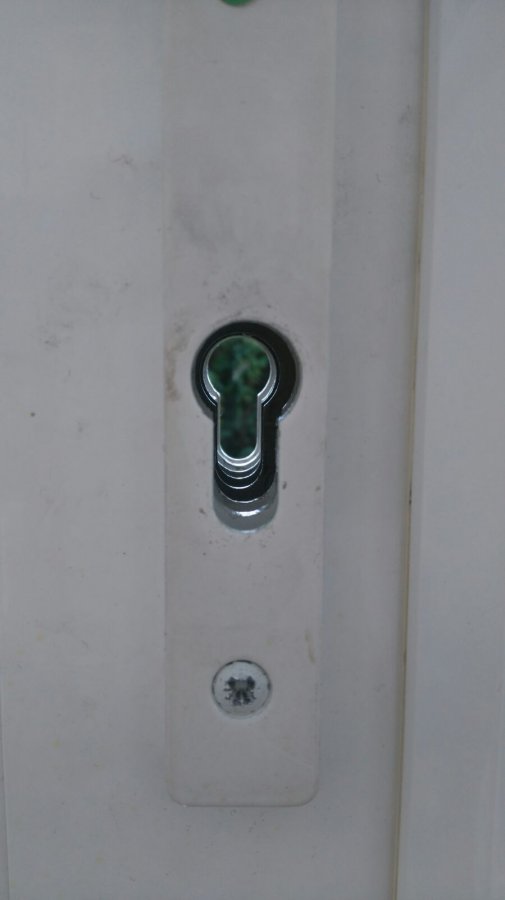

New and old are perfectly the same size.Tried reinserting the old one, that is also not going in and gets stuck at the same point. Added few pics as well.

On some euro locks there is a protruding nib on one side of the body of the cylinder and it is there to prevent the snapped cylinder being pulled out allowing entry by unauthorised means.
Yale tend to sell this type of cylinder , so if it is one of theirs then try putting the cylinder in from the other side of the door remembering to turn the key to 1 o' clock to allow the cam to go through the lock.

No protruding nibs..smooth all across just like the old euro lock. Tried from front and back, both the old and the new locks, somewhere it gets stuck and refuses to go further. Visually there is no mis-alignment as seen in the pics. And i dont think there is a grub screw as well since there is no hole.
Is the next step to remove the full vertical mulitpoint lock strip ?
I would say so, it looks like the centre gearbox may be at fault.
If you are unfamiliar with what you are doing then take photos as you go then you can exchange the gearbox like for like.

the new one seems longer. Has the same section of the old?
Can you re-insert the old cylinder?
