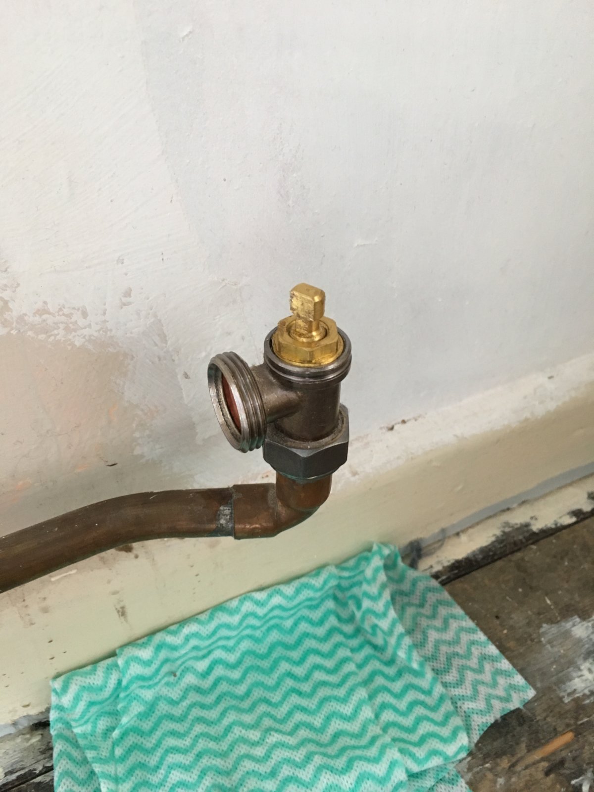

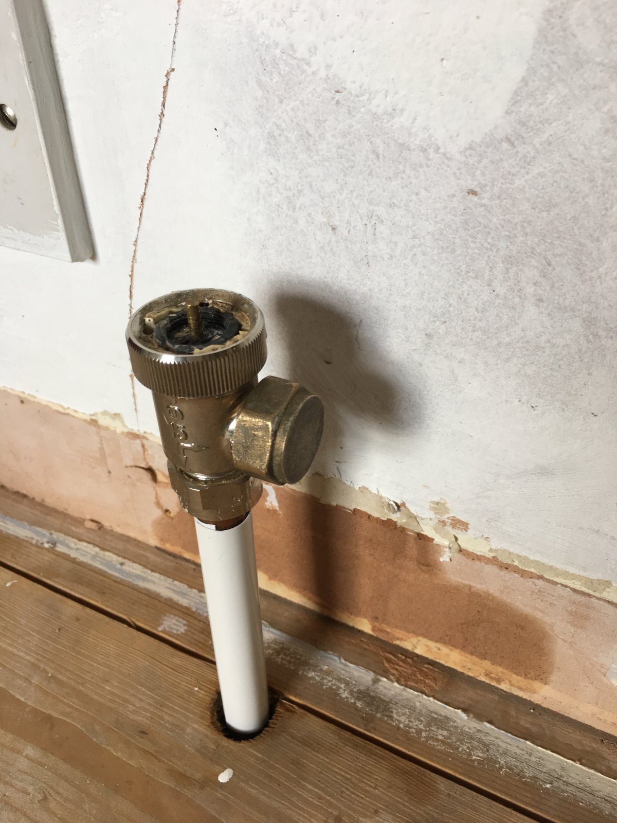

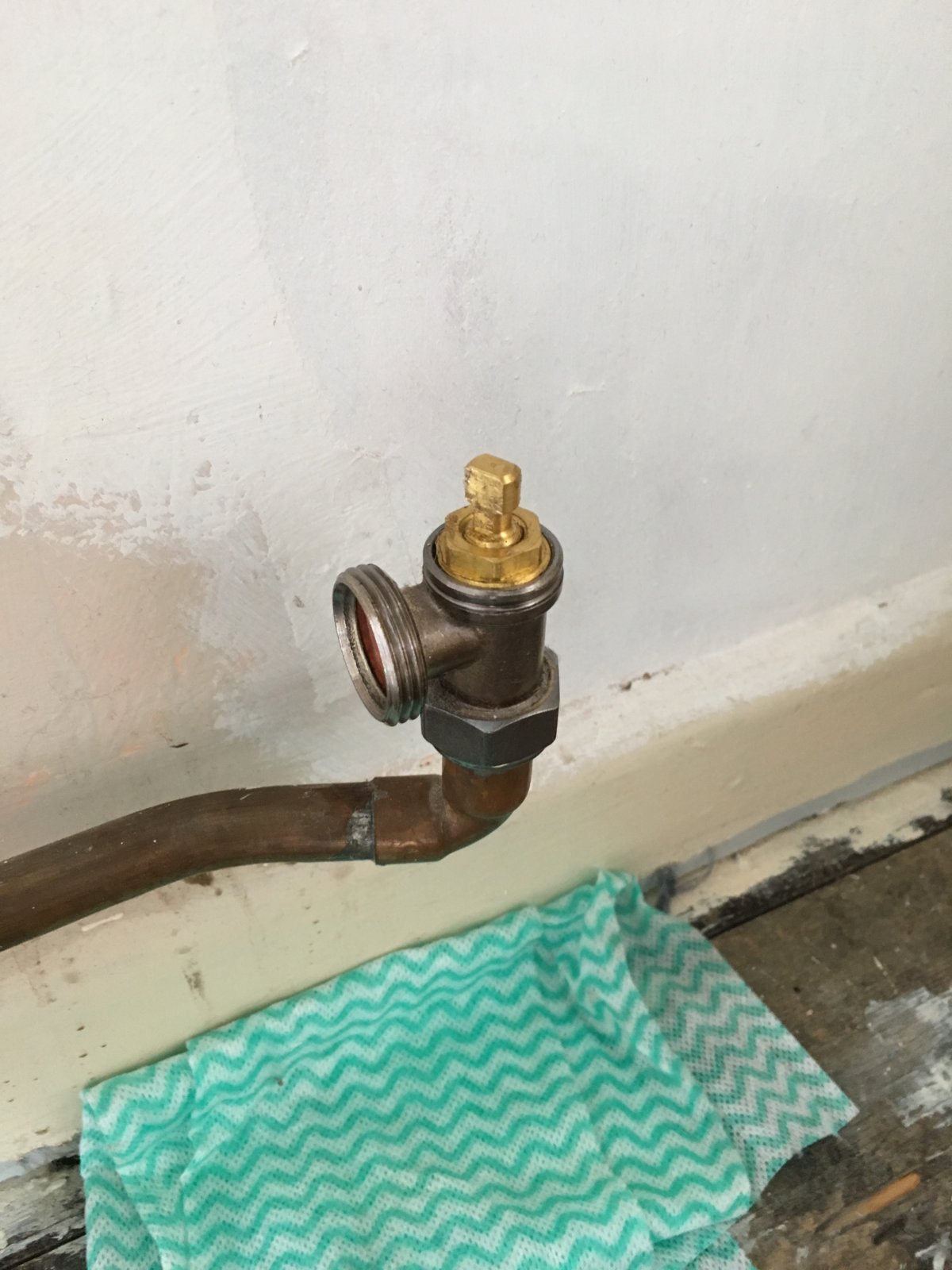

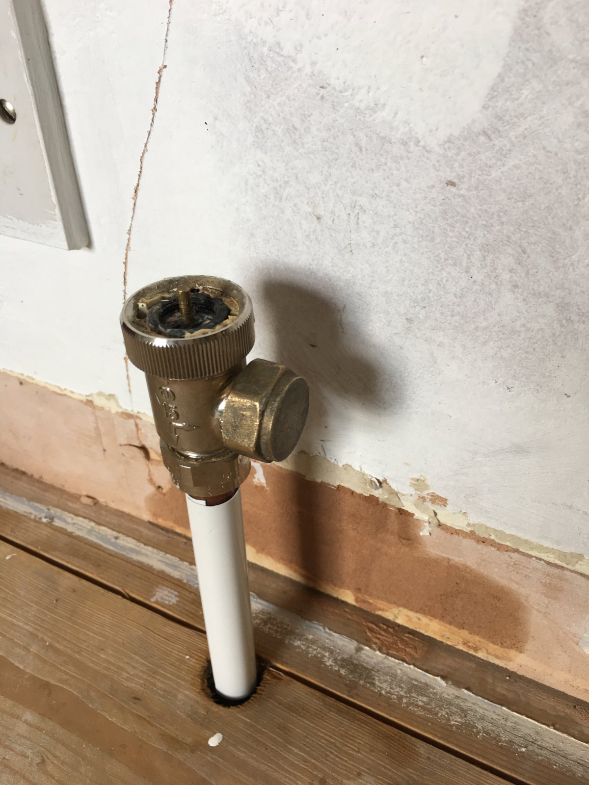

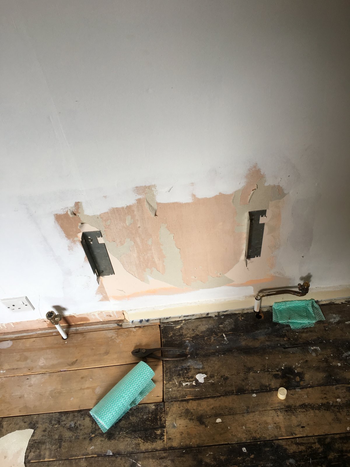

Hi guys,
So the radiator is off (thanks!) and I have a cap for the side where the TRV has broken off but I don't have a cap for the other side because that side needs a bigger one... are these also readily available?

3/4" bsp is also the size of washing machine taps (which often drip when hose taken off) so useful to have
