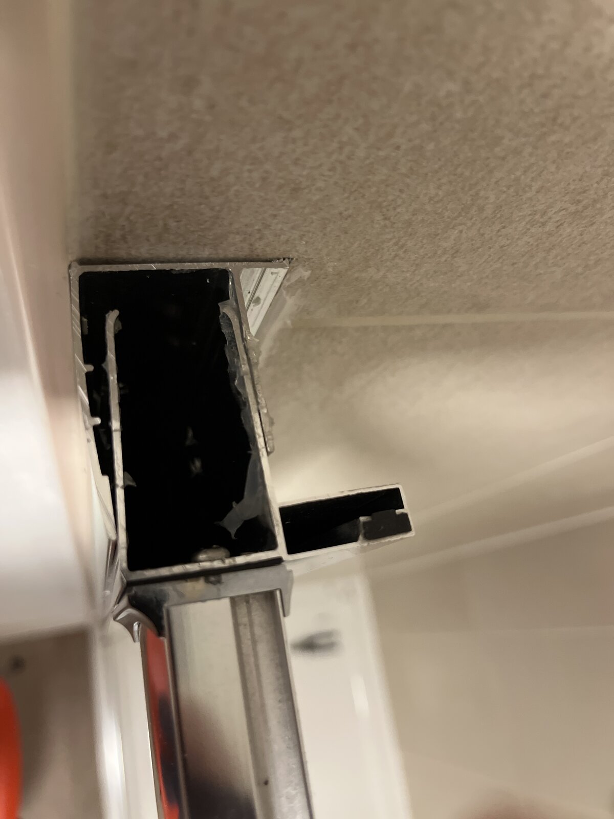

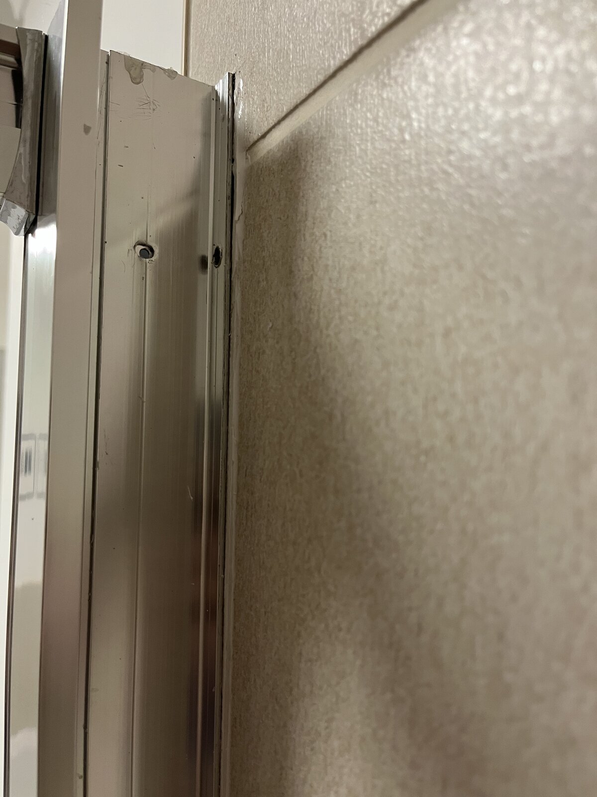

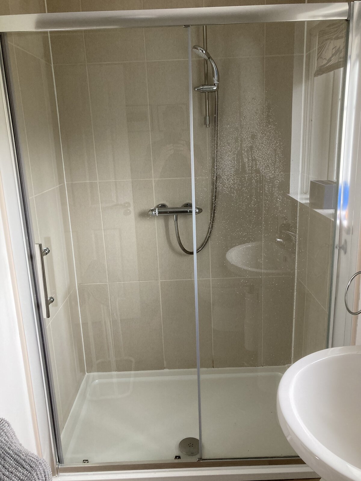

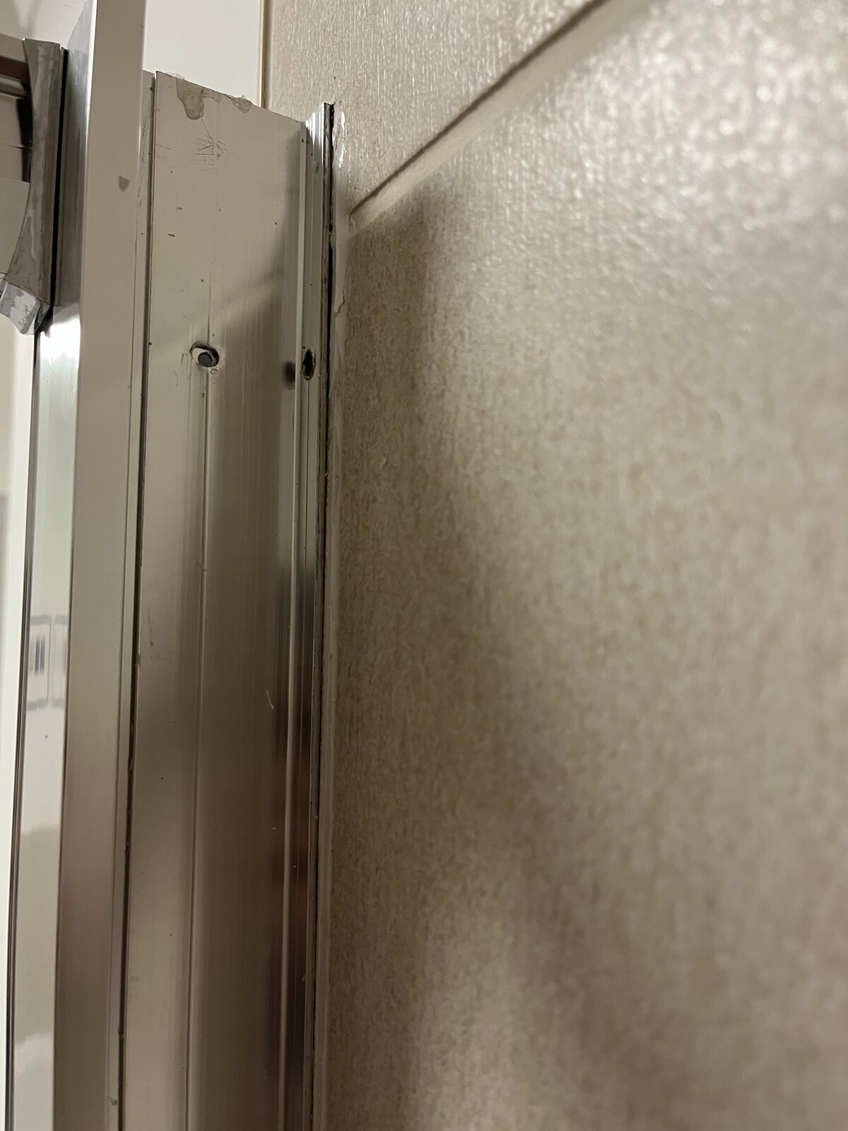

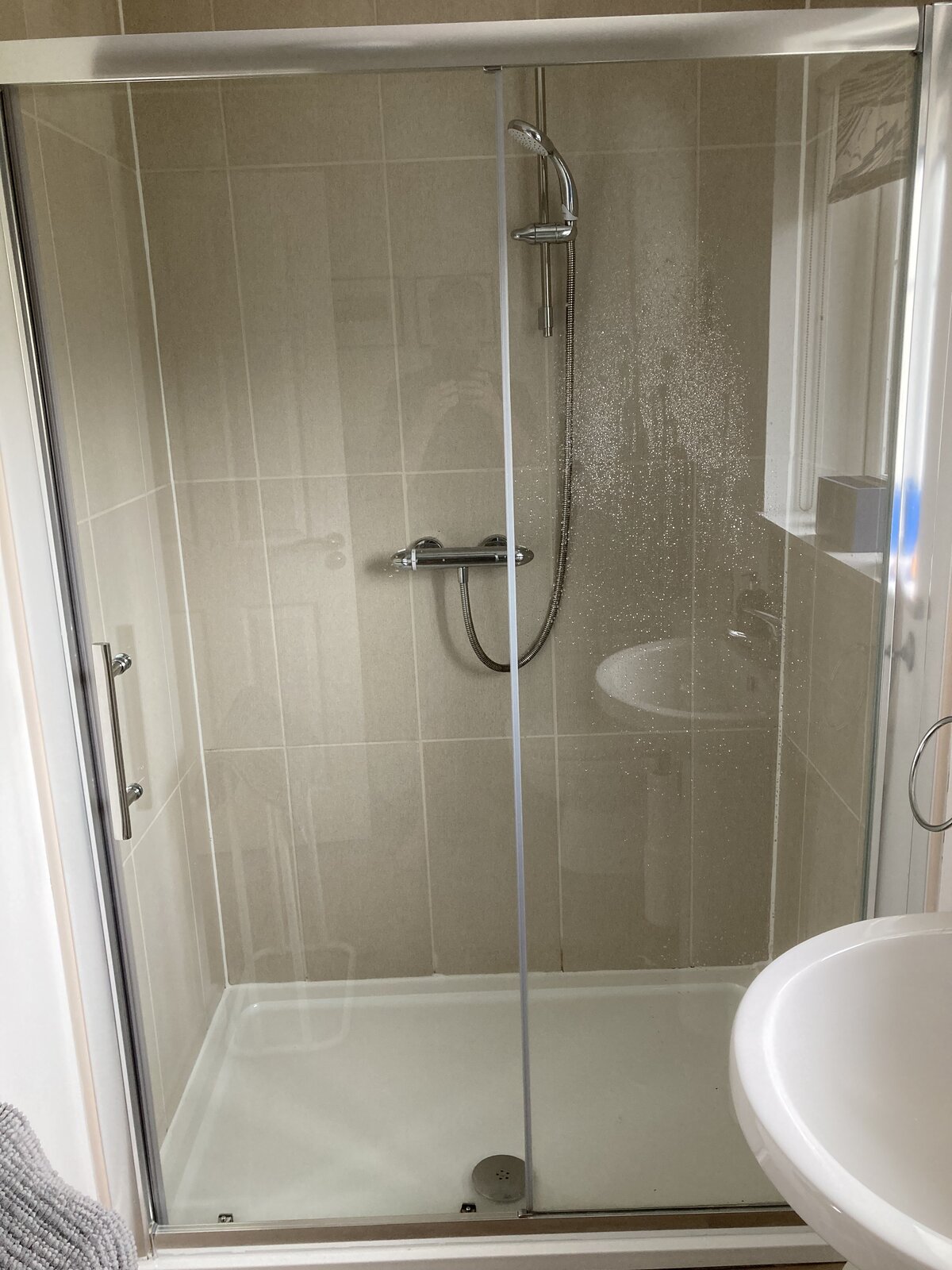

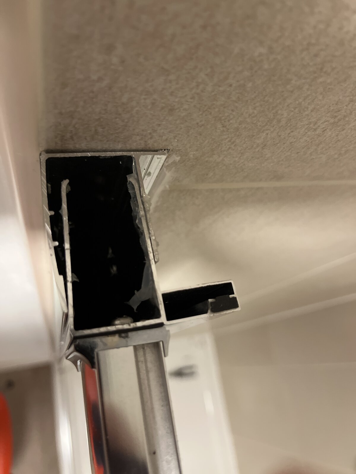

Hi
I am trying to remove a shower enclosure to reseal it. It has two uprights that are slid into two posts that are then secured by screws on the side into the wall. I have removed all of the screws that I can see and a lot of the sealant but it is still not budging- it feels like it is still secured somewhere. I hope the installer hasn’t glued and screwed to the wall. Thanks for any help

If you have removed the screw's that hold the wall channels to the wall ,the only thing that will keep the enclosure and wall channels in place is silicone . Around the periphery ,and possibly between the wall and wall channels.
Thanks very much. Maybe (hopefully) I have just underestimated the power of the silicone along the bottom edge to hold it in place. If it was just the silicone along the bottom would you have expected some movement of the top two thirds of the wall channel? I suspect I mind end up resealing with the frame in-situ but can’t do anything else as I am beyond the point of return now.
I would expect the top of the wall channels to move if the only remaining silicone Was around the tray level,and none vertically
Thanks- that’s what I think as well and am worried that the wall channel has been glued as well as screwed in place but I think it would be difficult to do this
Difficult to do what ?
Are you re sealing because there is a leak ?
Yes - there is a leak and the sealant is old and deteriorating. My reference to difficult was the original installation- glueing and screwing the wall channel which makes me hope that hasn’t been done
You would usually only seal the external edges, vertically and around the periphery of tray and walls. And wouldn't need to remove the frame ,unless there was an issue behind the wall profiles Where they meet the tray ,failed or missing silicone resulting in no seal between tray rim and wall
I am resealing around the tray as well. House was new build and shower enclosure leaked - builders answer was to seal every area - inside and out which worked for a few years but now needs re doing so I thought I would try and do a proper job and start from the beginning again, hence removing the frame. I managed to get a craft knife between the wall channel and tiles - there is silicone or glue holding it in place which I have managed to start cutting through and there is a lot more movement. I was hoping to have the frame off by the end of this weekend but is going to take longer than I thought. Will definitely only reseal on the outside as per convention and manufacturer guidance!
