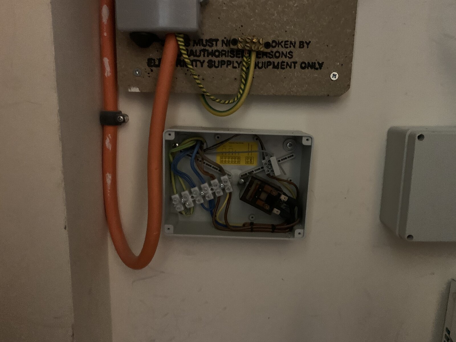

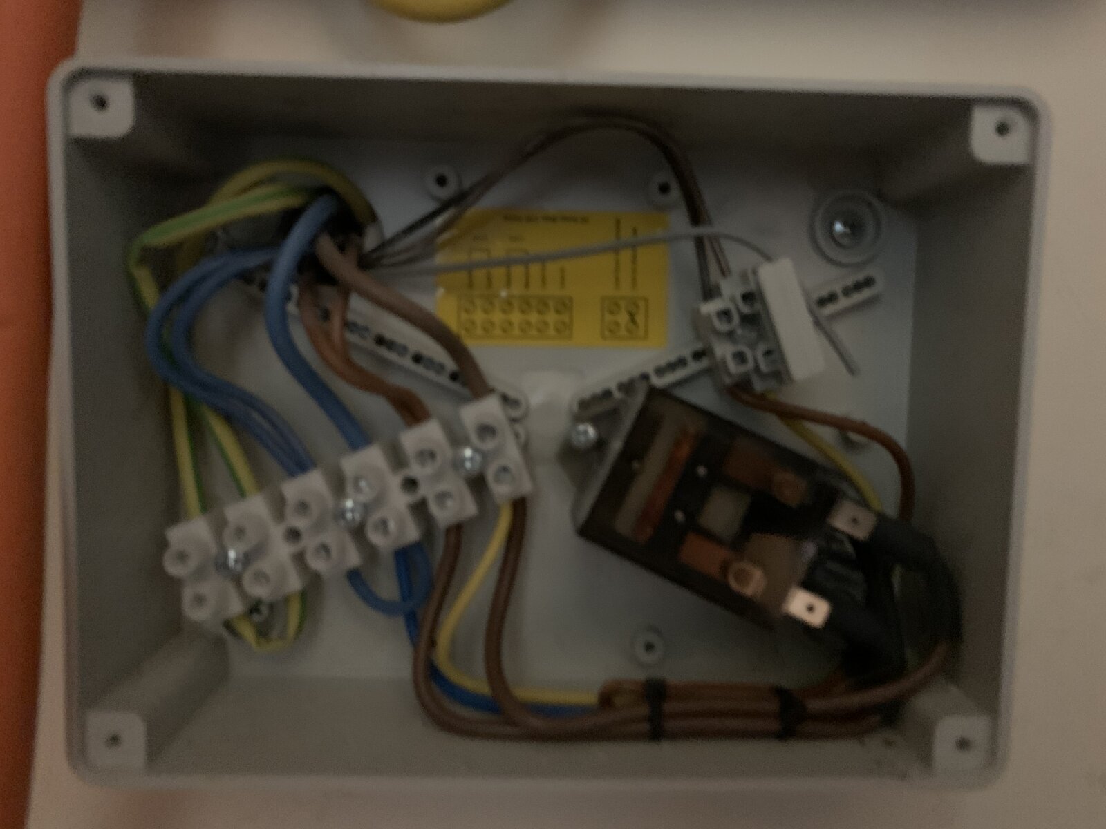

Hey all,
It's my first post, so be nice :)
I am replacing electric heaters in a small flat. Currently all heaters are controlled centrally from a thermostat in the hallway. The new heaters I am getting need direct power to the heaters, as each heater has its own thermostat and can be controlled individually from an app.
That means I need to remove the hardwired thermostat. I've attached some pics for reference. Which wires do I need to disconnect and how do I rewire it to ensure all heaters are getting direct power?
Thanks!

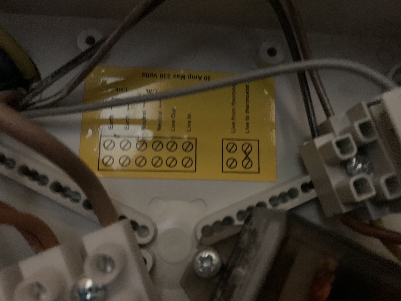

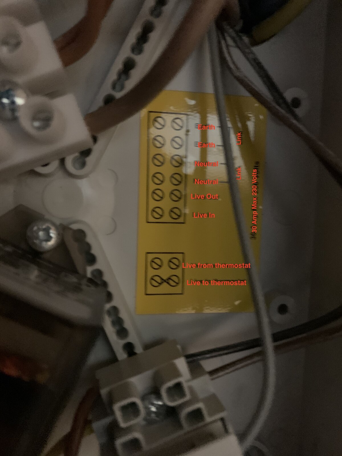

I think a clearer photo of the yellow label is needed, first glance looks like you can remove the relay and link out the two brown terminals
Hey, thanks for responding. Does the attached help?

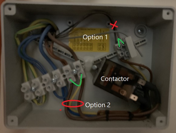

As rocky has said you could remove the contactor and the wires to it ( two Browns one Blue and one Yellow ) and link the end two terminals ( Option 2 )
Or ( Option 1 ) leave the contactor in service and link the terminals that the thermostat leads connect to. This would mean the contactor was permanently energised.
Option 2 is the better option but I would try Option 1 first to check the new heaters work as intended when they have a permanent supply
If they do ( over a few days ) work as intended then use Option 2 and remove the contactor

Hey all, thanks for this. Installed new heaters today and went with option 2 per Bernard’s note above. It worked perfectly. Thanks!
