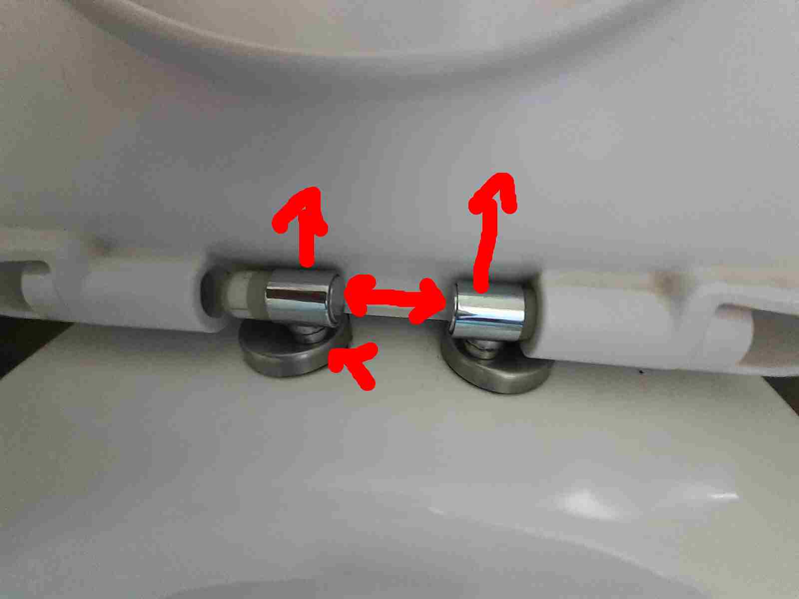

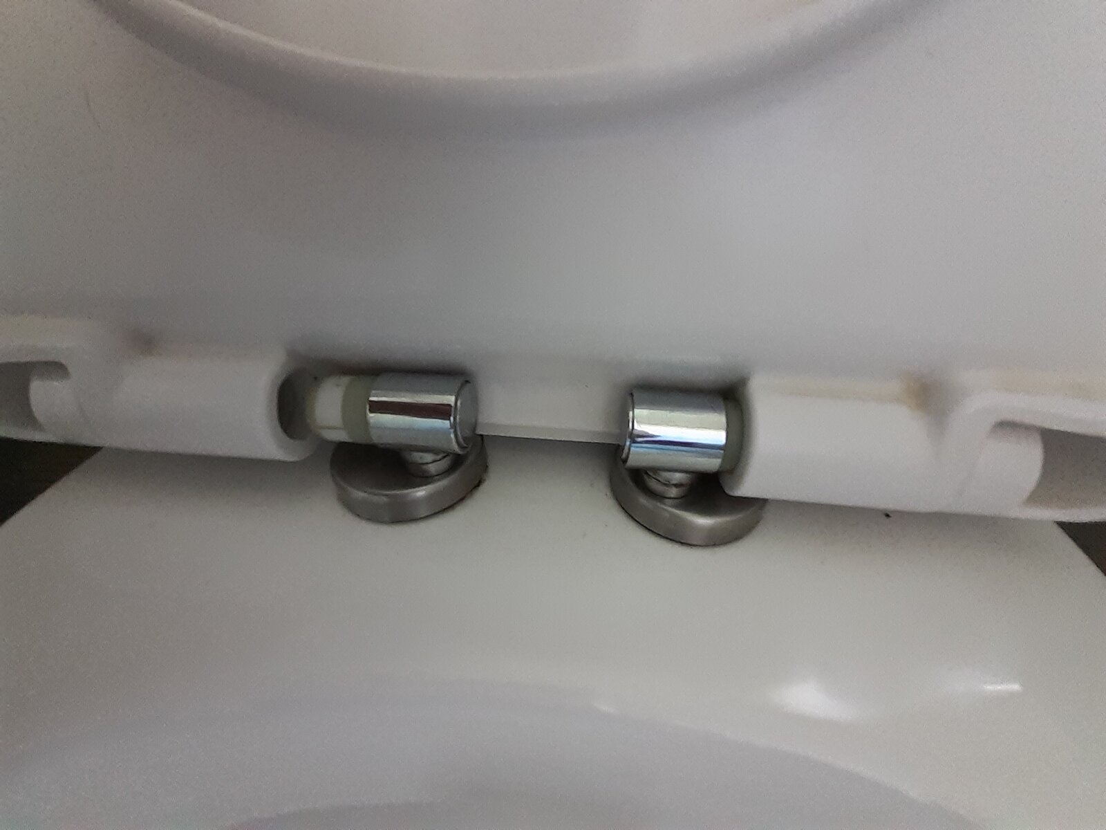

20200822_141708.jpg help..how do I remove this seat. Doesn't seem to be any way to undo it .
Push the buttons at the end of the hinges. The seat should lift off. Then prise off the stainless caps to reveal a screw underneath if you want to remove the bits attached to the pan.
Hi...there are no buttons just a cap. Took them off but still no movement ??
Try pressing both silver discs simultaneously. The left hand side looks as though it's already unlatched ?
Should come off easily.
Are you fitting a new seat ?
push the 2 buttons on the side and then pull upwards - the seat will come off
next look on the chrome caps - should see a small hole , you can you put a screwdriver or other tool and the cap will pull off
then you have screws to do up
